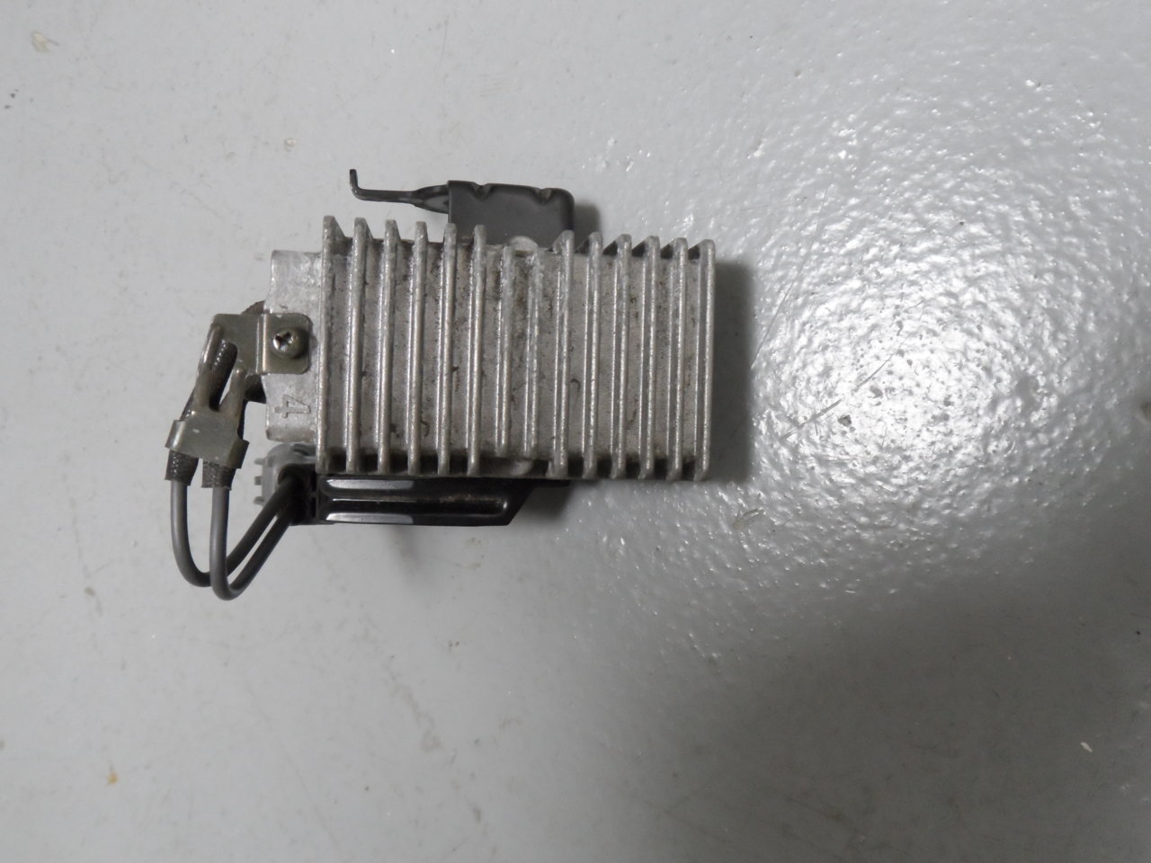

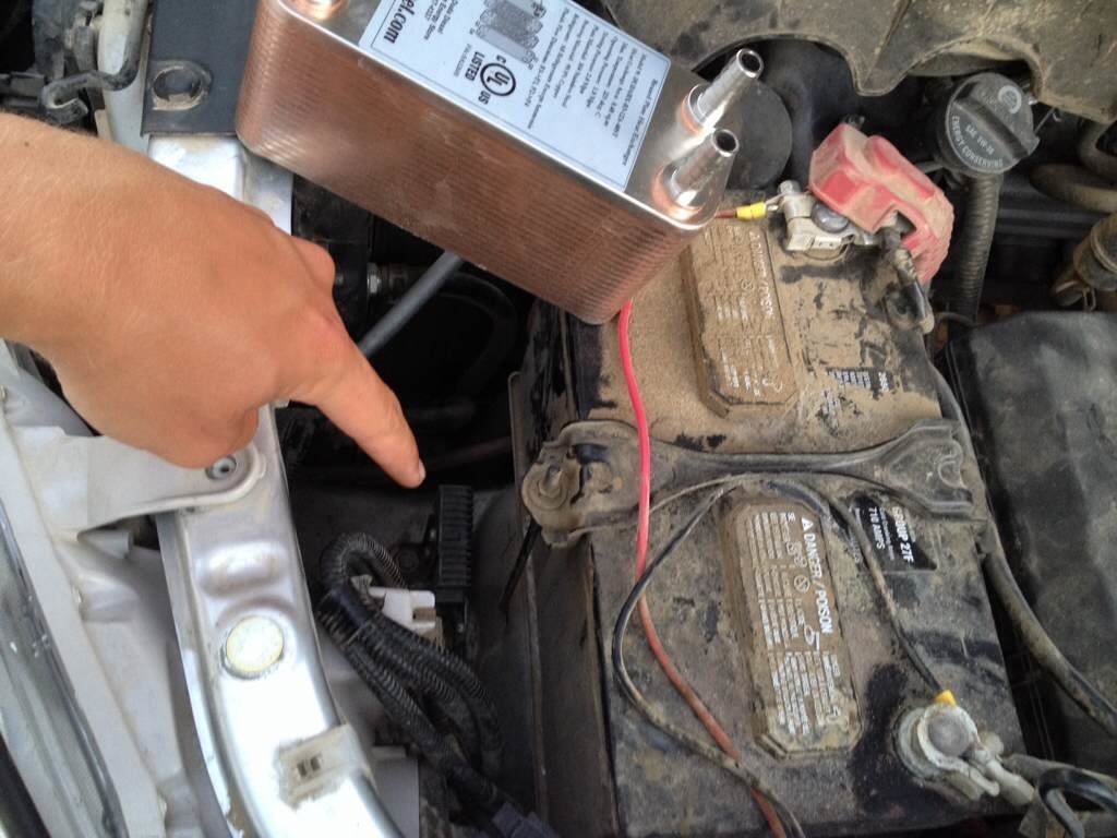

    It’s probably not the fuel pump resistor since you have the codes.
    But a bad or unplugged resistor will do what you describe.
    The resistor is bypassed on start up, and then shortly after starting like 2 second, it switches back through the resistor.
    Again, I doubt that’s is the problem since you have codes.
    Those codes are for ignition conformation. Your truck isn’t report ignition has occurred. And that is probably what is causing the engine to shut off.
    It is located in front of the battery.
    Looks like this
