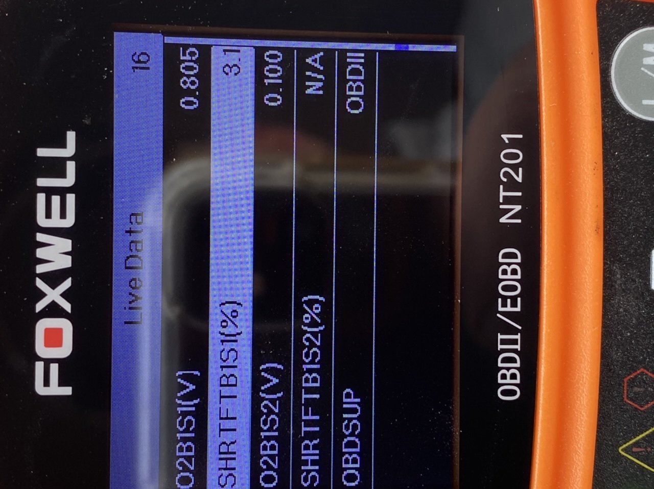

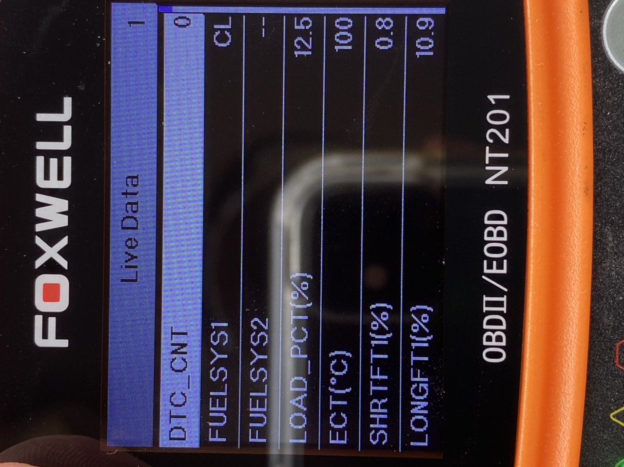

    Double pic above….however…the above screen shots were taken within a minute or so if the truck being started after a true cold start waiting overnight. No issue. Fired right up. Idled high then settles down just like I expected. Drove it 20 miles and let it idle while I shopped in a store

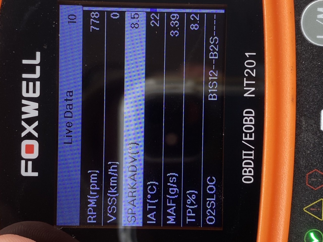

    The above data was collected after full operating temp and driven 20 miles while idling in a parking lot

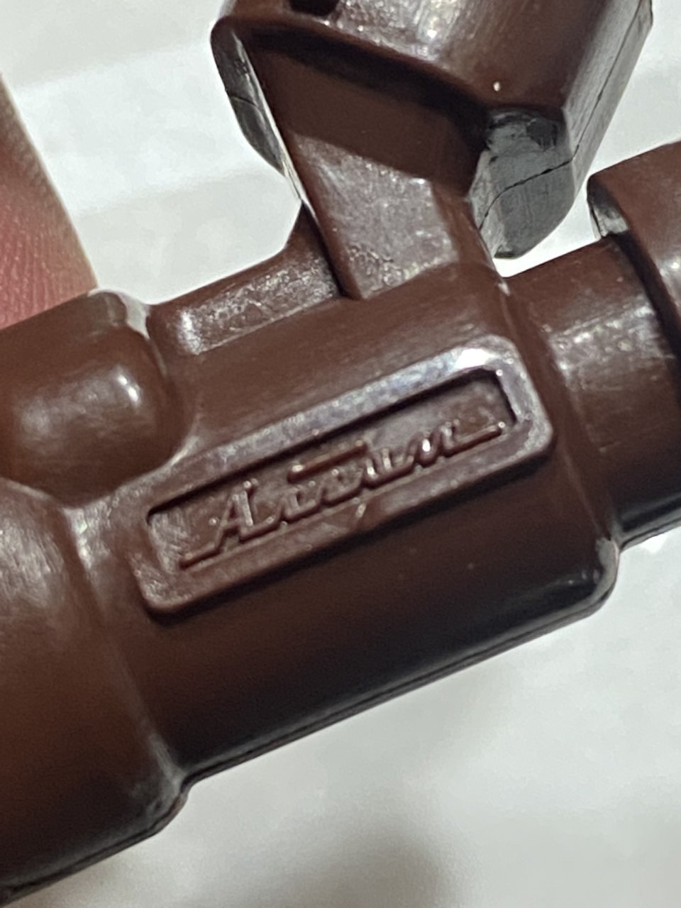

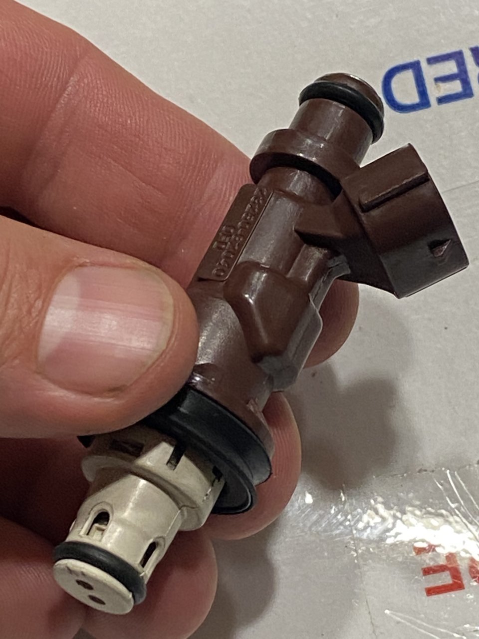

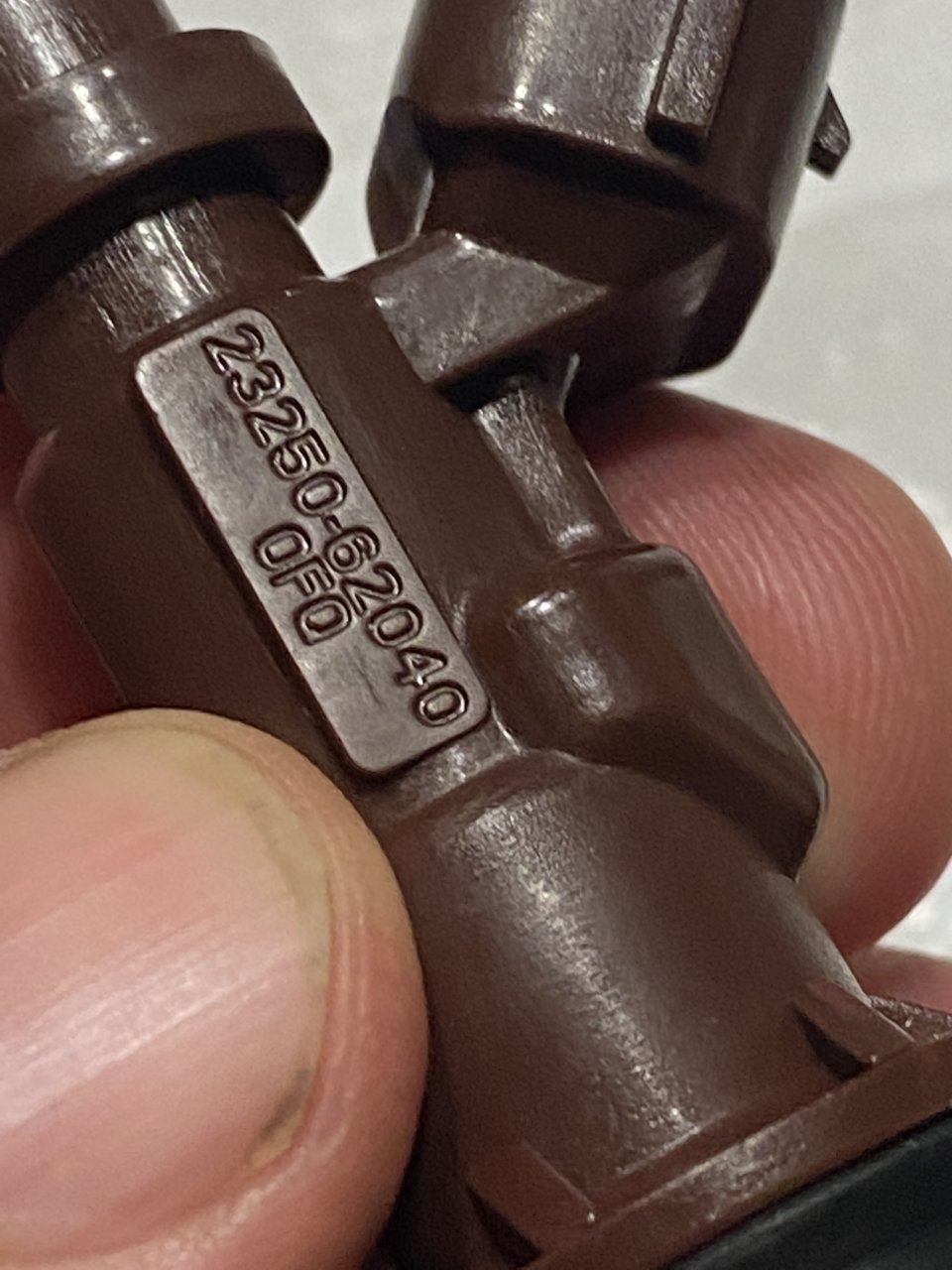

    I have kinda tapped out. Meaning....I read through many pages of some chick that was having similar issues on here a few years ago. Somewhere around page 143 a member was gonna pull working injectors from his 4Runner and mail them to be swapped to test the theory. It worked.
    So I ordered a set of OEM injectors off the interwebs and I will have to pay for someone to install them. I am too swamped to attempt and live very rural. If I botch something or am left with extra parts....it's a flat bed tow a long way to somewhere. Should be here today and hopefully can get someone to install them early next week.
    I've received a ton of suggestions and support. Realizing this is difficult to diagnose over the Net.

    Where did you order the injectors from? I only ask because there are a lot of fakes on the internet, particularly eBay & Amazon. See some of @CS_AR posts
    https://www.tacomaworld.com/threads/thoughts-on-denso-fuel-injectors.651608/#post-22661570
    https://www.tacomaworld.com/threads/thoughts-on-denso-fuel-injectors.651608/#post-22664120
    make sure the injectors you get have the testing lot number inscribed on them

    Off eBay....they probably do NOT. F Me.....

    there are legit sellers on eBay. I've ordered off there before and been OK. Just double check them closely when they arrive. Make sure the seller isn't based out of China or something, if they are then I would probably cancel it

    based in the US, has great reviews (no negatives)...but then again I'm not that familiar with ebay's review system or how easy it might be to hide negative reviews. 6 OEM injectors for $260 is pretty damn cheap though so that's one concern.
    I wouldn't cancel it but I would just make sure to check them closely when they arrive.

    91096D3E-2A20-4B2A-AF96-A05CDFBDF999.jpg 22E0B89F-69F7-4A22-9DFA-4D4BD190C03A.jpg 2951F91B-A67E-4A92-945E-25956DB33995.jpg Did I get smoked?

    @CS_AR what's your take on these?
