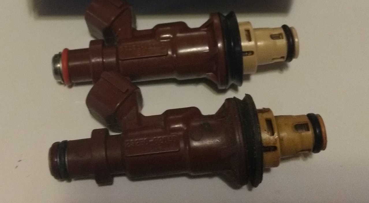

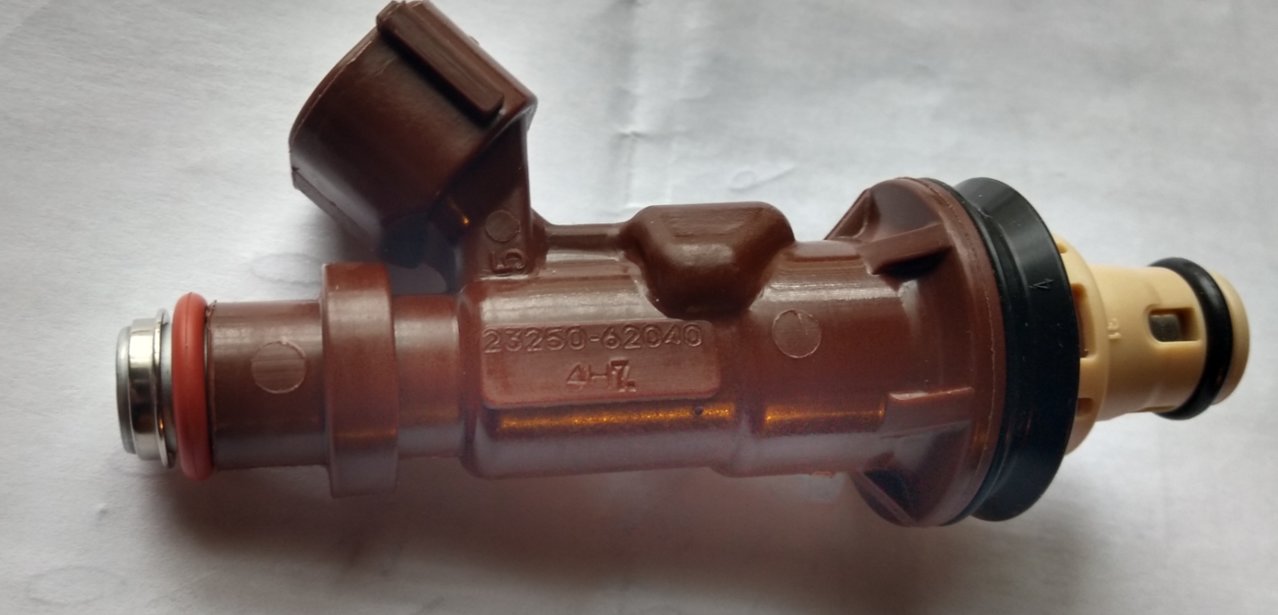

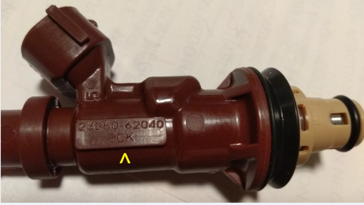

    Looks like the work of a master counterfeiter. The lot code looks like it was molded in at the time of injection molding. It should be inscribed on the body under the part number after testing.
    THE REAL QUESTION IS WILL THE PENTILE CAPS MELT? IT HAPPENED TO ME.
    In this example, the part number and code are in different fonts, and apparently, the three-character verification code was added after some sort of testing.
    I've been running these for a few years now.
    If the code is too perfect and the font matches the part number, it looks like it was stamped by a machine during injection molding.
    These are genuine injectors.

    yeah you're right, that inspector code on the ones he got looks like it was added at the same time as the part numbers. Definitely a red flag
    such a shame that there are so many counterfeits floating around with truck parts these days, enough to make one swear off eBay/Amazon all together for parts. Even OEM/Toyota timing belt kits are a big counterfeit thing on those sites now.

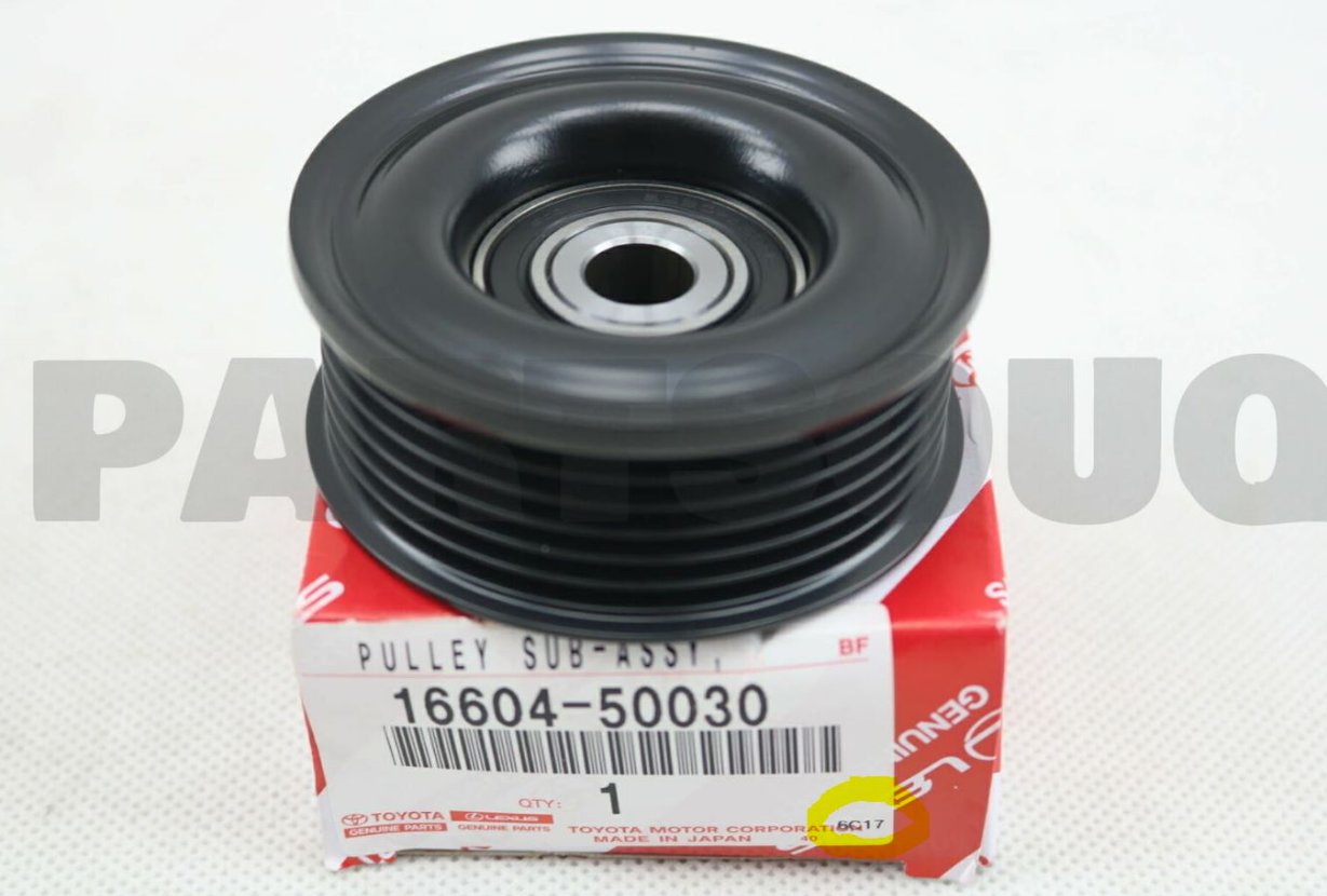

    One thing that I've noticed after buying a pickup truck load of OEM parts, is to look for the inconsistency in the lot code stampings. They are added after the fact by humans. So they will NOT be perfect. The code 5C17 was partially stamped over the label print in the lower right-hand corner which indicates a genuine part to me.
    If the verification codes are too perfect or missing, then I usually suspect a counterfeit.
