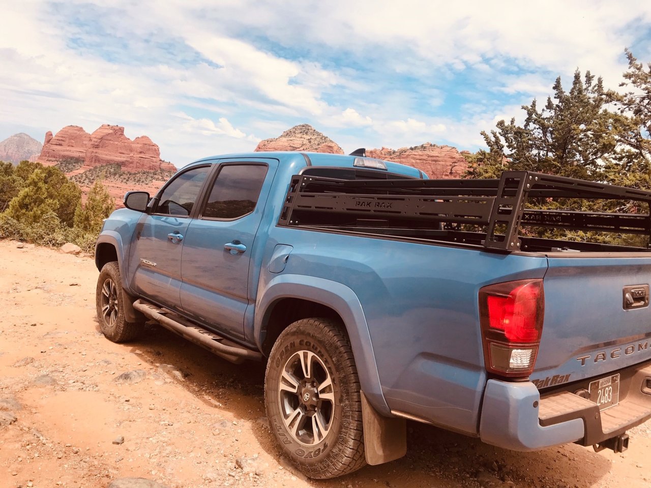

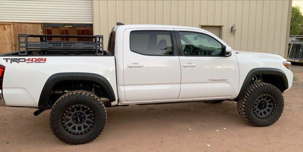

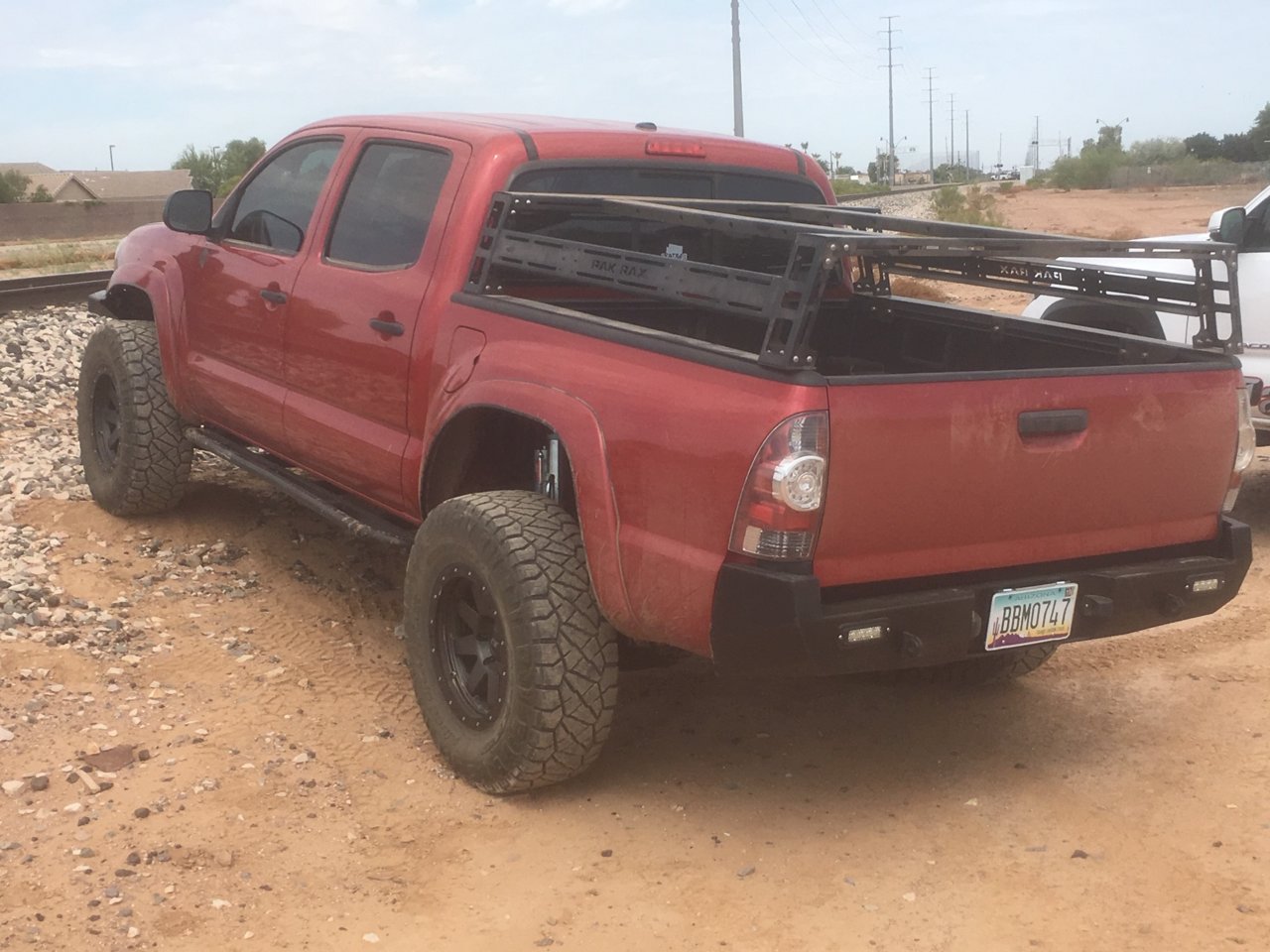

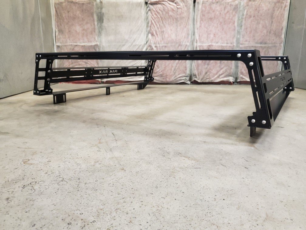

    I've had a handful of folks asking if we got the bed rack done yet, what are my thoughts and to post up pics..... Well after field testing a few prototypes/models for PAKRAX- I can verify that a 100% steel made bed rack makes a huge difference when bombing through the desert and rocky trails with gear/RTT. I've done the bed bars, have had another rack, I've ruined alu load bars in the past, so working with PAKRAX and getting the product launched on our website has been a great experience. 2- Tacoma models to choose from (PAKRAX guarantees no lead times and these bed racks are ready to ship and come powder coated). Pics below just showing the rack off. I will be posting up a deals & coupons code for anyone interested in this. (cab height version and PAK accessories coming soon-their website is under construction-please be patient)
    Read more: PAKRAX TACOMA PAKRAX TACOMA PAKRAX "JR"

    Very nice! I will share with my peeps!
