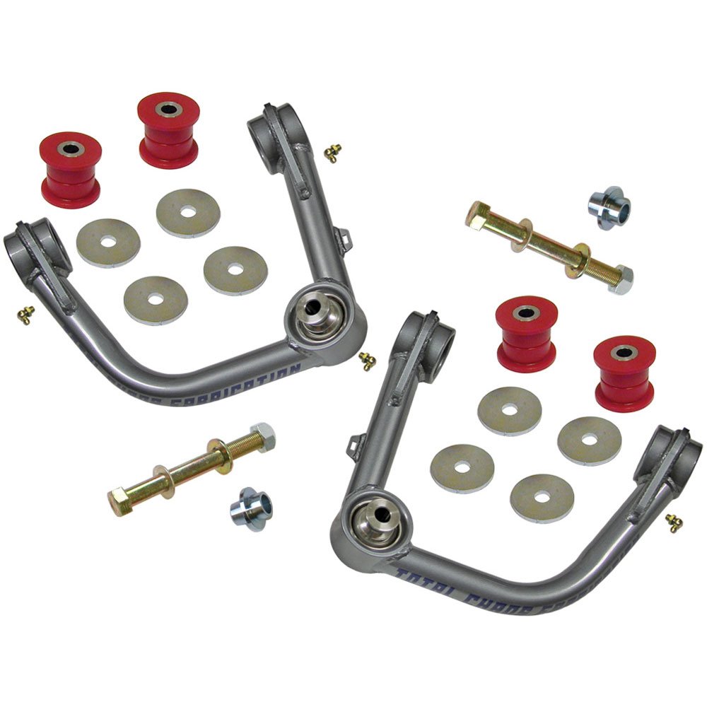

    I got these UCA from E bay they are wrong and they dont want to give me my money back. what do you all think

    The offset is to add caster after a lift.

    I put them on they hit the springs and I got no alignment all settings were pegged over no caster at all.

    The offset is to add more caster after the front end is lifted. However that doesn't guarantee that it'll be align-able. Only way to know is to install them set your ride height and have it aligned.
    Personally I wouldn't trust knockoff Chinese eBay suspension components for any hard offroading, depending on the circumstances a failed UCA could lead to hundreds or thousands of dollars of damage to adjacent components.

    I was wondering should they be longer

    If they are hitting the spring on your CO, probably.

    The tubing on the Total Chaos ones looks like a smaller OD and slightly longer. Might be the difference that's causing the interference.
