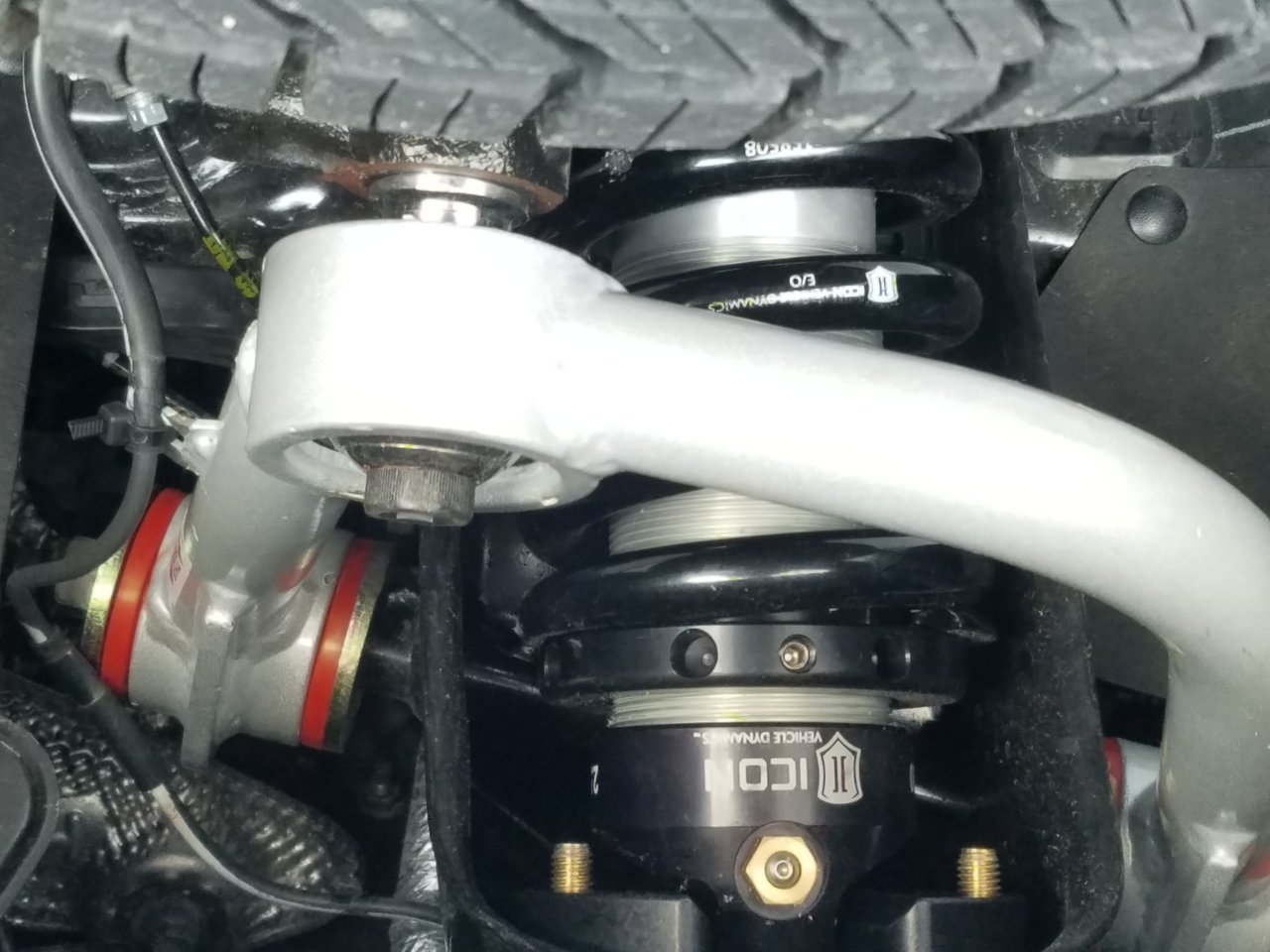

do you see whats wrong with this
  1. should be longer
    93.8%
  2. should be offset more
    6.3%
Multiple votes are allowed.

    Yes.

    passenger side I don't know why It is upside down

    After flipping my screen over, I don't see any interference. How much are you cranking up the coils?

    When I cranked down the coils they hit the springs

    I used the spanner wrench I have 1 3/8 thread showing

    are you sure the uca's hit the coils? what size tire and are you running a cab mount chop?

    Far less than over cranked

    Hope this shows for others.

    stock tires cant be Aligned way out of spec cams maxed out no caster

    dont know what you think is wrong but that looks normal....aftermarket ones are designed for specific casters
    your lack of good pictures/alignments for us to determine why they are wrong wont let us diagnose anything

    You're running ? Are you running a winch or bumper?

    they hit before and after going the the shop the guy at the shop got all worked up. said that the arms are the wrong ones to get the wheels straight he had to move the lower cams all the way in and the tie rods are all the way in, messed up.

    we had no caster at all

    sorry for the shitty photo, but there looks like more clearance between my spring and the UCA than in your photo OP. I’d say they’re too short.

    Who did the alignment

    ^ This, if the guy has no experience with these types of alignments of course he's gonna 'get worked up' and say he can't do it.

    when the Icon U C A come in i will give you an update on the difference.
