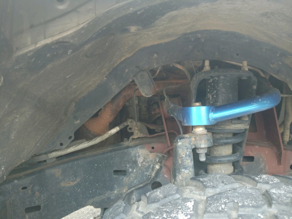

do you see whats wrong with this
  1. should be longer
    93.8%
  2. should be offset more
    6.3%
Multiple votes are allowed.

    Yes

    OOOOOOOOOOOOOOOOH :facepalm:

    If you already took them off,and ordered icons,and already requested a refund,then you are set.

    Those are correct
    I'm still running mine and beating the shit out of them haha

    they are showing the wrong spindle in that pic hahah

    For what it’s worth, these are exact replicas of the All Pro UCA.

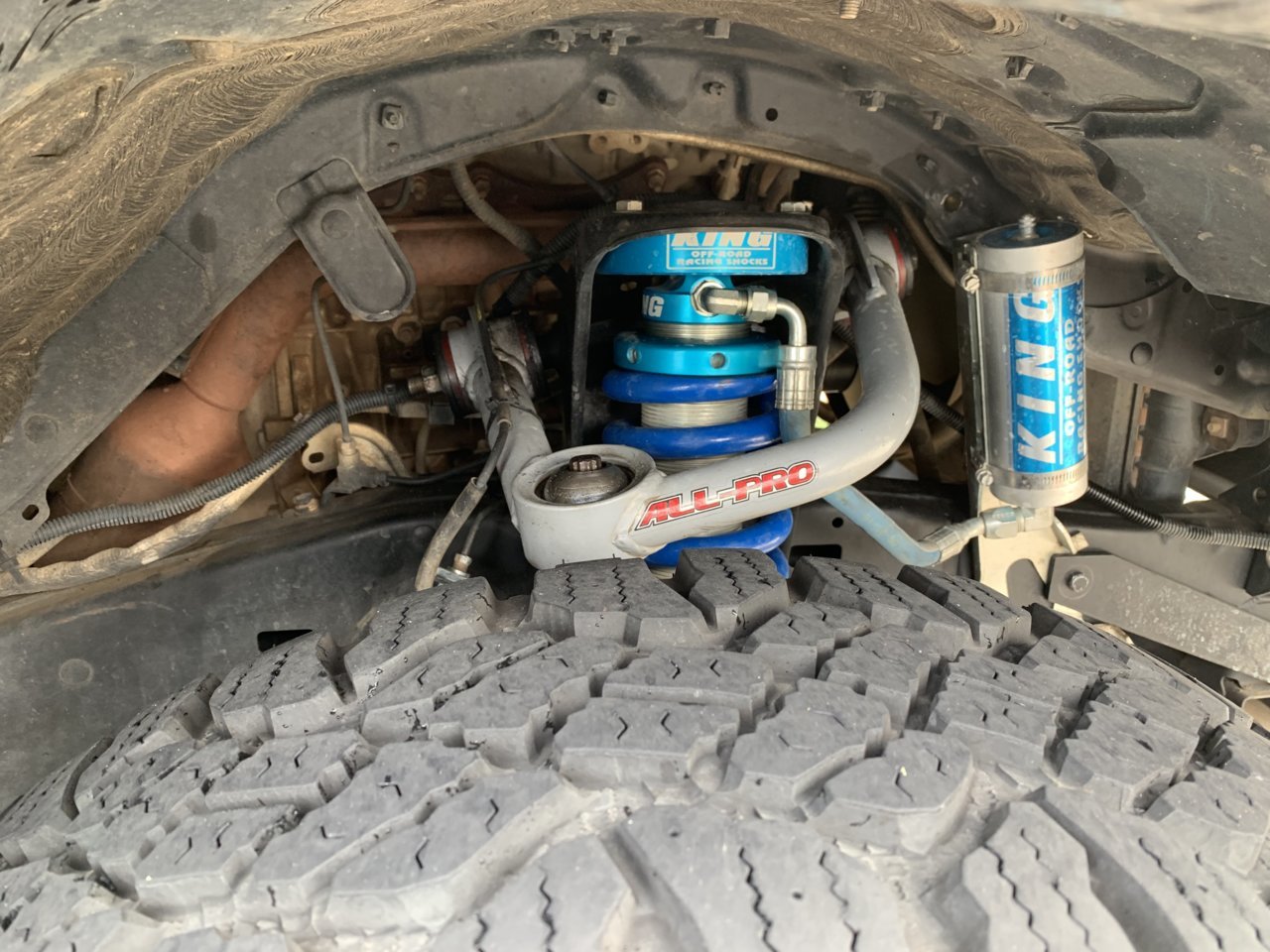

    The AP uses the only 1.25” unibal upper which needs a larger cup to rest in. This cup can make spring contact easier. Personally, I have made made contact with mine but only as max droop adjusting the coil over collar. A little less jack and pressure on the tires pulls the UCA off the coils rough to spin it passed the contact.
    Could be wrong part (wrong truck year, looking at spindle/through bolt), uniball/coil contact, or alignment techs suck at alignments.
    My guess is wrong year/wrong part.
    Here’s my AP UCAs for reference. Same color paint and red bushings. Dead giveaway it’s an All Pro knockoff, but looking at the uniball/spindle/bolt/tower/mudguards/wheelwell of the arms stock photo you have, they sold you the wrong year part fraudulently and refuse to refund.

    Yeah 2 gen. I don't think there is any difference between the 2nd gen and 3rd gen upper control arms

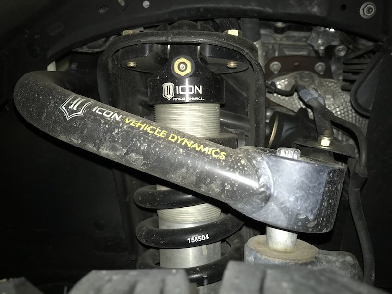

    I think you'll be fine with the Icon UCAs. I have that setup, although you have the beefier springs. After spending all that dough on the coilovers, I'm surprised you tried to save a few pennies on the UCA.
    What are you running in the rear?
    For reference, no banging, no real alignment issue:

    I believe they sent the wrong parts and they will not help at all.the guy is a jerk. If I only lift the truck a 1/2 inch they clear everything, but still hit the springs at full droop. I would think the U C A's should be longer and off to one side to be rite. The arms I received are the same in the length and offset one inch.

    Just to be clear all aftermarket UCA’s hit the spring at full droop, it is very common that you have to rotate the spring so that the uniball cup falls into a gap in the spring.
