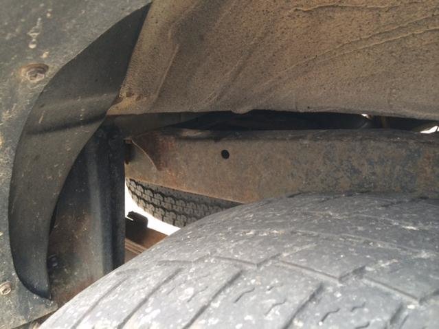

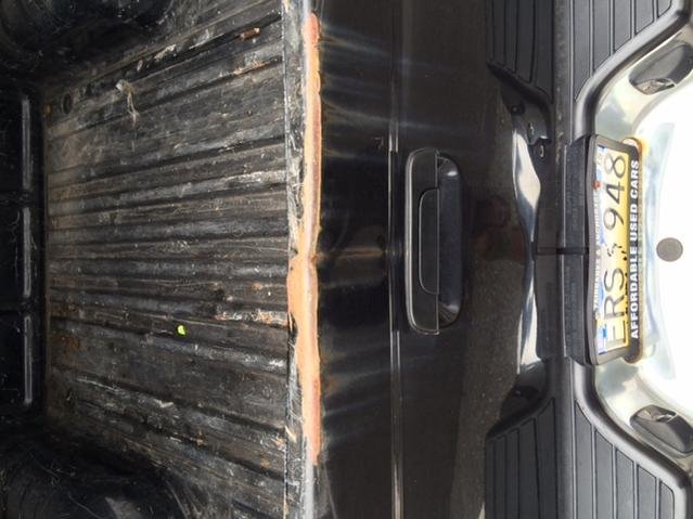

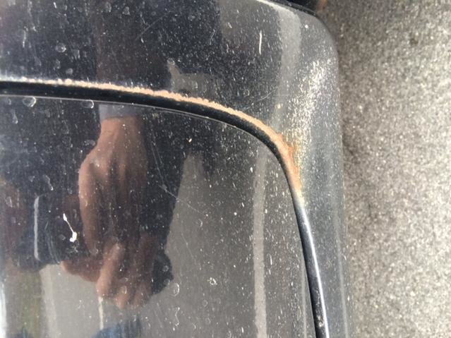

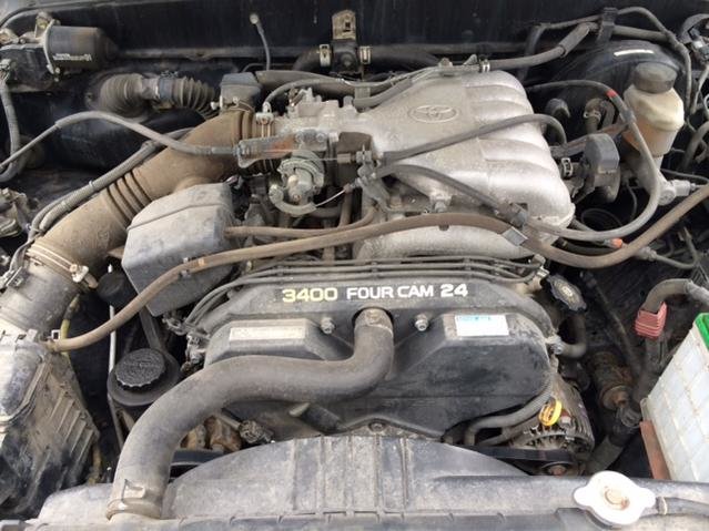

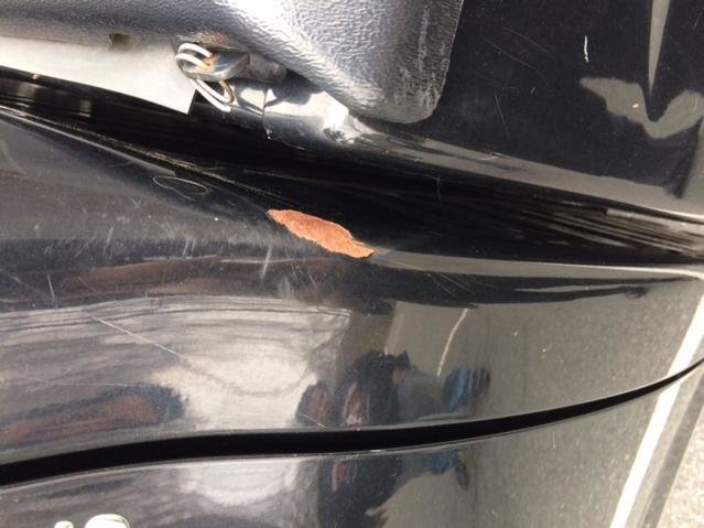

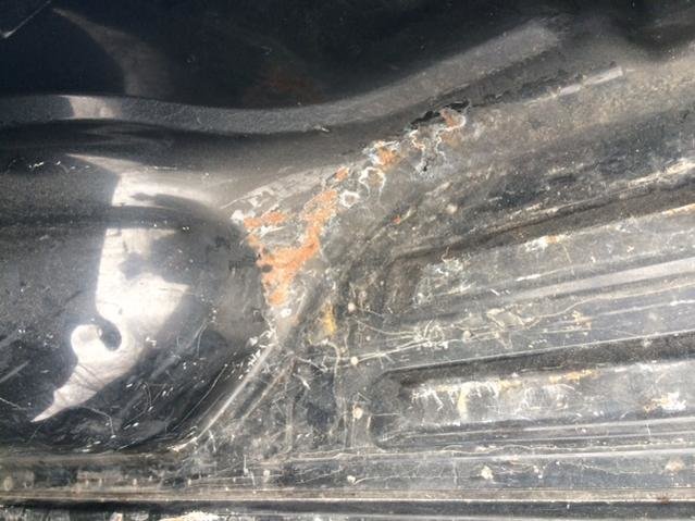

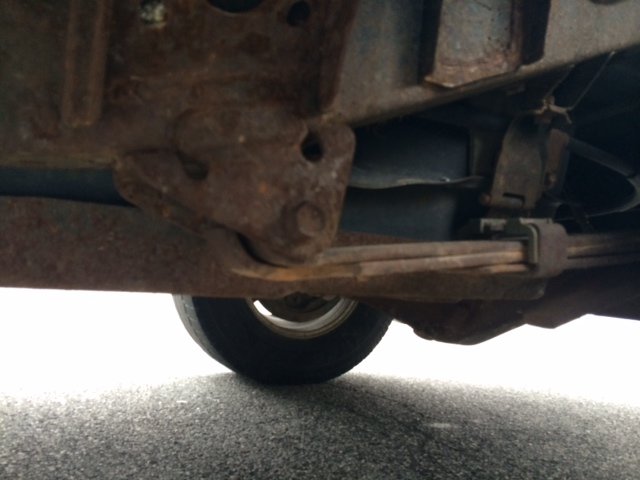

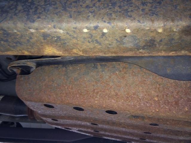

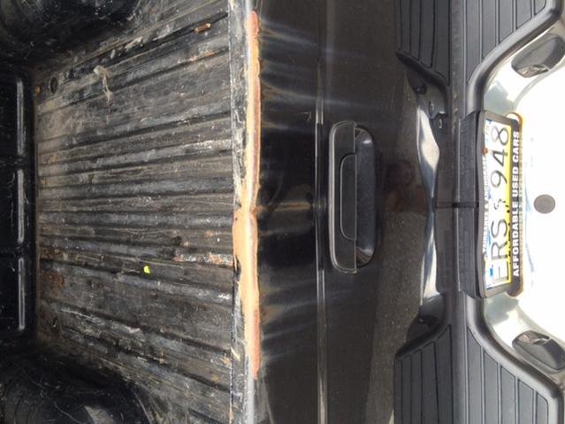

    OK guys - went to go check it out today and it does feel strong. My brother pulled a Car Fax and it mentions an accident in 2001. Once I have more deets, I'll let you know what was in it.
    The truck is from Alaska - 4 owners. Our man is a West Point instructor and not big on not getting his way. $9.5k firm. Very firm, like his handshake.
    Tires have about a year left in them. Interior is not pristine, but I could live it it. Handles well, brakes well, and belts and fluids have been recently changed. He took it in for the 105K mile dealer review, but it invoice does not state a timing belt change. Not sure how worried about that I should be.
    Here are the crappy photos I took.
    Thanks for all the advice!

    That's a lot of rust. I see some rust damage in the bed too. After seeing these pic's, I'd walk.. But I also live in Az where we don't get rust damage much and its easy to find truck with 0 rust.

    We need someone with some experience in the rust belt.. It would be a great deal if it weren't for the rust.

    It looks like it was used as a truck lol. But surface rust is as simple as sanding then repainting, personally I think the frame is in okay-good condition, probably could get sanded down then bedlined. And Idk my wheel wells on the inside of the bed are gone on one side almost lol but it can be fixed.

    Frame looks decent, nothing scary looking.
    Body looks like its been used as a truck (as others have said)
    Bed is rusted through behind the wheelwell. Take a wire wheel to it and that hole will open up more. Mine was the same way. Small hole opened up into a much larger hole as I cleaned the rust away. I cut the bad metal out, welded in a patch then put the drop-in bedliner back in as my welds look like crap.
    If you're looking to lift it and go play in the rocks, its not bad. However, if it'll be your DD, I'd keep looking.

    Not to knock your idea or anything just suggesting that you don't use a drop-in if it rains it gets under the plastic gets trapped and speeds up the rust process or so I'm told. But a spray in bedliner like Line-X would be amazing to prevent rust!

    I painted everything before putting the liner back in so it shouldn't rust too bad. Eventually, I'll get around to cleaning up my welds and doing some form of spray liner.

    after seeing the new pics IMo even 9.5k is a little high. I concur that the frame rust is minimal, but the body rust is a sucky thing to have to deal w/ and you're gonna want your DD to look sharp.
    also the timing belt is a big deal, not debilitating to the engine if it fails (non interference motor) but a costly maintenance item that should have been done at 90k.
    If he can prove the belt/pump have been done I'd bite at maybe 9k
