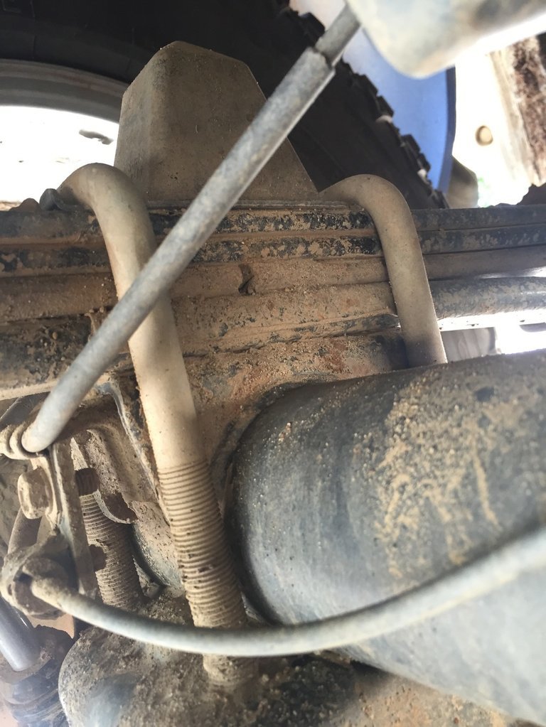

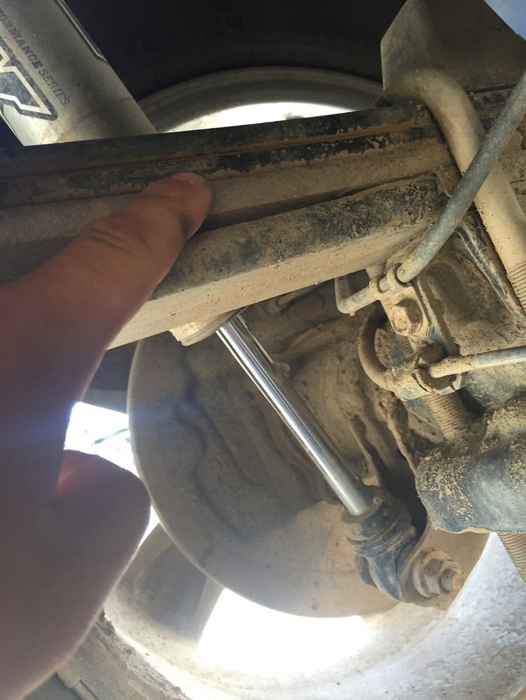

    So I went to the dealership this morning. I had an appointment set up for 2 weeks now. I called and made sure my leafs were under recall, they were. So I get over to the dealership, I sit there for 2 hours and the service guy asks me who inspected them because they're not broken. I told him that they were and I would show him. I showed him and he said that was the AAL. And we argued about it for a second. I bought the truck from my dad and he had put a leveling kit on it. So I called the place who installed it and they said their computer system only showed front suspension leveling kit done??? I just need help figuring out what you guys think. If it's the AAL or Toyota springs.

    Looks like a standard 4 leaf pack.

    So does it look like an AAL was installed? I'm pretty dumb as far as leaf springs go

    That's what I wondered? It's definitely a different color!

    The broken leaf looks like an add a leaf to me though can't tell for sure as no pics of the edges. Most likely AAL though as you have longer u-bolts indicating some work done.

    I asked him and he said he just went to les schwab and asked for a 3" lift. I dunno what the hell, It kinda seems like it's an AAL just because of the color difference.

    To me, it looks to be an AAL. The color difference alongside the thickness gives it away. The 4-leaf pack would most likely maintain the same color tone as the others.

    All i see is mud and crud.

    Don't mind that, I just got back from flagstaff scouting for elk and it was a muddy mess. Haven't had a chance to give her a good bath yet
