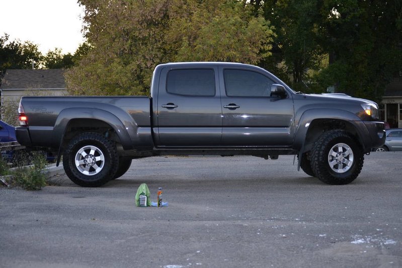

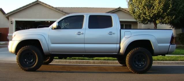

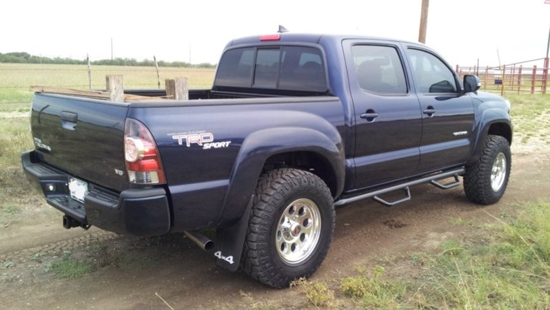

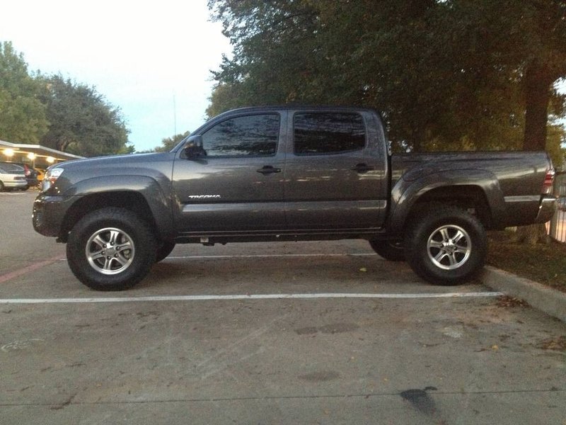

    That's exactly what I did. I'm going with 5100s all around and custom AAL on the rear. Tire size and choice will determine amount of lift. I'm either going to run 275/75-16 or 285/75/16. I don't off road at all so whatever I do will be for looks. Here are a couple of setups I like.

    285/75/16...I think.

    3" with 265/75/16

    1.75 front. 265/75/16
