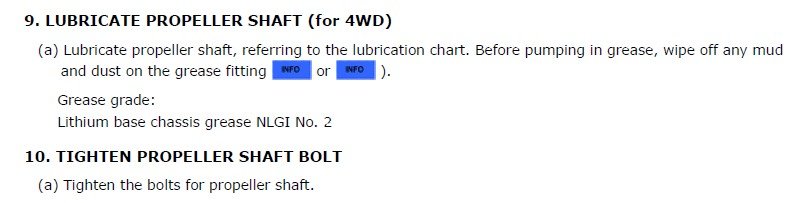

    they were eventually phased out in later model years. bound to be some slop in transition ie. using up old shafts.
    easy to check and grease if you have them. you probably do on 2018. less and less chance on following years.

    You probably only have one, and won't see it if you don't know where to look.
    Front prop shaft above a little plate, iirc.

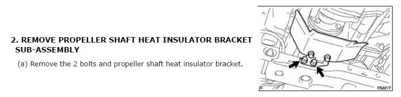

    lol. would be nice if the one requiring some disassembly (plate) to get to was deleted first.
    there is a good pic in the service manual i am looking for. will post when i find it.
    EDIT:
    here is relevant stuff for front prop shaft (sorry to go off on tangent re oil change):
    i had to remove a bracket to get to one of my 2 zerked universals. easy to do.
    general maint section also recommends tightening shaft bolts - mine were fine.
    these are snapshots from 3 different sections...ignore step numbers.

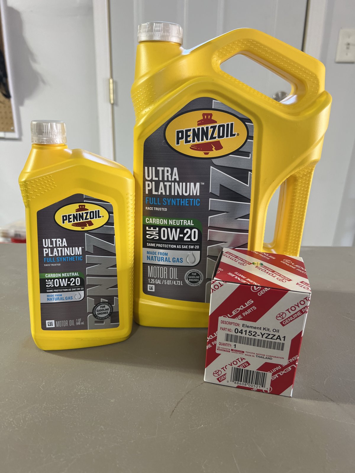

    If I were in your situation I would just change the oil and filter myself and chalk it up to a lesson learned. Specifically I would get some Pennzoil 0w20 and a filter. :cheers:
