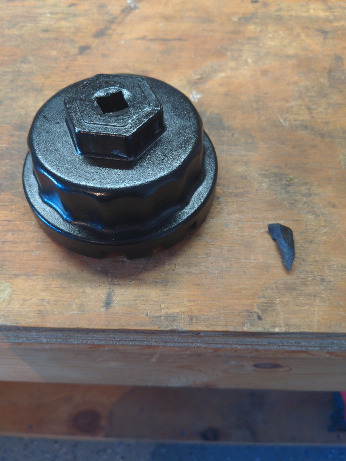

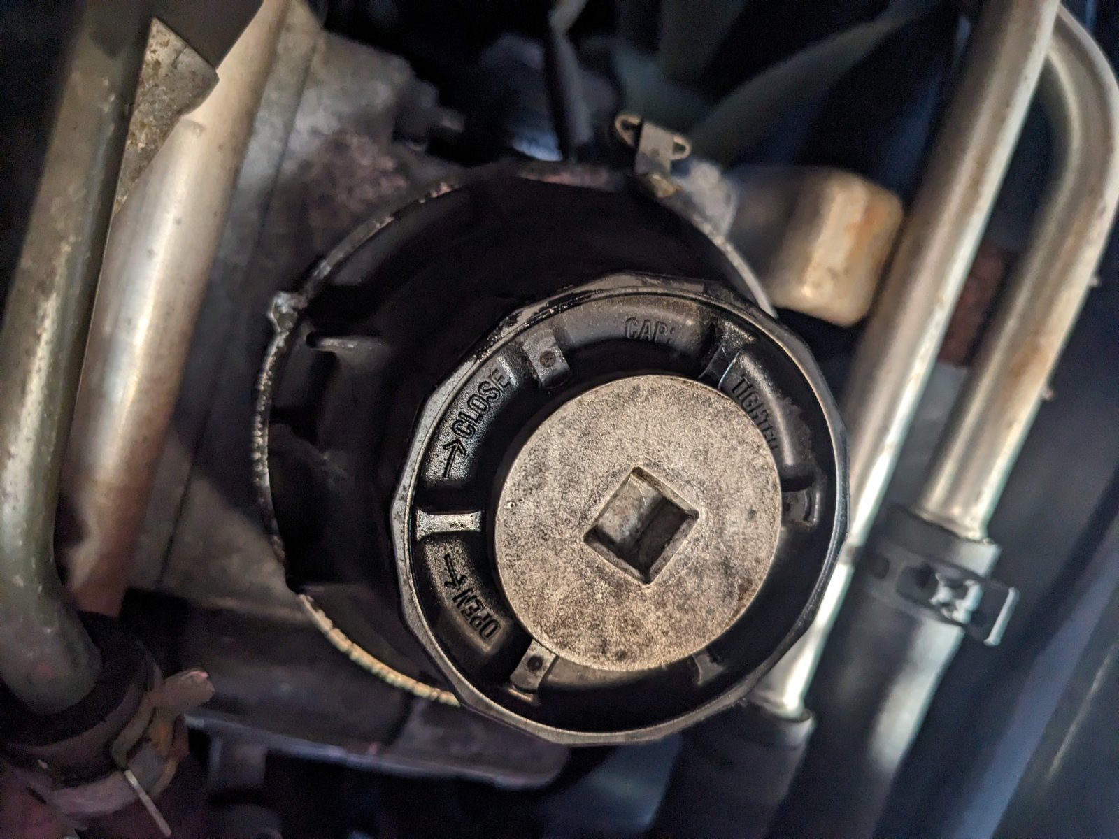

    Okay...so I attempted to change the oil filter today and I could not loosen the filter cap! I put a breaker bar on it and still could not loosen it at all. I also put a 35mm socket on the removal tool and it would not budge!! I stopped before making a huge mistake and reinstalled the drain plug and topped off the oil. Apparently the dealer had a gorilla reinstall the cap! I actually broke off a plastic tab on the filter cap. Any recommendations? I really don't want to take it to dealer. I'm going to buy the metal cap, but first I need to get this one off!

    First thing is you're using the wrong filter wrench. Those that have slots for the tabs are the old design and will almost surely break the tabs. You need the Motivx tool like this one.
    https://www.amazon.com/dp/B00XTAGHU0
    That, along with a six point 24mm socket and a LONG breaker bar should get the job done.

    Okay I cheaped out on the tool so I'll order the MotivX one and the metal replacement cap. I took it around the block, no leaks so no damage done. This proves the fact that the dealership is full of morons! Lord knows the last time filter was changed. I'll report back...

    Damn, that's a half-turn more than where it should be if they torqued it correctly. The three notches should be to the right of the metal retainer clip. Maybe a 30 min drive to warm things up before trying to chisel it off.
