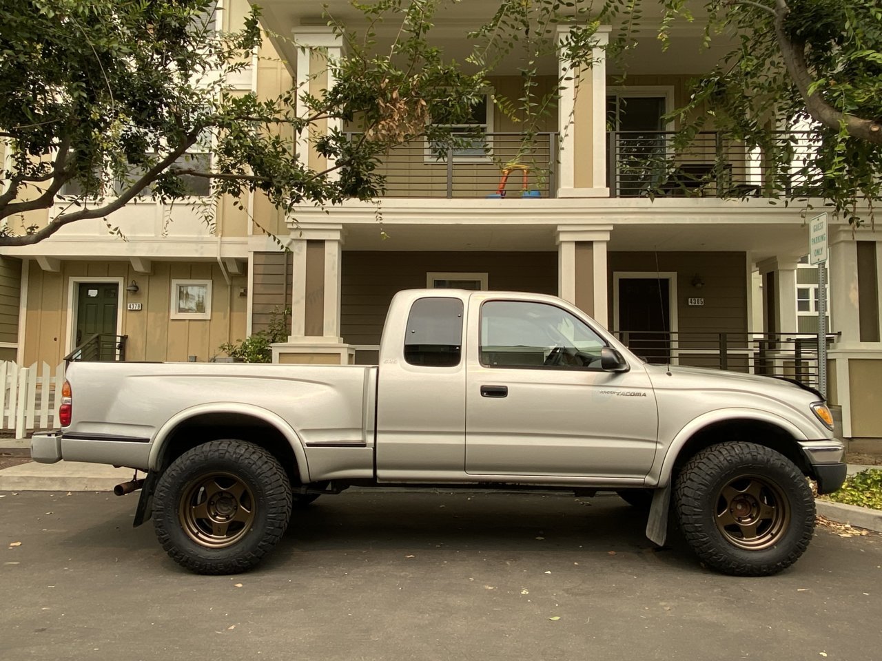

  7. Nov 23, 2020 at 5:54 AM
    #2827
    Tibetan Nomad
    Tibetan Nomad Well-Known Member
    Dec 9, 2016
    #204436
    903
    2016TRDOR:DCLB:JBL
    NitroGear5.29,B6112,.25"spcr,SPC:UCA,Diff-drop,ECGS
    B5160,Dakar-HD-leaf-pk+OL,UBolt-Flip,33s,Superbumps
    Now thats a beauty! :hattip::bowdown:

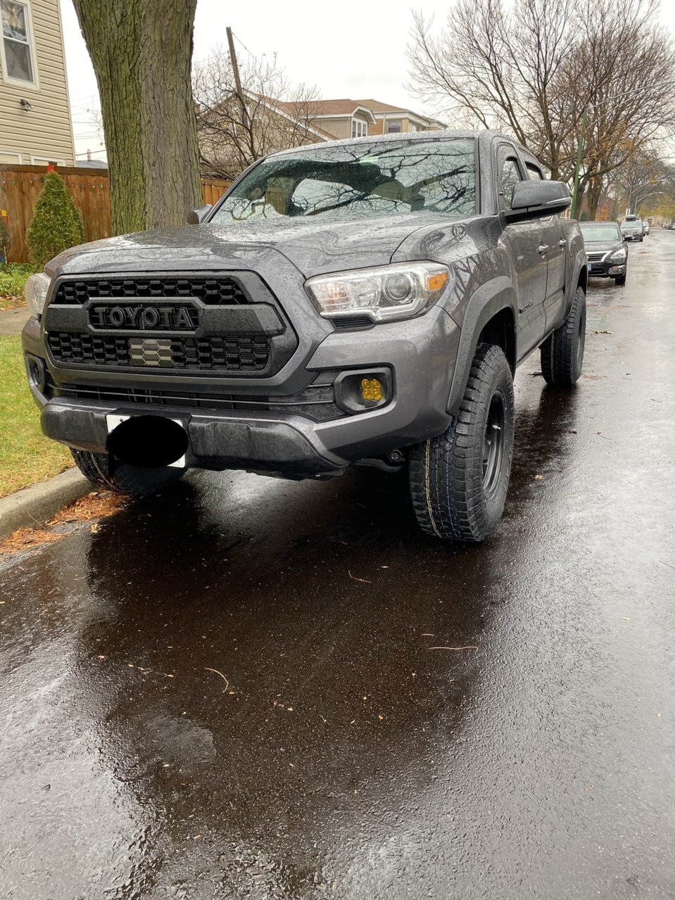

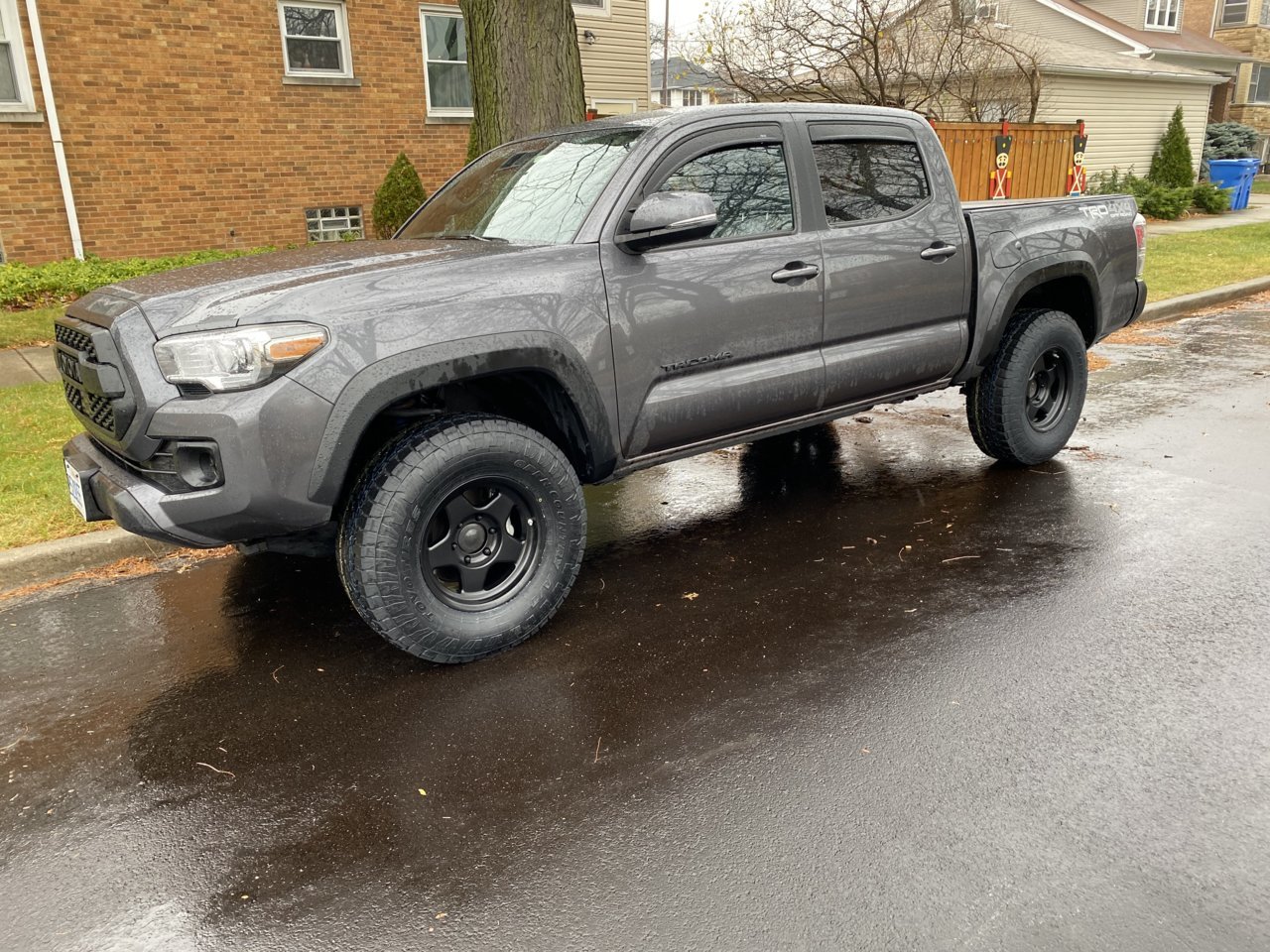

    Chicago, IL
    2020 Mag Gray TRD OR DCSB MT

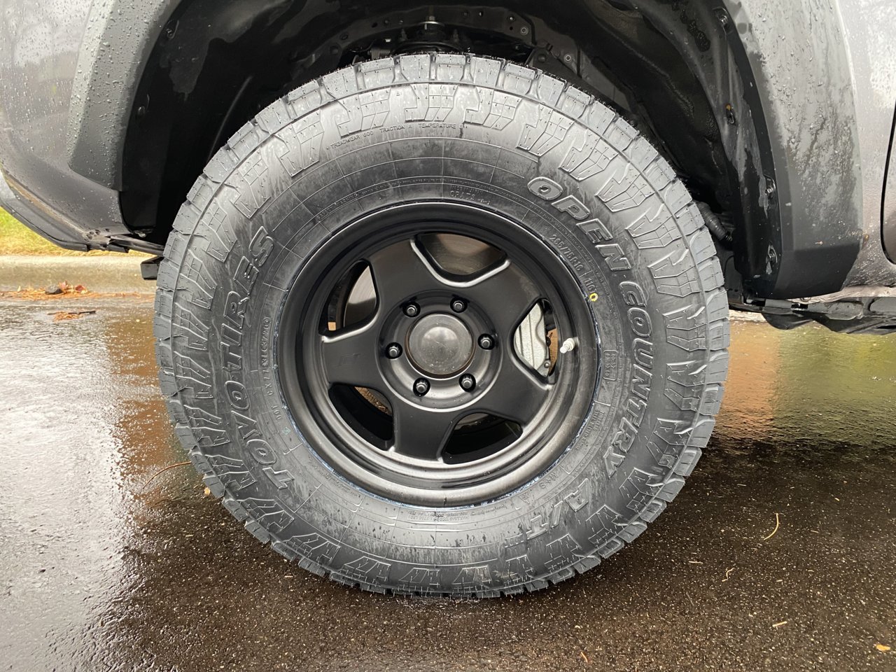

    SCS F5 16x8 4.5"BS 0mm offset
    TOYO OPEN COUNTRY A/T 3
    265 /75 R16 116T SL BSW

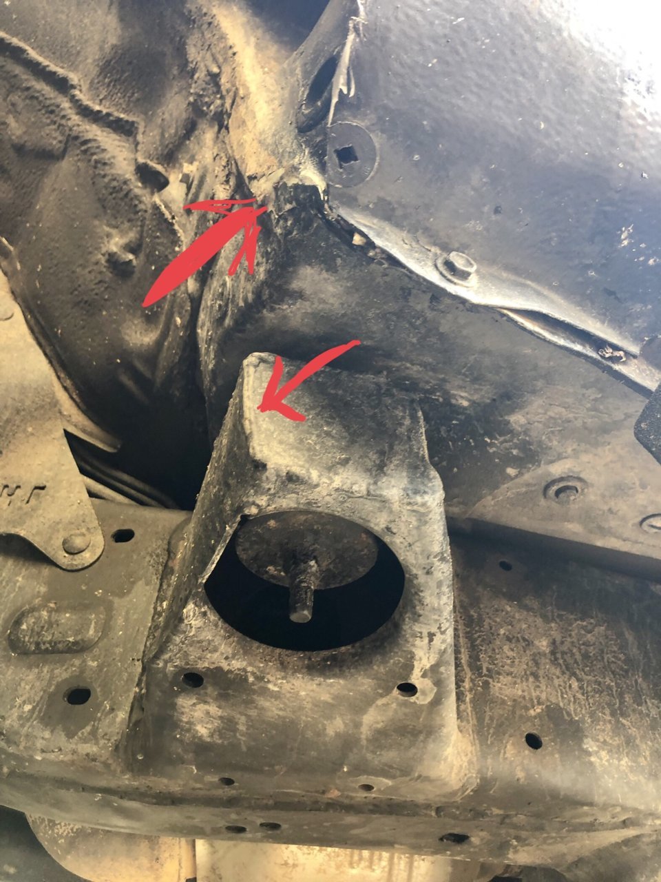

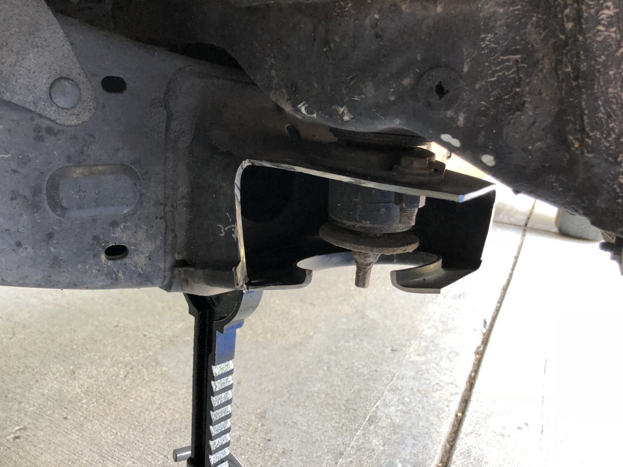

    First let me be clear... 295s with this offset wheels need lots and lots of trimming. As I wheel more and more I find more and more that needs trimmed, and I have an aggressive cab mount chop, have taken off my fender flares, and actually trimmed the metal fender. Because these wheel poke so much, they have a wider turning radius, and you will need more cutting than you would have with the 10mm offset wheels. :sawzall:
    With a these specific wheels you will need to do a CMC, hammer the pinch weld, trim the wheel well liner and likely have to also trim a little of the plastic fender flare itself for 285s. With 295s, expect much more needed trimming.
    This all depends on if you wheel I guess. I noticed I needed more trimming and finally went for the flareless look after I wheeled in Moab. If you don’t wheel hard, you’ll still find those rubbing spots when you turn hard into driveways etc.

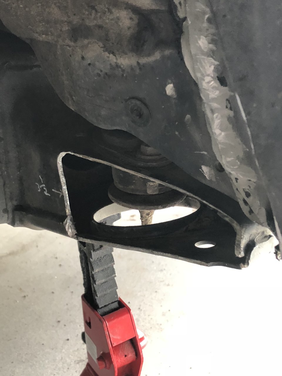

    CMC for 295s went from this which was what I thought I needed:
    To this: and to be perfectly clear, I still rub ever so slightly with this lift and these wheels/295s on this much of a cab mount chop
    Dented fender, where I had already trimmed it and pulled the flares, but still rubbed.
    this pic shows where on my aggressive cab mount chop and hammered pinch weld, that I still rub with my lift, these wheels, and the 295s
