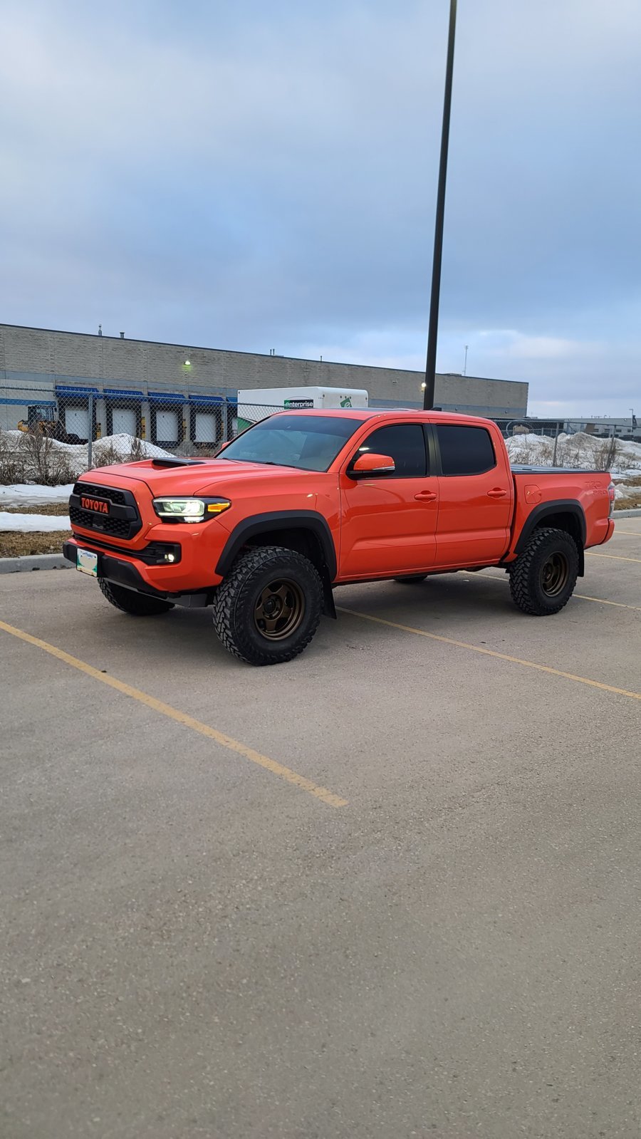

    I can finally play too, 16x8 - 25mm with 255/85r16 g003s. Matte dark bronze goes really well with solar octane. 20240316_212051.jpg

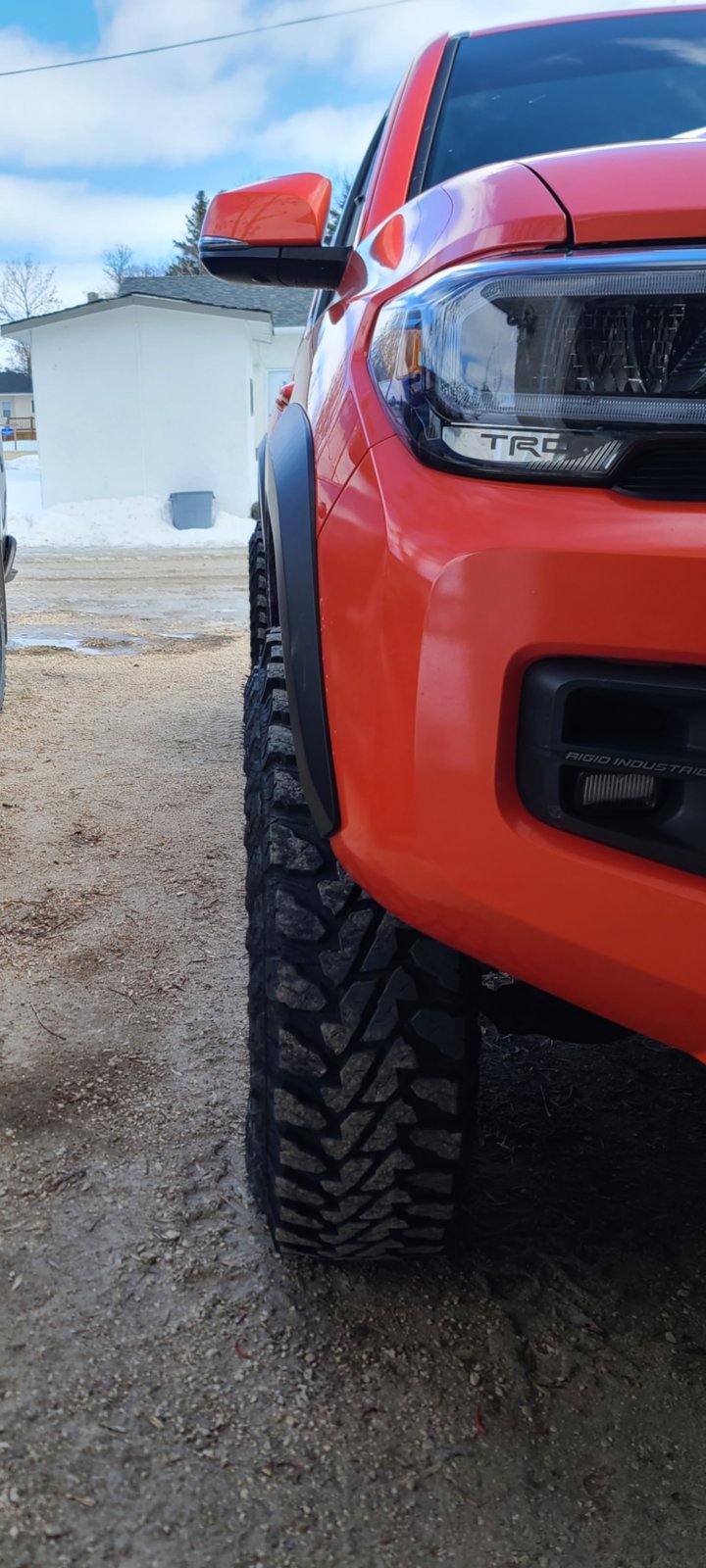

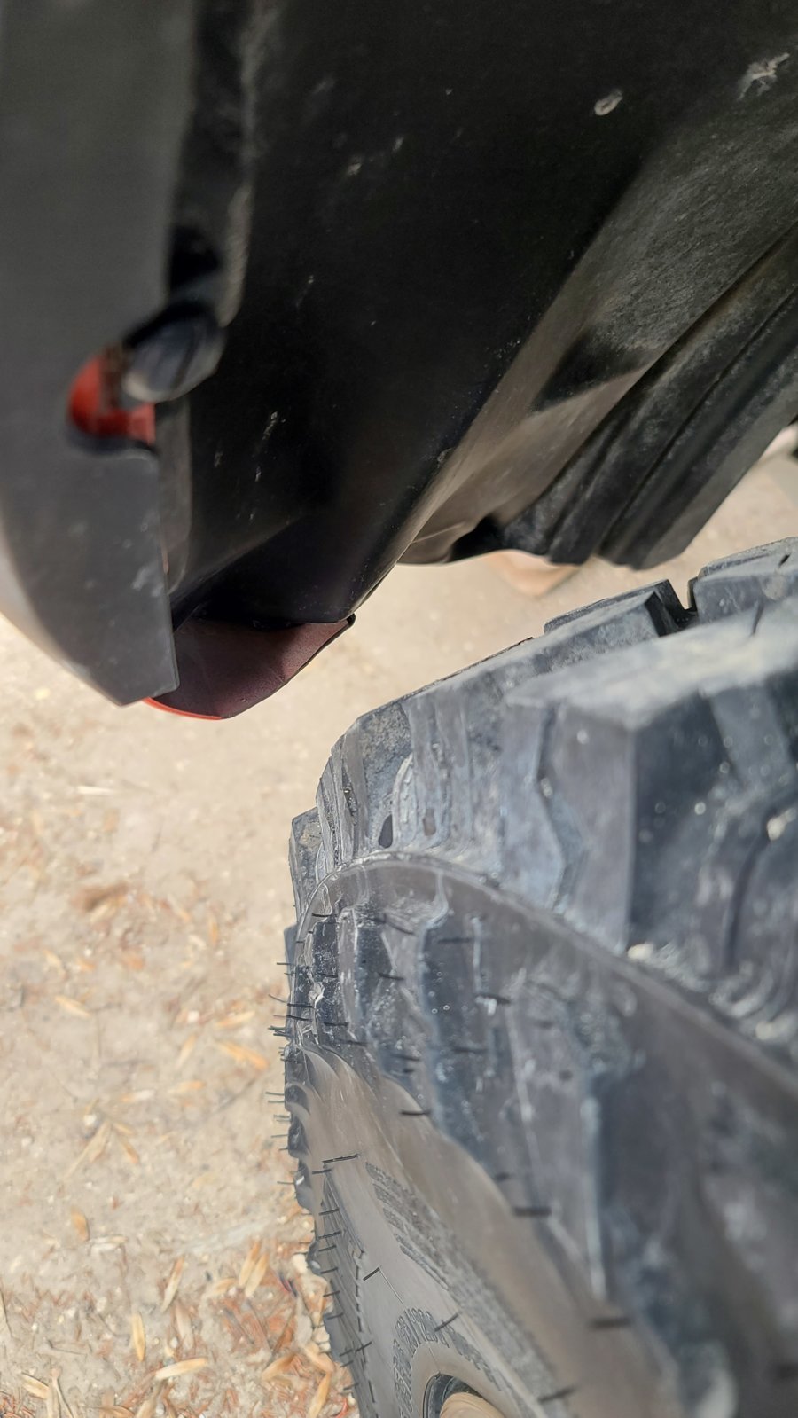

    I spent along time looking for this kind of picture of -25mm offset with 255s. There is one other in this whole forum as far as I could find. Perfect amount of poke. This is a stock height pro with 3° of Caster and a bmc, had to trim the edge of the bumper and mold the wheel liner back in the front. Not even close to the mudflaps or body mount. Screenshot_20240317_154640_Gallery.jpg 20240317_123938.jpg 20240317_123057.jpg

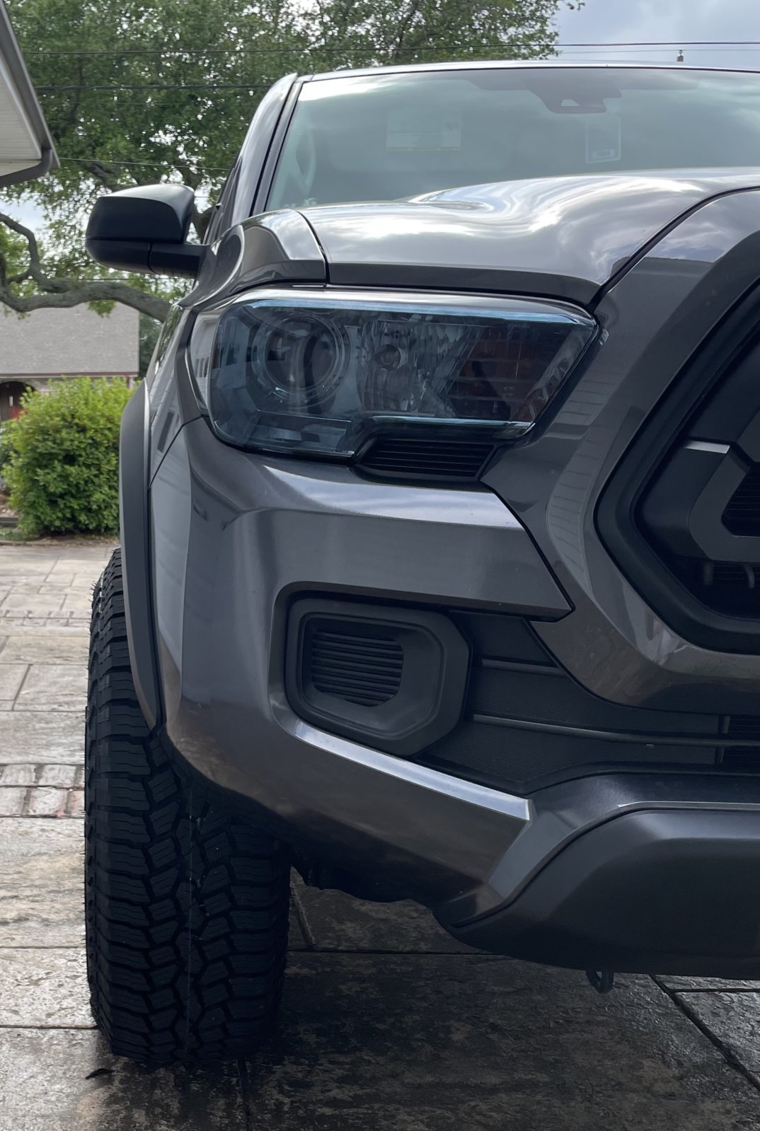

    SCS F5 -25 offset. Falken Rubitreks 265/75/16. Stock height (for now). Removed mudflaps, some cutting. Rubs a little - hope raising front with Bilstein 5100 leveling resolves
