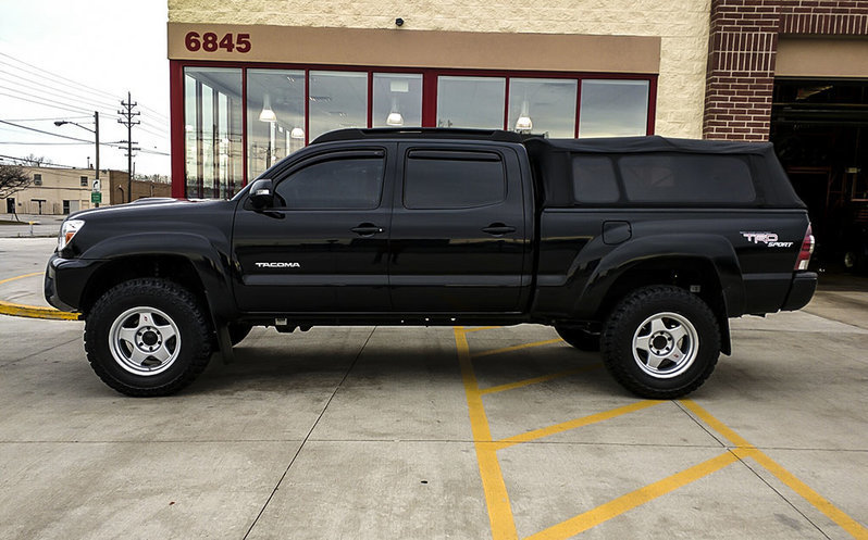

    Here is a shot of my F5's:

    Nice Truck!! Thanks for posting I’ve been curious how having the two different wheel widths would look.

    Lol! The wheel widths look different. Could be the angle.

    Kinda weird how the pic looks like flat black paint, probably the smoke in air.:rasta:

    Well shit, I'm sold. I've been back and forth on 3.5" BS F5's, but wasn't totally convinced on how they look on our third gens. Looks amazing, congrats.
    The real question.. bronze or gunmetal on cement?

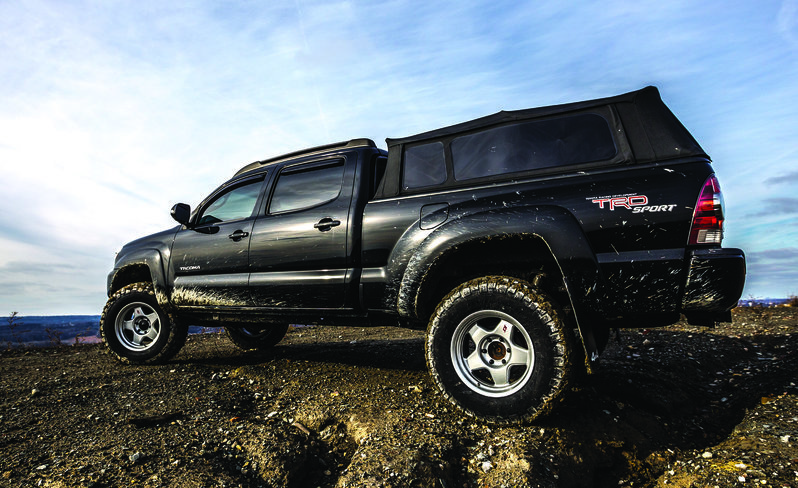

    Thanks! Perfect fitment on the 3rd gens IMO. Stance is on point. Pics really don't do it justice but having no lift and a smaller tire size and it still looks dominating on the road or trail. Can't go wrong with either... Starting to feel like bronze might be the new black tho.. To be honest I think 17" deep dish in black would look best on cement, not gunmetal.

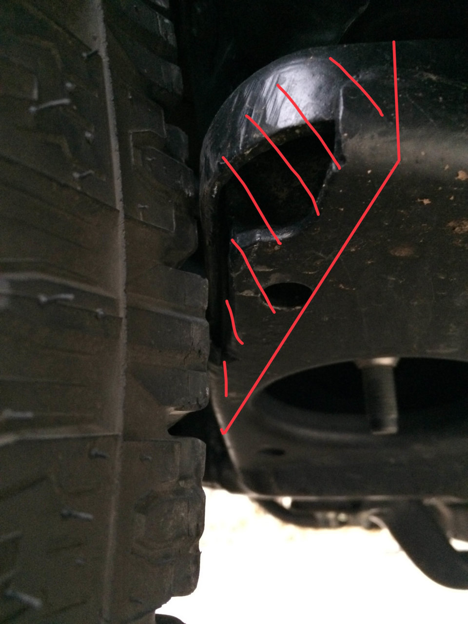

    Correct but the offset and BS of these wheels will create a scrub radius that will cause you issues.

    Ah, ok. I'm assuming it must be a sidewall issue, then? All else being equal, the 265/70r17 fits better?

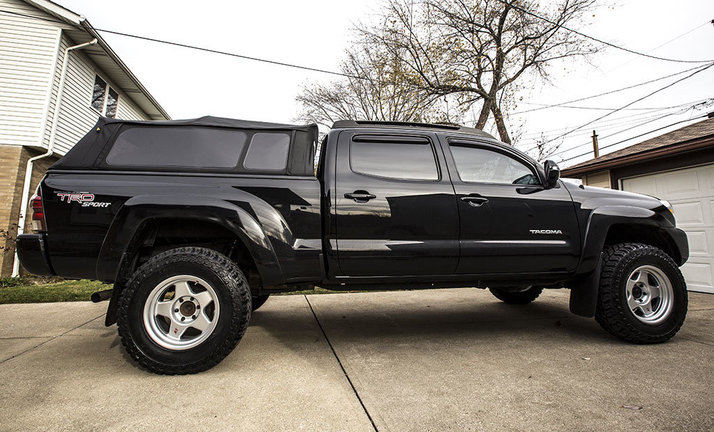

    sheesh. I was sold on bronze but damn white on black looks deadly too :annoyed:

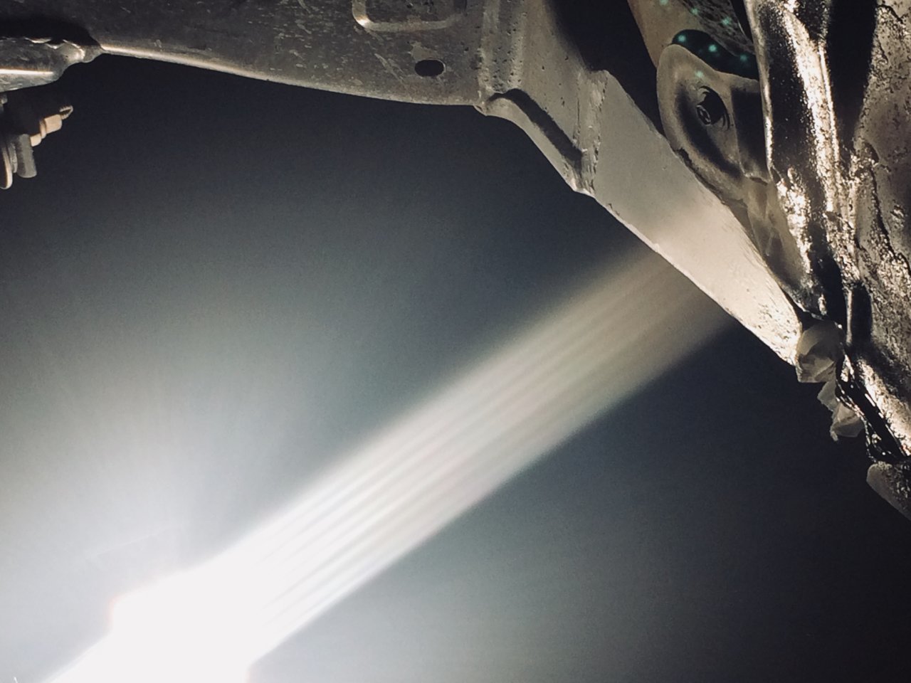

    Right where the sidewall meets the tread. Rubs on the cab mount and various pieces of plastic on both the front and back of the wheel well. Not a lot of trimming but the CMC is most important.
    Again, considering you're interested in the 16" wheel even though they have the same offset and backspacing as the 17" wheel you will be 0.5" narrower so less trimming will likely be required.
