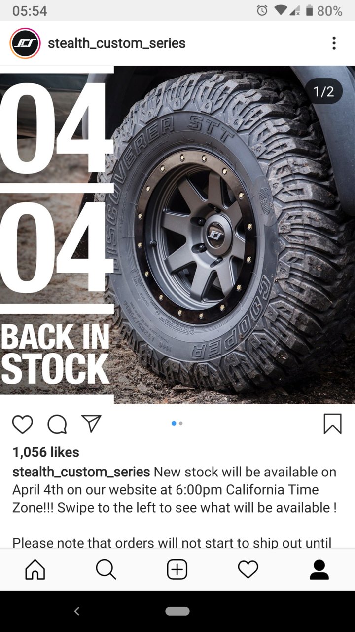

    Thanks super helpful. I may just wait. whats the best way to stay tuned on restock? just keep checking the website or there forum page?

    Yeah I literally checked stealthcustomseries.com daily for almost two months to get all 5 of mine. I had to place two orders because I couldn't get all 5 at once. It's so worth the work though, and Vin has great customer service and advice.

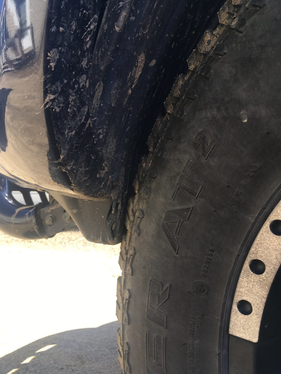

    The one thing I would say is that if you want to run a bigger tire without rubbing, you'll want to get the 4.5bs wheels. With my Ray10s at 4.0bs back when I was running 265s, I still had to trim some plastics to keep from rubbing on stock suspension.
    Honestly though, once you do a little trimming you realize it's not nearly as scary as you thought, plus you can't tell unless you look close inside the wheel wells. I'm pushing mine out even farther, I'll be at 3.25bs or -31 offset with 285/70R16s, and I'm 100% sure I'll have to trim more, and maybe even do a cab mount chop. But I'm fine with that now that I've already trimmed for the other tires. I also only have a 1.75" level in the front, and the rear is stock.

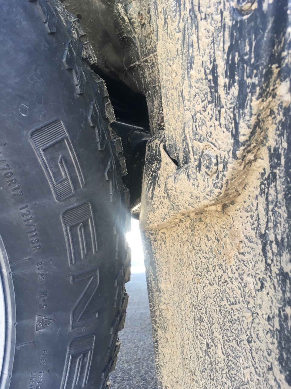

    Now are you rubbing on turns or just over bumps and cruising? I have a leveling kit in my truck now that I think I will replace with 5100's, leaf add, and after market UCA down the line. (current lift rides pretty rough but also may be LT tires)
    My truck now rubs when I'm making sharp turns with the tires that came on the truck, LT285/70 R 17

    Sounds like you're headed the right direction with the suspension. You also already have tires that are an inch taller than my current ones. I used to rub on turns as well as bumps, but with that taller tire that you have I would guess your truck was already trimmed by the previous owner. Almost nobody can fit a 285/70R17 on our trucks without some form of trimming. Can you post a pic or two of where it rubs in your front wheel wells?

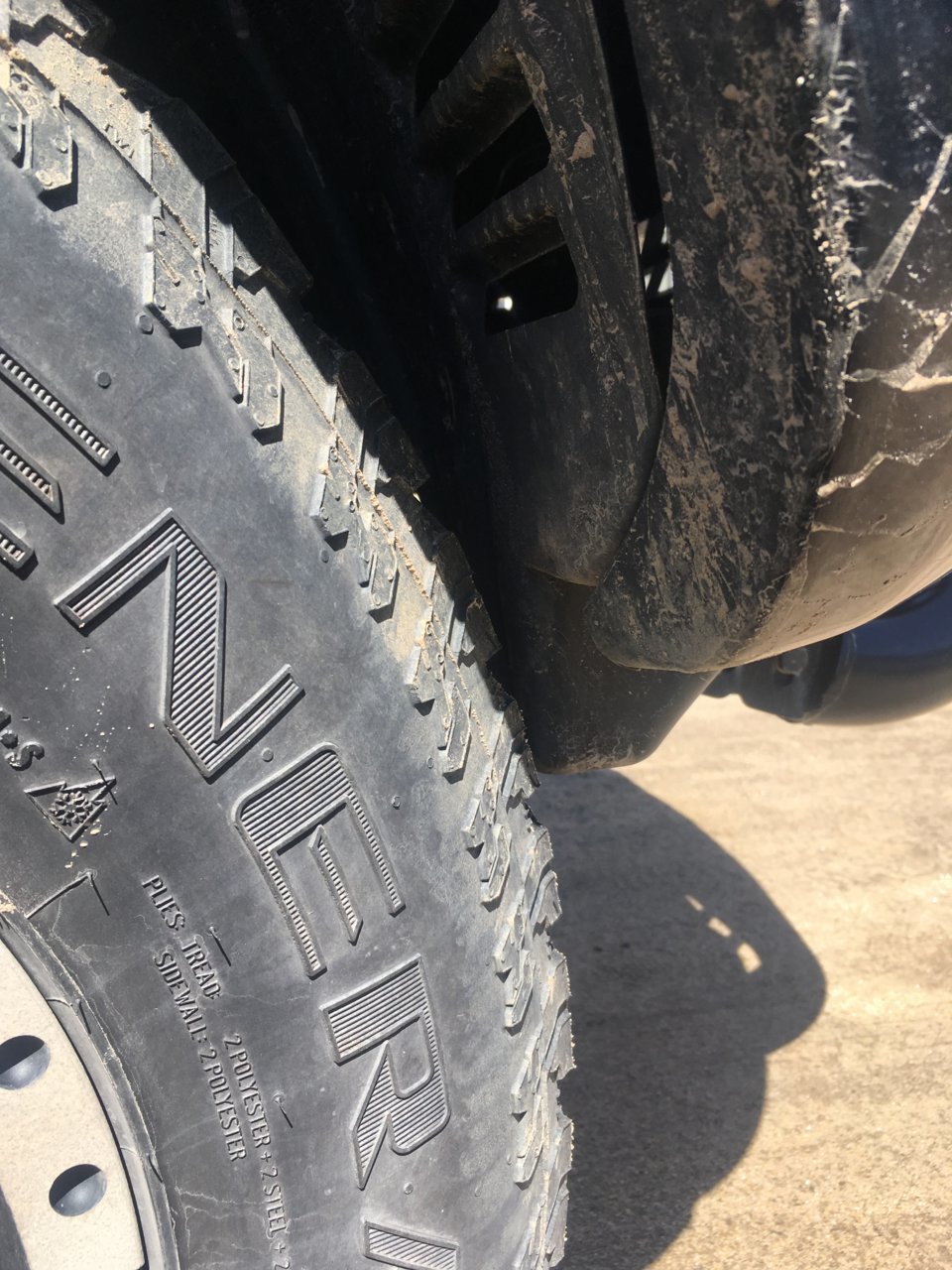

    That is wheel fully turned in both directions.

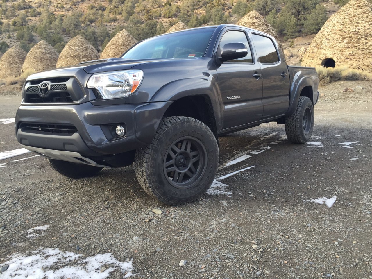

    I run the F5s in 16" with 4.5bs. I get a bit of rub even with just 265/75s on the cab mount when I'm offroad but that can be corrected with an alignment...the shop I took it to after installing the SPC UCAs got the numbers where I asked them but I need to move the tire forward in the wheel well with the UCA adjustment and take it back for another alignment since they only used the LCA adjustment.

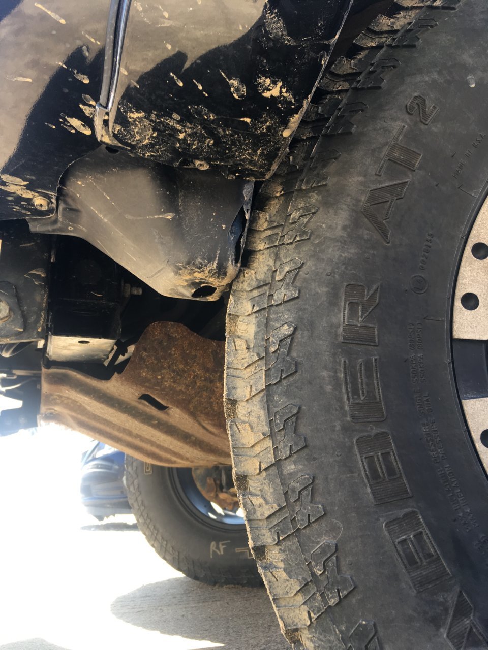

    So I had the same rubbing on that plastic piece hanging down in the front, and I just cut it off and trimmed it back a bit with a pocket knife. No more rubbing in the front. I also had to trim the corners of the fender flares on the bottom. Looks like you have plenty of room in the back which is good.

    I’m currently running the stealth 6 model with a 2.5” leveling kit on the front. I have 265/70/17 tires and have no rub whatsoever. The best way to keep on restock is to follow them on Instagram, as they always post restock dates and what they’re gonna stock. Can also send Vin a DM and ask him, he’s been awesome for me. Hope this helps!

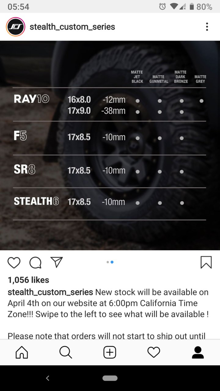

  19. Apr 4, 2019 at 5:56 AM
    #19
    Ccrames2018
    Ccrames2018 Jack of some trades.
    Mar 7, 2018
    #246573
    1,475
    Caden
    Nor Cal
    07 AC 4x4 V6 6MT
    -Bilstein 5100s @1.75" -16x8 SCS Ray10s with 305/70R16 General Grabber AT -CMC -URD Short Throw Shifter -Bed stiffeners -Bed mat -Aftermarket head unit -AFE Rebel exhaust -ME-SO Customs dome/map lights -Window tint with eyebrow -OEM LED 2015 tail lights -GTR Lighting headlight bulbs -Husky floor liners -Camper shell -Sumo Springs -Air intake -Aftermarket Volkswagen key fob -Aftermarket A/C knobs -Aftermarket LED license plate lights -Console organizer -JBA High Caster UCAs
    There's going to be new stock on the website today if you are ready to buy wheels.Screenshot_20190404-055408.jpg
