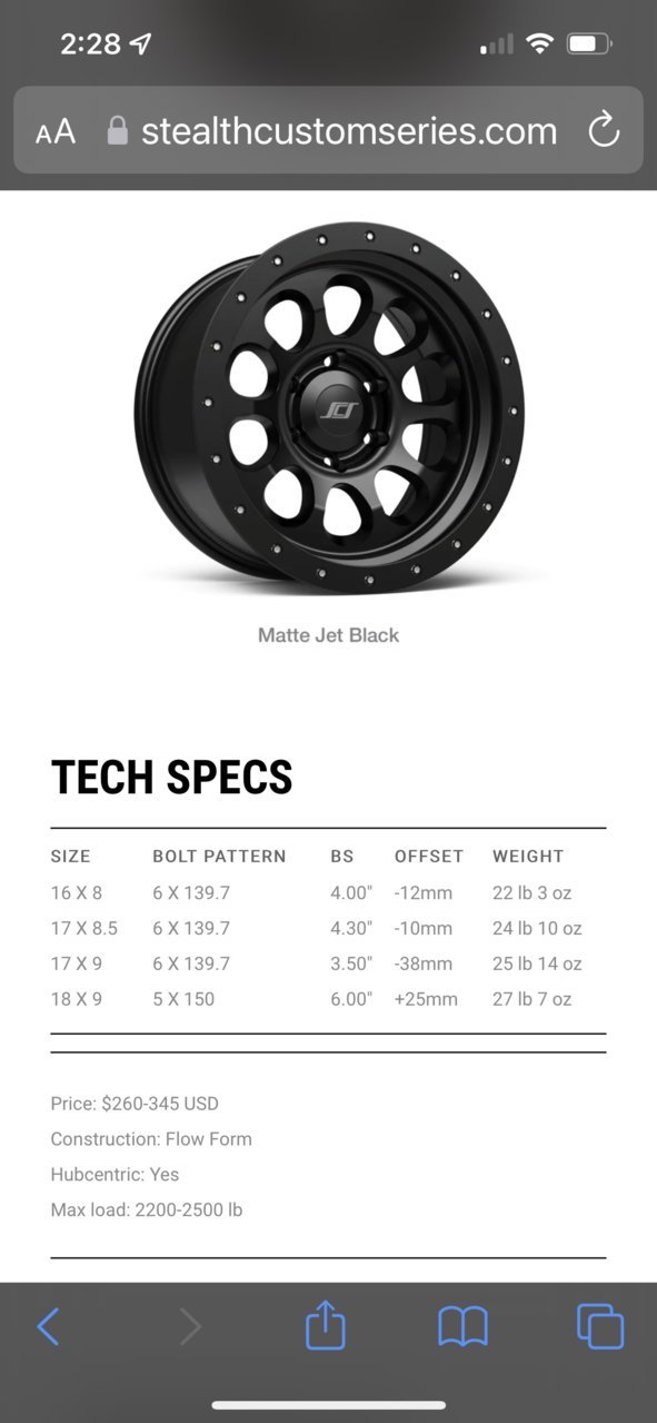

    I have a stock 2022 Toyota Tacoma TRD sport . I’m looking to buy these rims. Which size will fit the stock setup ?
  2. May 26, 2022 at 12:44 PM
    scs_vuth
    scs_vuth SCS sales rep
    Feb 1, 2017
    #209278
    481
    Vuth
    Bay Area, Ca
    2013 Tacoma - 2020 GX460 - 2022 Jeep Gladiator EcoDiesel
    For stock fitment, we recommend you choose either the Ray10 16x8 -12mm or the 17x8.5 -10mm.
    265's will be the largest tire size we recommend you install for the least amount of rubbing on stock suspension. We recommend you install a lift and do a body mount chop with any tire size larger/taller. Depending on the tire brand you choose, you might have to take off your mudguard and do some minor trimming to avoid rubbing at full flex.

    And to clarify, the 18"x9" will not fit, due to the different lug pattern. The 17"x9" will fit, but would require cutting, bending, etc. As SCS said, the "easiest" size to fit will be the 16"x8" or the 17"x8.5". The only variable left is what tire size you try to mount on them. Bigger tire = more mods (cutting).
    Correct, this is for Tundra/Sequoia fitment.
    Correct, the 17x9 -38mm is a very aggressive wheel spec.
    Correct, with 265's tire size.
    Correct, correct.... the bigger you go the more you'll need to trim/cut to avoid rubbing at full flex.

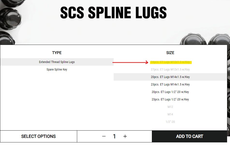

    Now let’s talk about the spline kits. Which one do I need ? Also shows packs of 20. But I’d need 24
  7. May 26, 2022 at 2:50 PM
    Bertw192
    Bertw192 Well-Known Member
    Aug 3, 2017
    #225852
    14,354
    Bert
    Seattle, WA
    2017 TRD OR DCSB
    All the things!
    Currently sold out... but you need M12x1.5

    I believe these will work for you... If not, someone will certainly enjoy correcting me. @Wheeler's Off-Road Inc usually offers a discount for TW as well
    Edit: Don't forget a key...

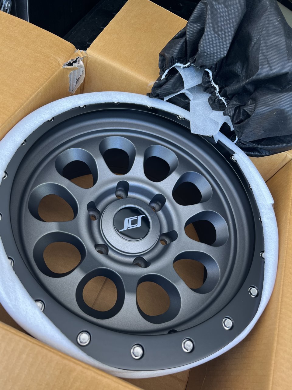

    Received these bad boys today . Can’t wait to put some sneakers on them

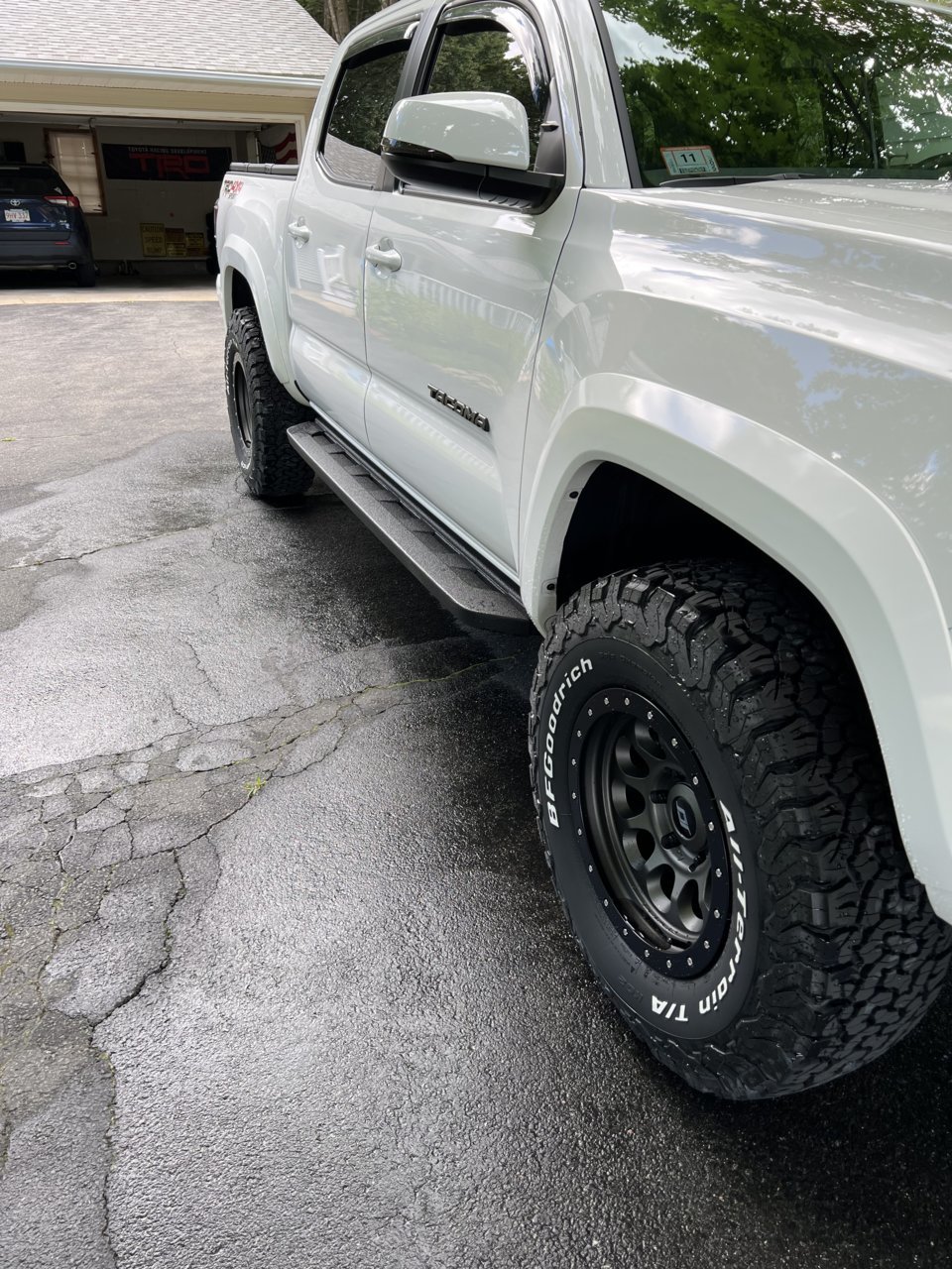

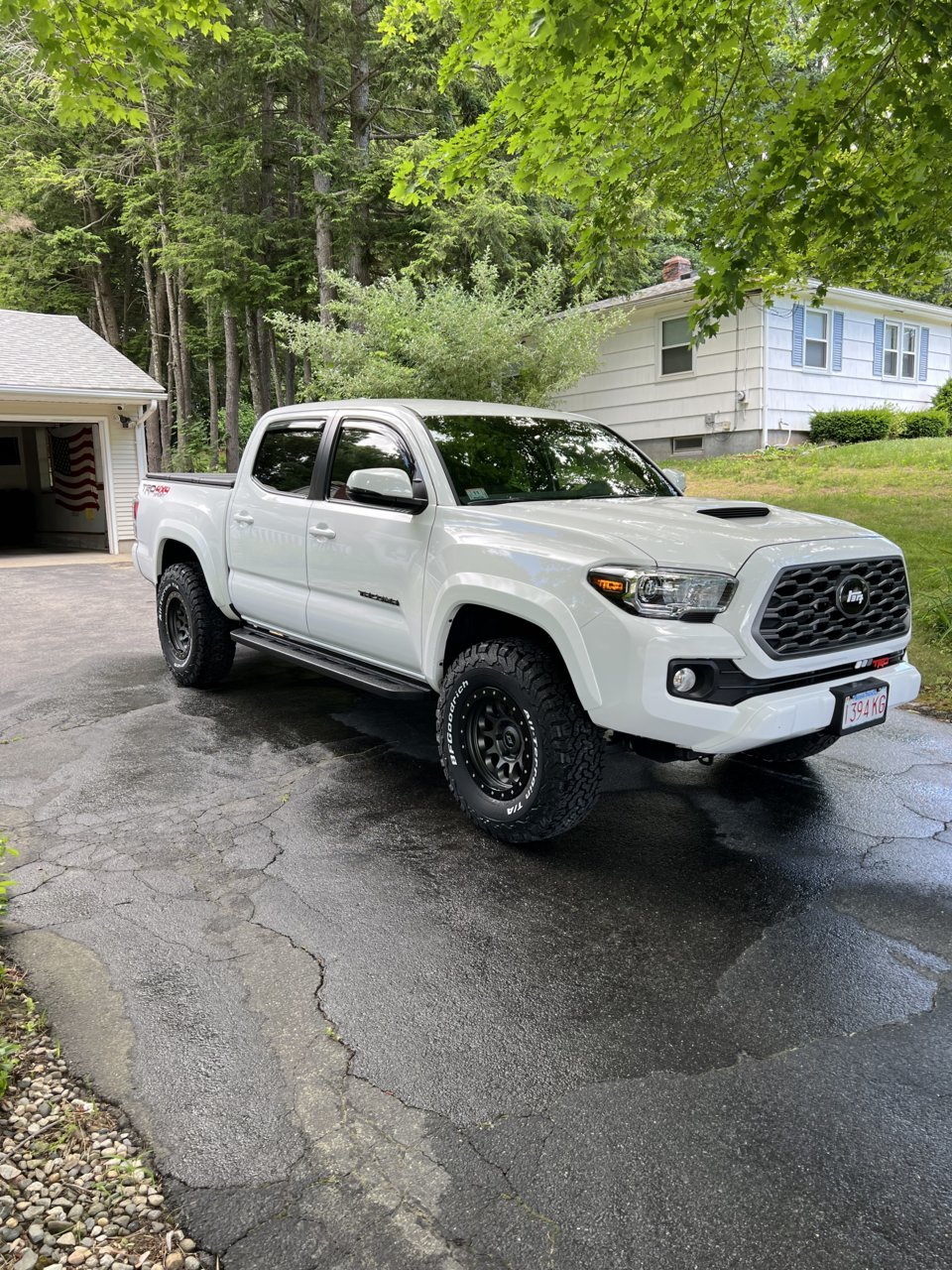

  16. Jun 29, 2022 at 10:39 AM
    #16
    redbulll
    redbulll [OP] Member
    Jan 26, 2016
    #176109
    16
    D2C11BE4-D433-415C-85B2-004866DEE2D1.jpg 0E508745-086E-4CF7-A6FC-35EBEFFA0889.jpg So happy with this setup!
