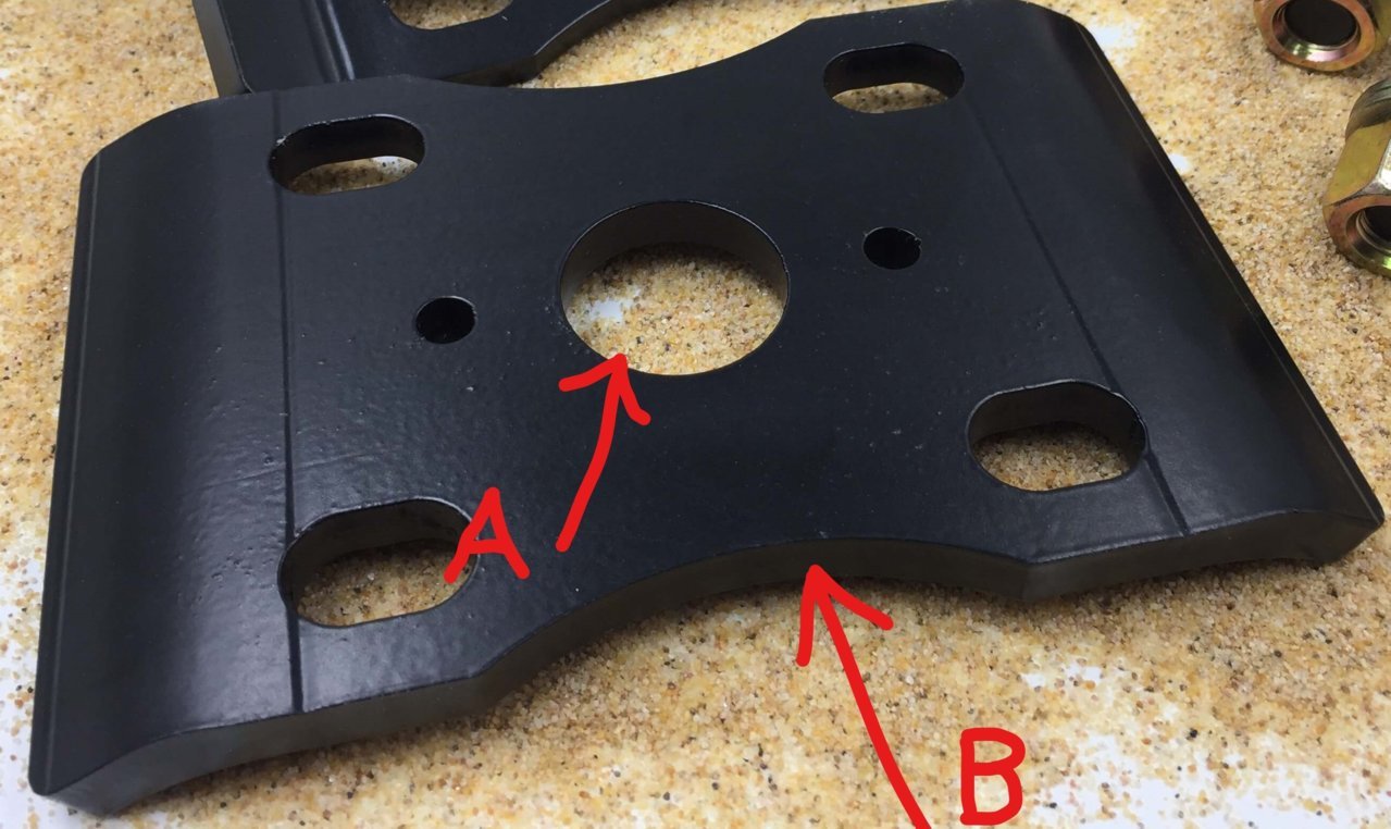

    Some features of a competitor U-bolt flip plate that I see as issues:
    A. A very large center hole (plus elongated holes) does not engage the leaf pack center pin nut, potentially allowing plate to slide and lose alignment. OEMs use a small diameter hole here.
    B. Scalloped out sides reduces strength of plate and potentially allows bending

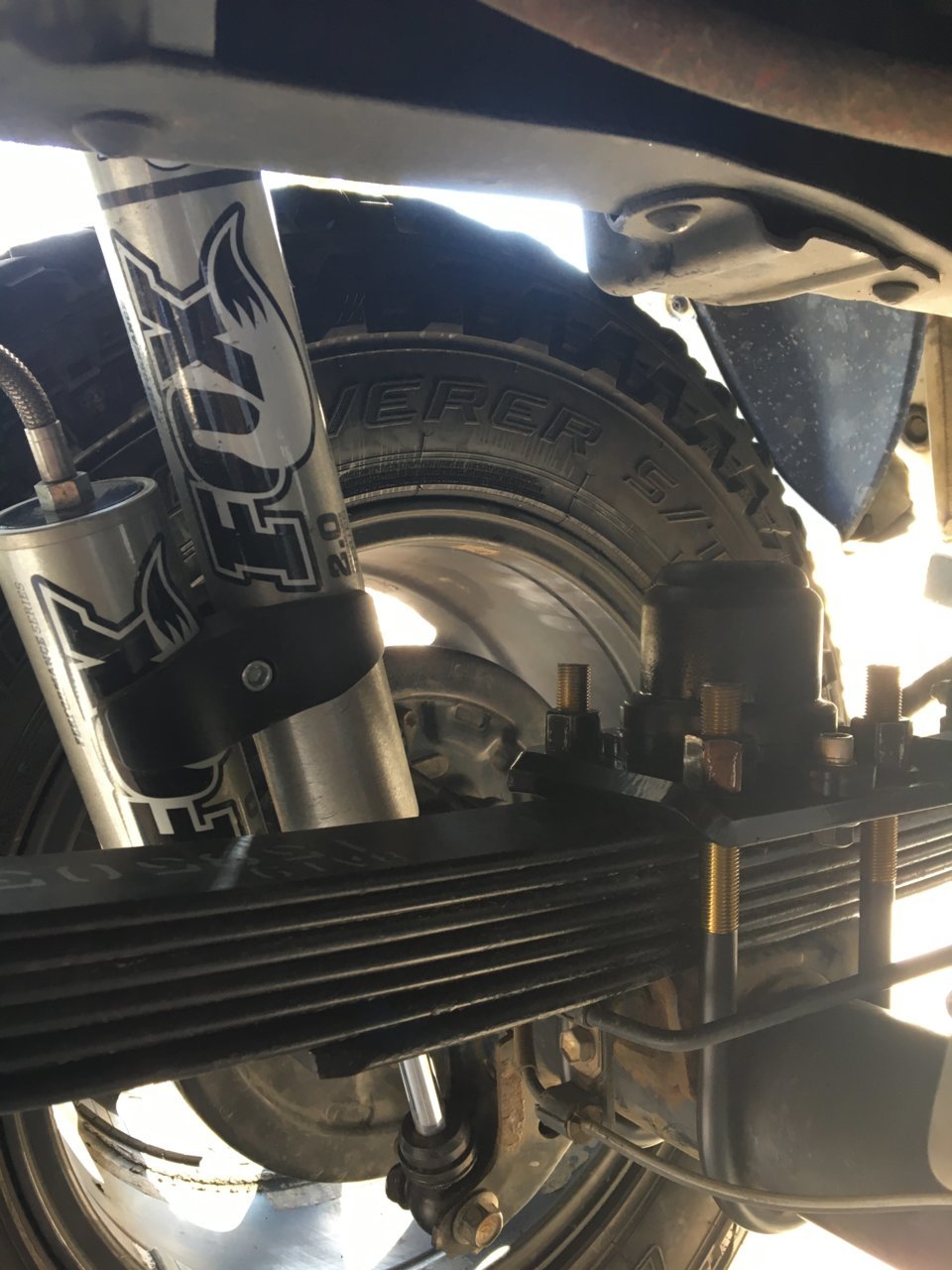

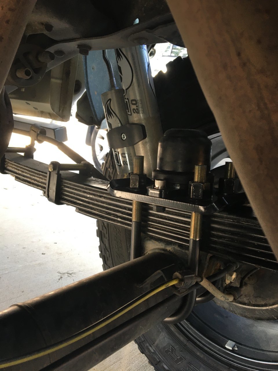

    Installed the kit today! Here's some photos. I'm not a huge fan of zinc plated bolts, so I primed and painted them with rubberized undercoating.
    Out with the old, in with the new.
    Cut about 1-3/8" off the ends to fit stock leaf springs.
    Very happy with the quality. Bump stops feel great. Thanks again!

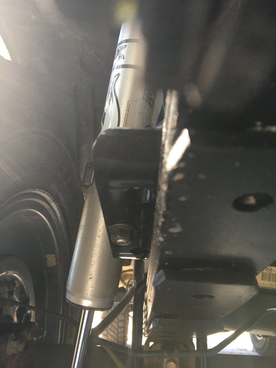

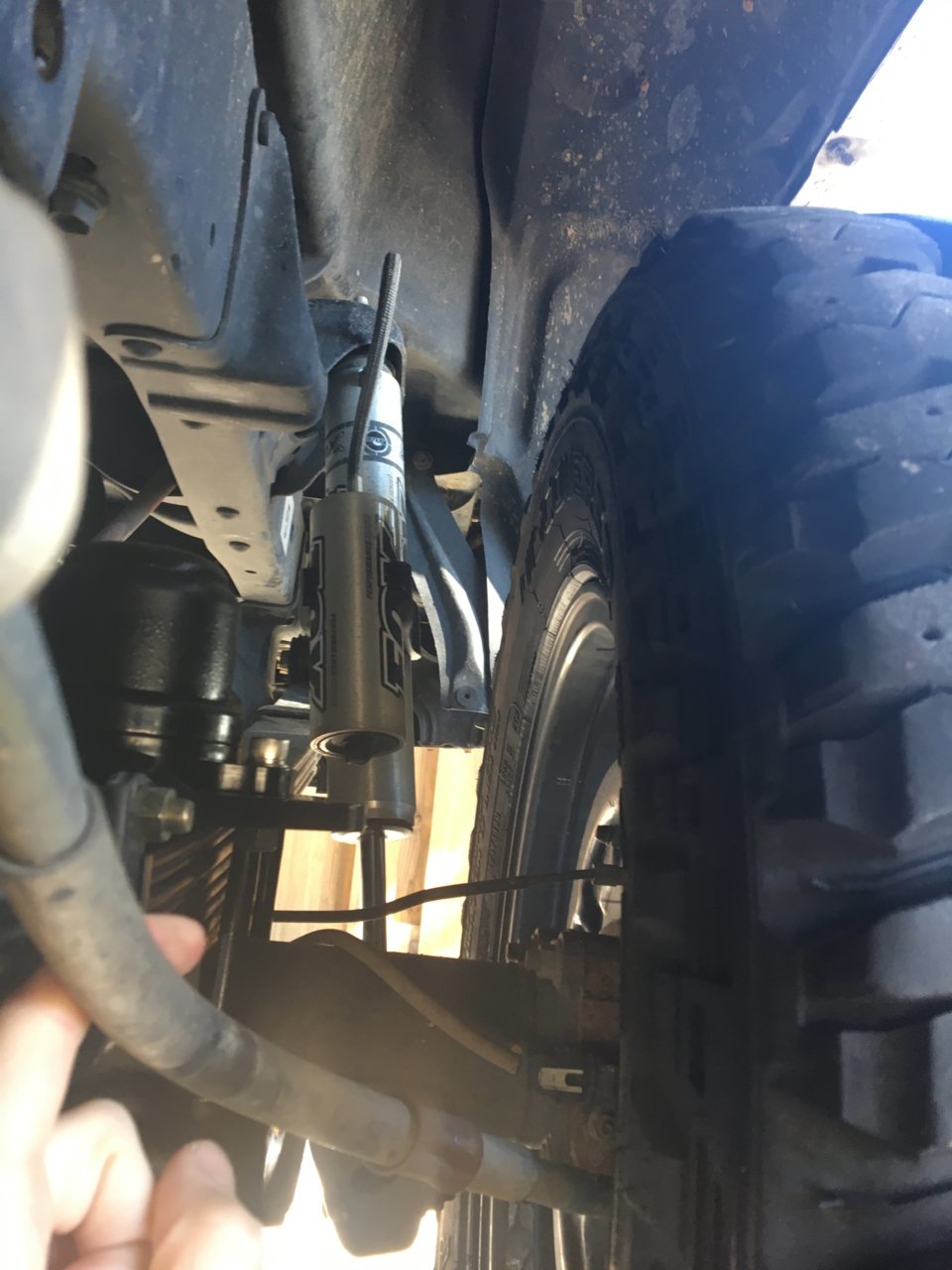

    I just snapped a few for Accutune who is also helping out. Unfortunately I put the old hardware back on so you’ll have to use a little imagination.
    With the plate sitting on the leaf pack looking down the leaf springs, you can see where the plate will be conflict. 814DA018-2CD6-4D37-B870-4E1BF887DF97.jpg
    Looking from the rear, I also tried flipping the plate around. It’s tough to see, but you can just barely see the resi behind the shock body68D61F59-D93F-455E-96A0-2BAE099F79FB.jpg
    When I spoke with Accutune they suggested potentially cutting the plate to fit. They may have a different solution once they see the photos though.
    My issues seems to be primarily a width issue with the resis mounted on the shock body.

    Thanks for pics, I need a picture of the point on the plate, the first batch were too close to shock.
    There are 2 problems:
    1. The ubolt flip plates must be installed with pointed side outward
    2. The resi cannot face the axle, it will jam into the axle during compression, I think the shocks have to be rotated 180deg or switched to opposite side of vehicle.
    Fix those issues and report

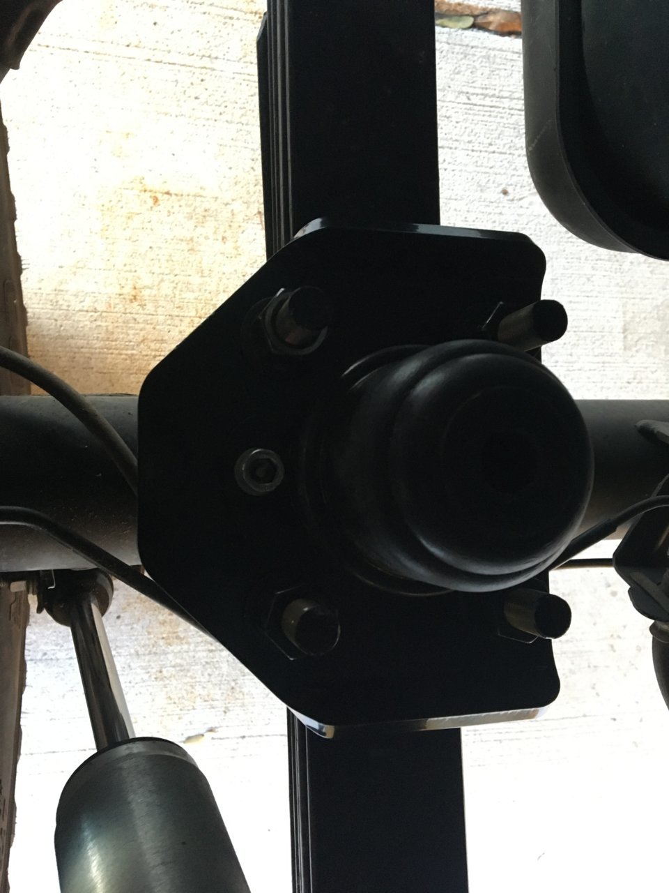

    And one photo of a top view of the plate.
