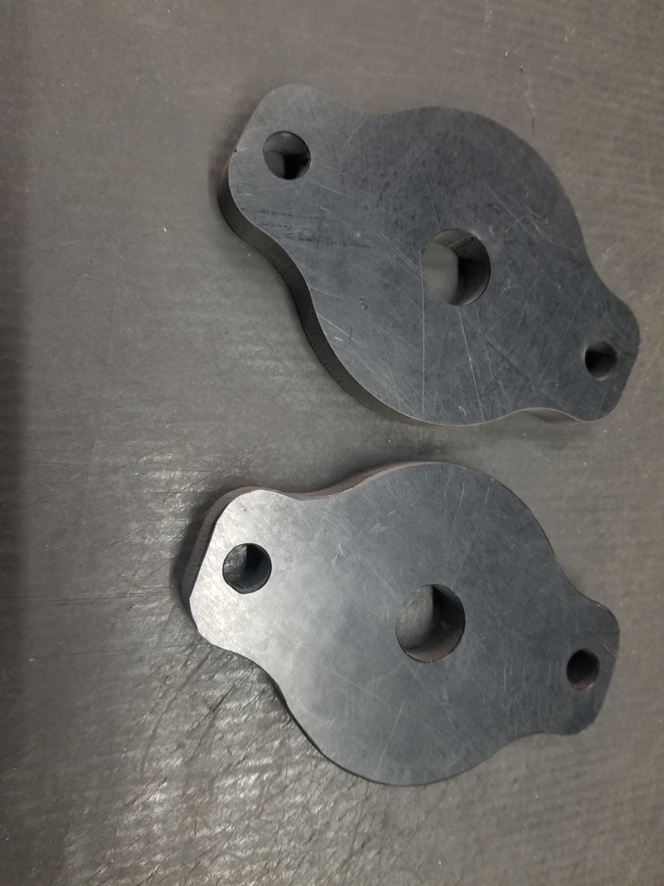

    We have 8 pairs of 1/2" thick spacers waterjet cut. You shouldn't need more than 1/2" spacer, if you do, then very likely there is something wrong in your setup.

    what would be the purpose of this plates? This could help so I can shift up the lower shock relocation plates ?

    It's to limit your up travel by 0.5" to keep the shock shaft from bottoming out if you are having issues depending on your specific setup. I effectively moves the bump stop down 0.5". If your rear suspension is set up/spec'd properly you shouldn't need them.

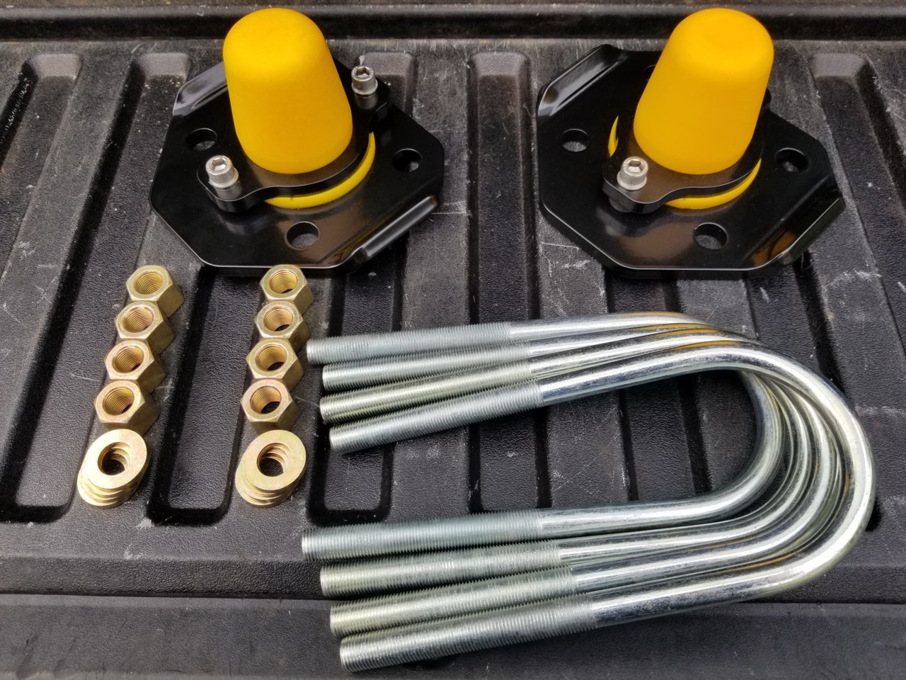

    We currently have about 10 U-bolt flip Option 3 kits boxed, ready to ship today!
    NO LEAD TIME!
    Start conversation for TW discount code
    Option 3 is our best offering with soft engagement, it slows weight down over more distance for more progressive feel.

    So I installed the Archive Garage option 3 U-bolt flip kit on another TW members 2012 DCLB with the Icon RXT leafs that were previously installed a year ago.
    My overall review:
    1. The directions were very straight forward and even though I have installed numerous U-bolt flip kits in the past, the directions are well thought out and simple for the average DIY truck enthusiast.
    2. The U-bolts are very stout and the steel base that the bumpstops attach to are very well machined. I had absolutely no problems getting the bumpstops attached to the steel base.
    3. I really liked how the bumpstops were thought out. It is a very firm material that gives both support and comfort, as well as protect for the shocks from bottoming out.
    4. When cycling the suspension over bumps, I was pleasantly surprised at how soft and comfortable they were with 600lbs+ in the rear going over bumps. I drove the truck before we installed them to get a feel of the OEM bumpstops beforehand and then drove over the same obstacles after installation.
    5. The bumpstops are not so high that the truck would be hitting them all the time but high enough to focus on protection.
    Overall thoughts:
    I have a Wheelers U-bolt flip kit on my rig with Timbren bumpstops that I installed 2 years ago. They do provide comfort and protection but I do feel that they might be a little too soft in certain instances. If these were available back when I was looking to install a kit on my rig, I would have done so knowing what I know now. Great job @ARCHIVE . I will definitely be recommending them to others in the future.

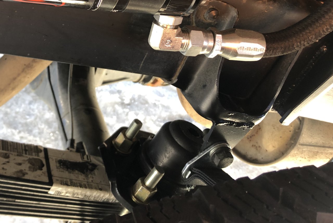

    Do I need to trim these U-bolts down closer to the nuts or are they fine as is?Screen Shot 2022-01-29 at 1.28.09 PM.jpg

    I would trim those down. Also it may be the angle of the pic but it looks like your limit strap bolt will shred that bump stop.

    With that bumpstop, you are ok to leave them

    Wow thanks, I totally missed that. I think you might be right about the limit strap bolts. Is there a better place to mount them?

    Can’t say for sure without seeing the truck in front of me but this area would probably be ok. I’ve seen others in a similar area.
