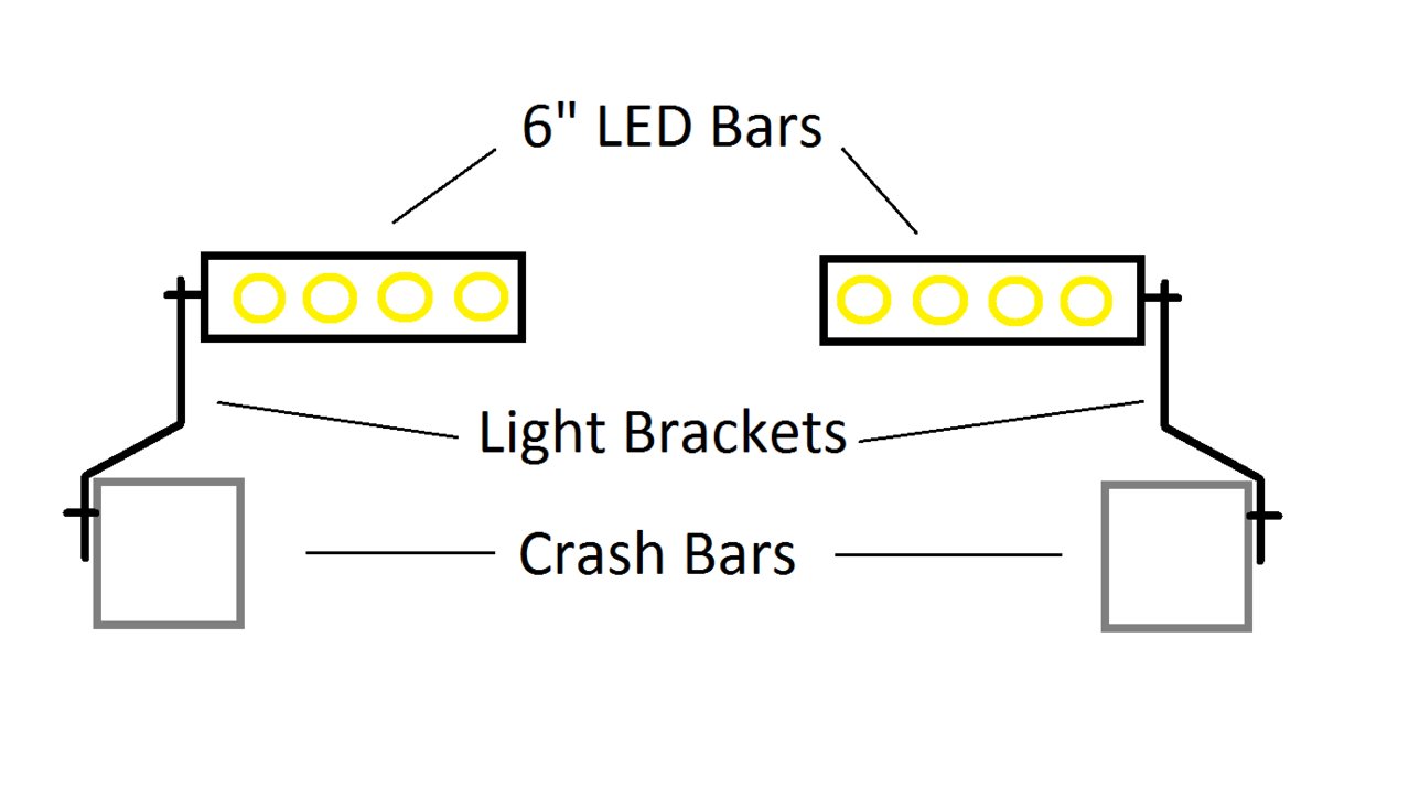

    I was wondering if anyone has ever tried running two 6" bars instead of a 30" bar using the stealth light mounts by Diode Dynamics or the Caliraised hidden mounts?
    Meaning you install the brackets as designed but instead of the 30" bar you put one 6" bar on each bracket. I know the DD 6" bars have 2 mounting holes on each side so in theory I could drill a second hole in the brackets to utilize both holes to help support the light bars since they would only be mounted on one side.
    My thinking is using DOT approved 6" bars with high beams is legal and the hidden bumper lights are a no-cut/no-drill mod. So I could get powerful high beams that help me see empty roads better, that don't blind oncoming traffic like off road light bars, keep the front of my truck looking nice, and won't get me a ticket.

    In theory this might seem like a good idea but without a bracket on the inside of each light, the brackets are just going to bend under the weight of the lights.
    It is a hidden light bar. It will take a seriously doughnut deprived law enforcement officer to give you a ticket for it!!!

    I just don't want to be the asshole running high powered lights and I'm more worried about the cop being the on coming traffic. 90% of the time I can turn the high beams off in time but sometimes a car comes around a blind corner or off a side road.
    Sagging lights is my main concern, so I figured before spending hundreds of dollars experimenting I'd ask the expansive knowledge base that is TacomaWorld

    They are either going to sag to the inside or bounce something terrible in my opinion. If you could come up with something to run between them to get them bolted together with a brace that might help.

    I could make an aluminum brace that could tie them together out of L or square stock.
    Hence why I want DOT approved light bars, they are no worse for oncoming traffic that your standard high beams.
    Plus they would be wired to the high beam relay, not independently switched.
