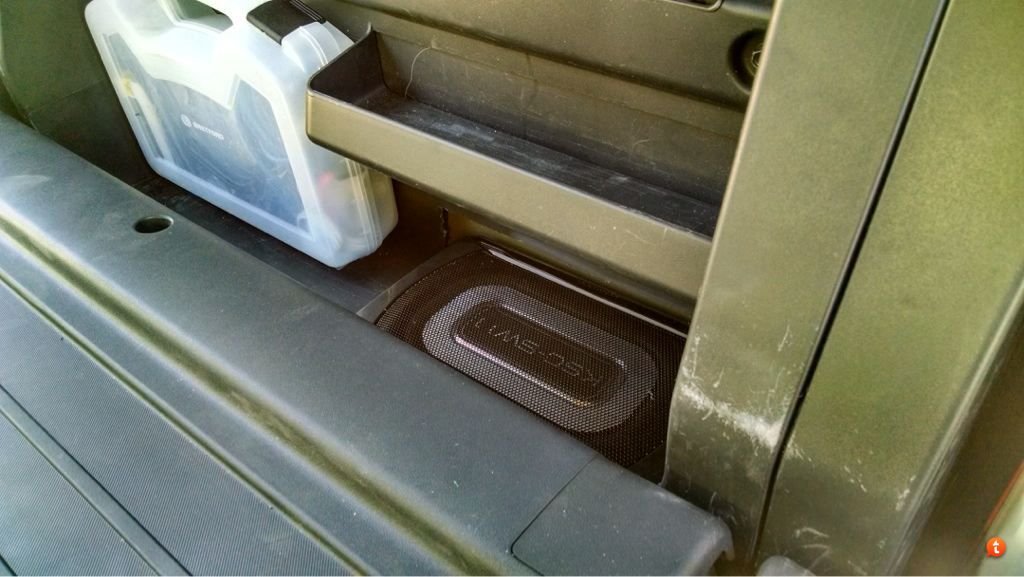

    Little sub in the back storage under the pointless shelf.

    Any more info on the sub? Install?
    Thanks!

    Its a Kenwood KSC-SW11 powered sub for $150 from Amazon. It is really small and levels out the music just right, unless you listen to rap. Its more of a mid-low sub, nothing truck rattling.
    The install was just like any amp. I took the storage bins out then bolted the sub down to the metal. Then made a cut out in the bottom of the storage bin so I could place the bin over the sub. The sub came with all the wiring you need. I just picked up a add-a-fuse and some T-taps.
