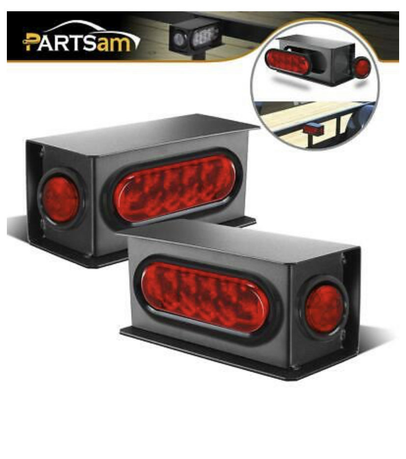

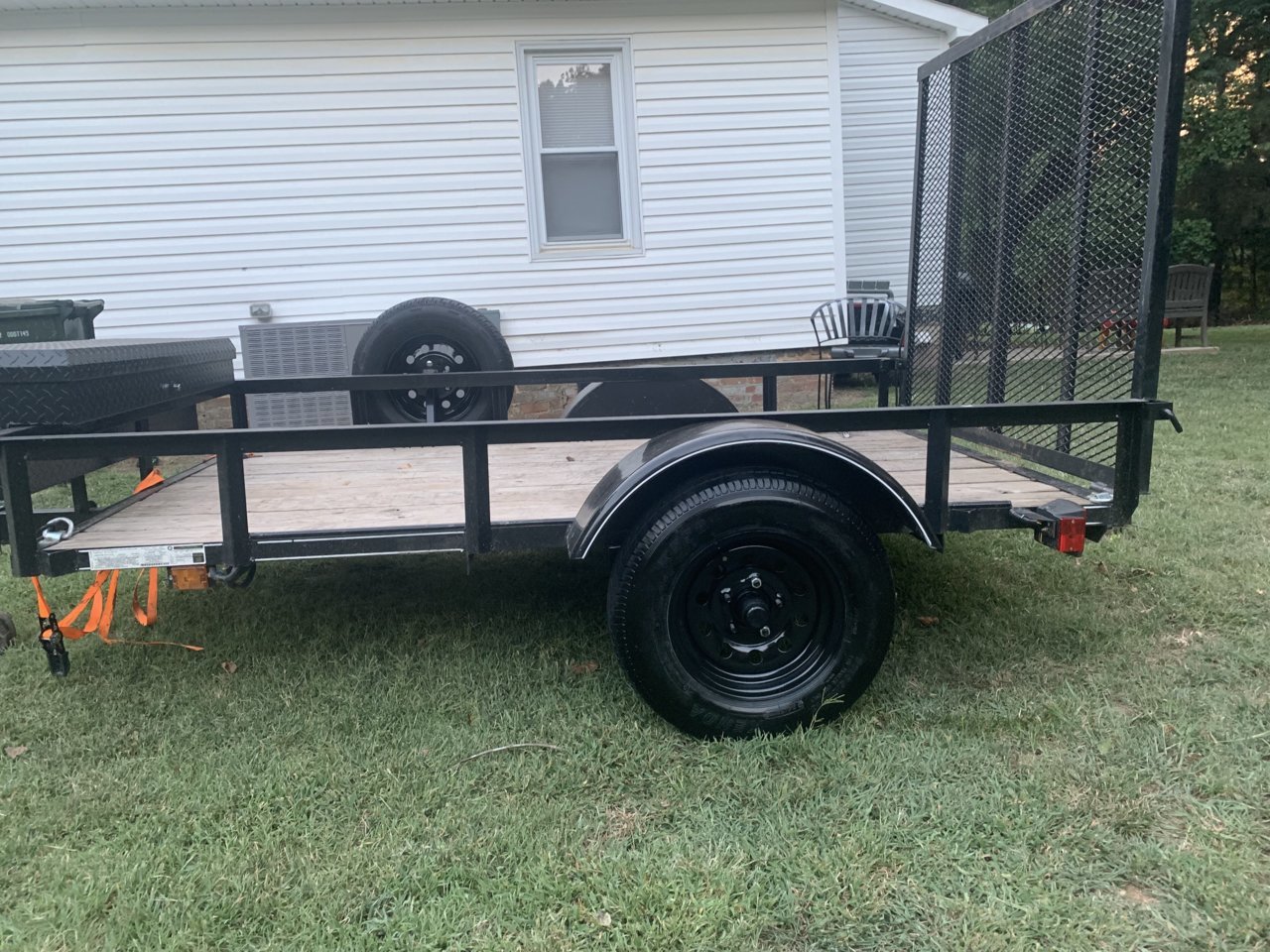

    Recently been redoing some things on my tractor supply 5x8 trailer, fixing the things I don’t like. This trailer is only used to haul my four wheeler and lawn mower no off-roading or anything. Been looking into upgrading the brake lights to something more heavy duty. I’ve busted 3 stock lights and my son has busted one.
    Now to my ??
    My lights have two wires going to them, but all the kits with the light box and lights seams to have 3. Do I have to rewire the whole trailer or how do I wire them? The lights I have now have two wires and the lights work and so do the corner lights on the light housings. If I replace them with the box lights how would I wire the round light on the side?
    I attached some pics
    And yes I’m missing some lugs. Was waiting on my chrome closed end lugs to come in but had to put my freshly painted black wheels on to see how it looked

    Your current lights most likely ground by being screwed down to the trailer frame you can just find out which wire on the new lights is the ground and screw it into the frame.

    i would verify how the lights are grounded, quick cheap and easy are how one trailers are done.
    so you’ll have one wire for running lights, one for turn/brake, ground point will be off the pigtail at the light to the chassis of trailer.
    While the chassis ground is “ok” and works, the more reliable would be the have chassis and a ground wire to each light. more time, more material, but more bullet proof and easier to diag when stuff isn’t working.

    You are not gaining anything by running a dedicated ground to each light. Just ground each light to the frame near were the lights live.
    If you use those boxes and ground the lights, they will be the last set you buy.

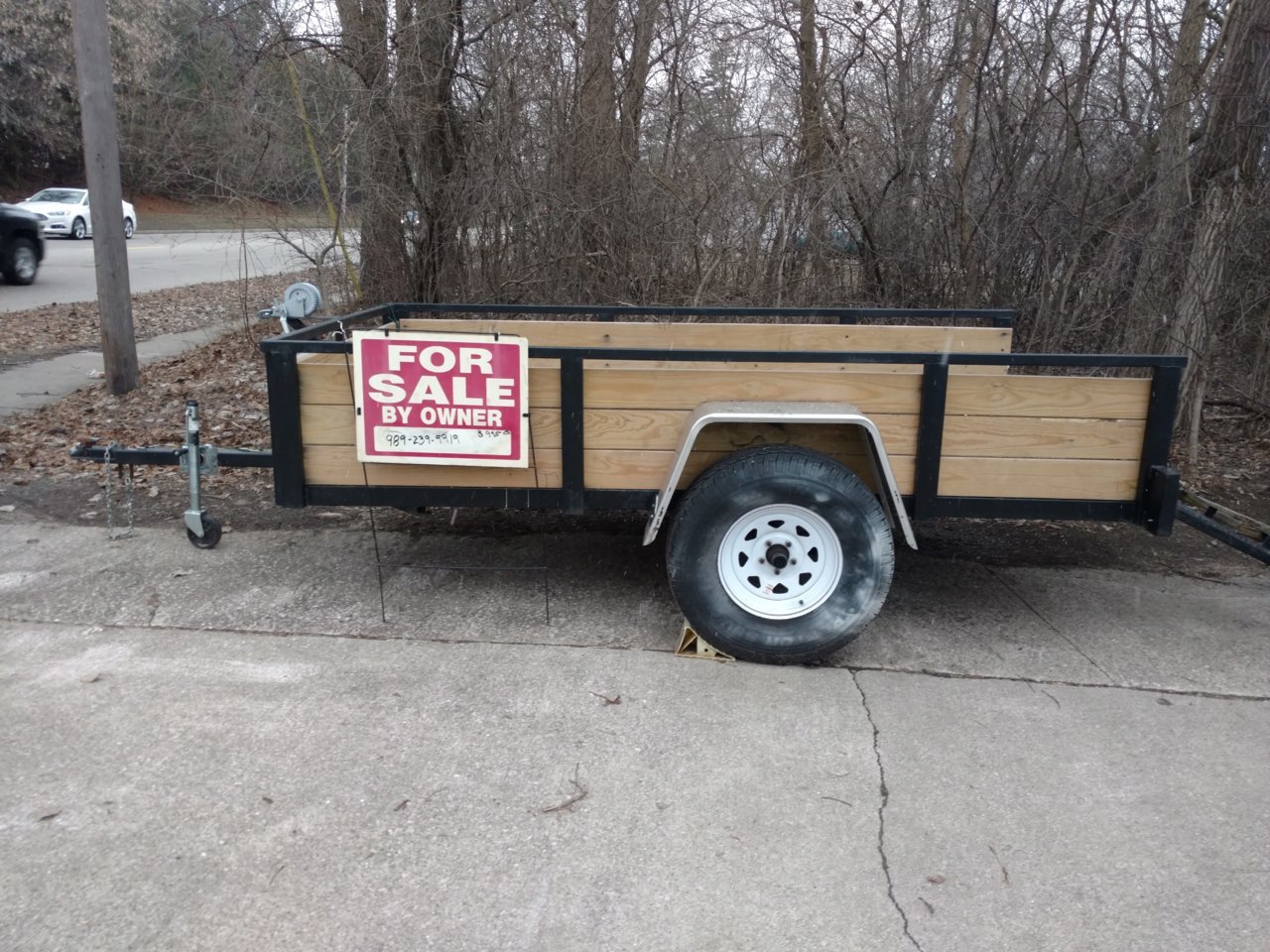

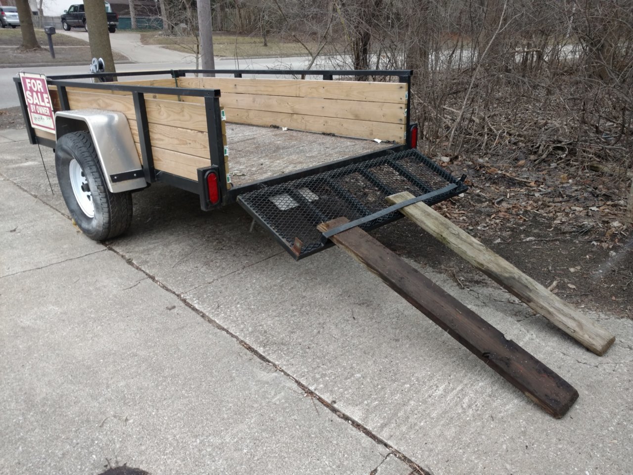

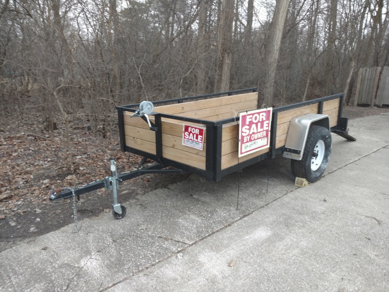

    I've built around 300 of this style. I lost track around the 5th receipt book.IMG_20170225_162519.jpg IMG_20170225_162512.jpg IMG_20170225_162505.jpg
