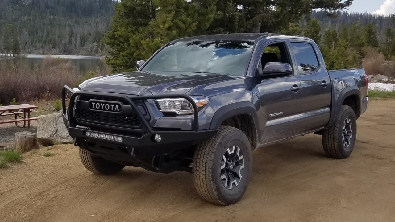

    Was wondering what you decided and how it turned out. I’ve got the low hoop option ordered and going with the same fire size. Considering new leaf springs for the reason stated above but I rarely haul anything besides a few bags of corn and a dead deer if lucky.
  9. Jan 27, 2020 at 6:16 AM
    TexasTacoma713
    TexasTacoma713 Well-Known Member
    Oct 19, 2015
    #167065
    1,721
    PNW
    2024 OR
    I got a cbi steel front too. Running Bilstein 6112 with 700lb springs (highest notch on driver side), Dakar rear leaf pack with Bilstein 5160 and SPC UCAs. Rides great. 265/70/17 nitto ridge grapplers if your wondering too
