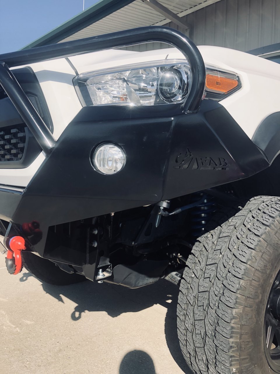

    If anyone was wondering, I ended up going with a semi-gloss powder coat and am really pleased with the end result!
