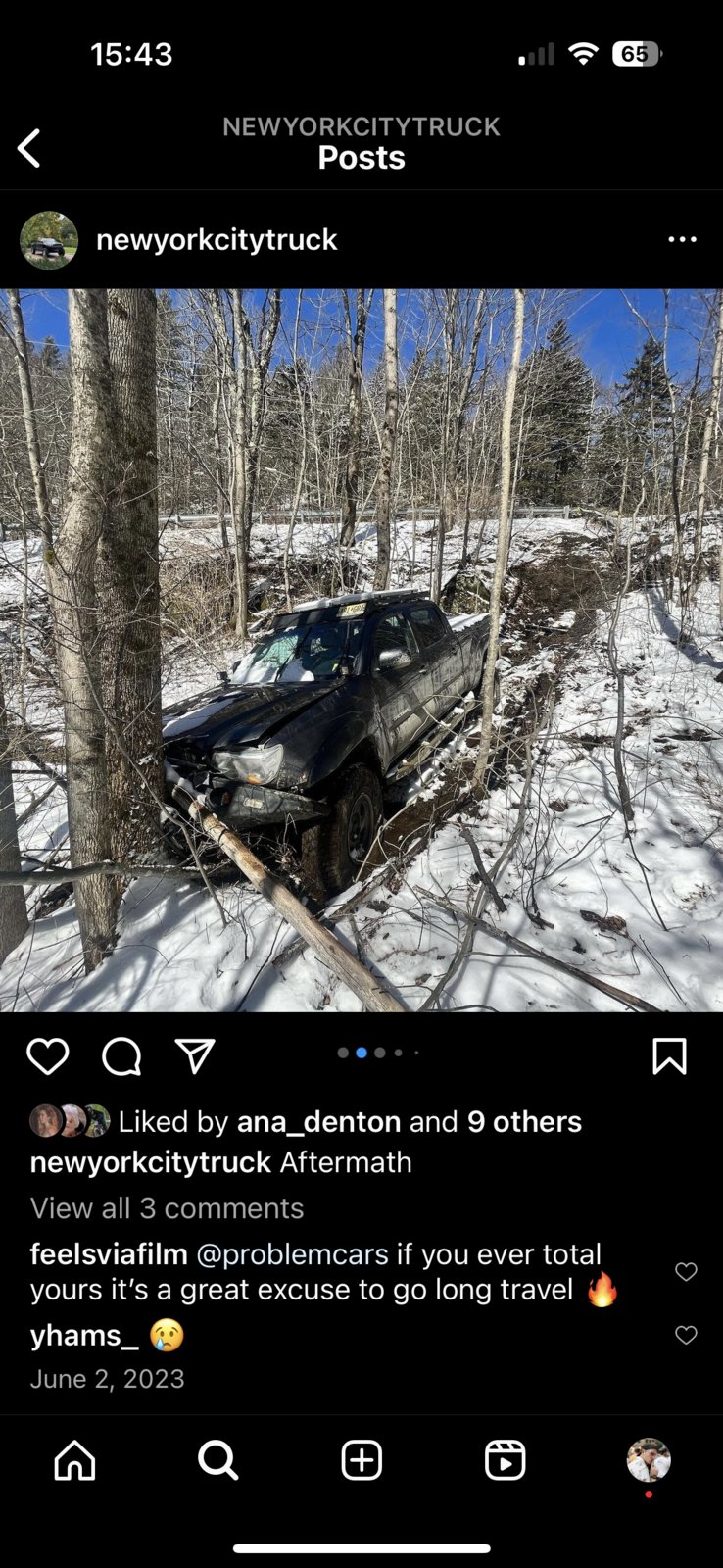

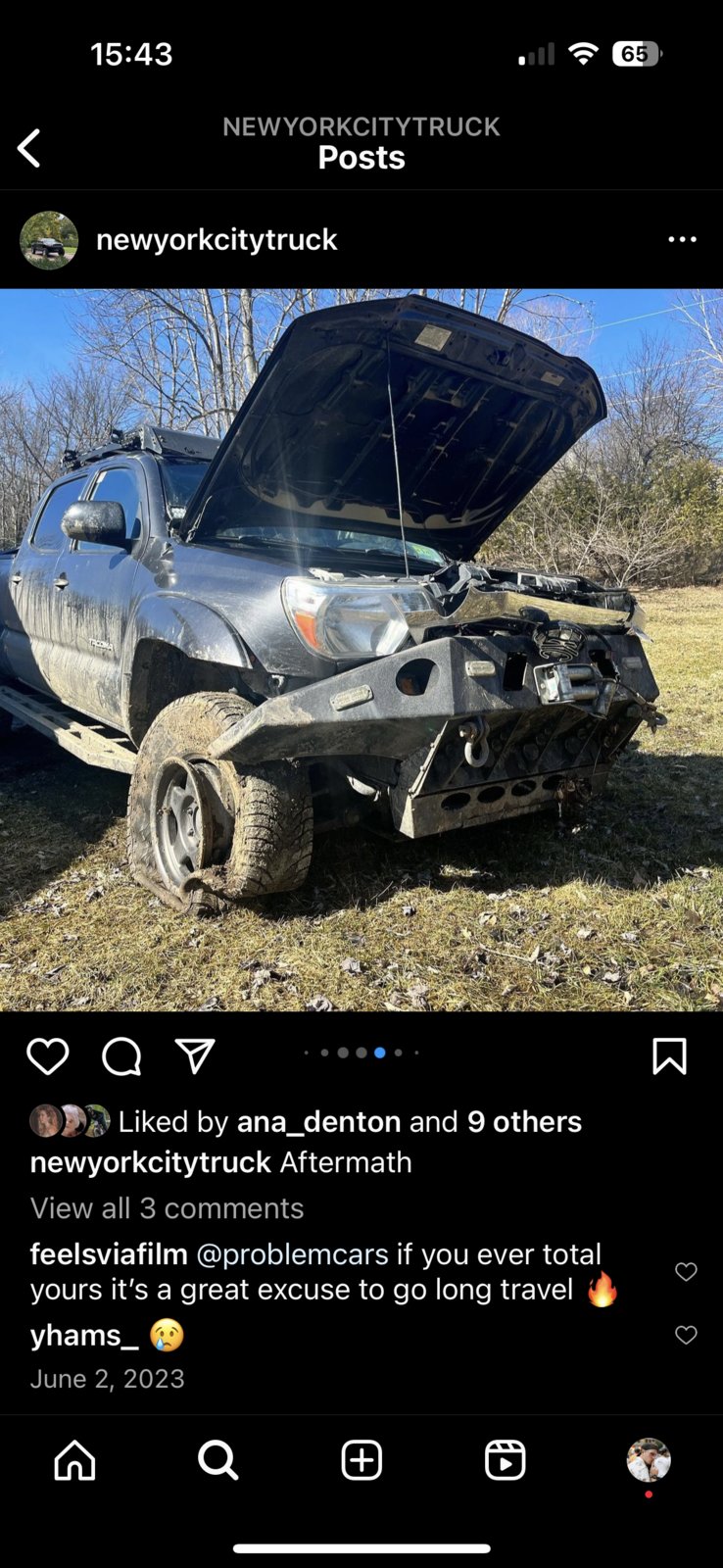

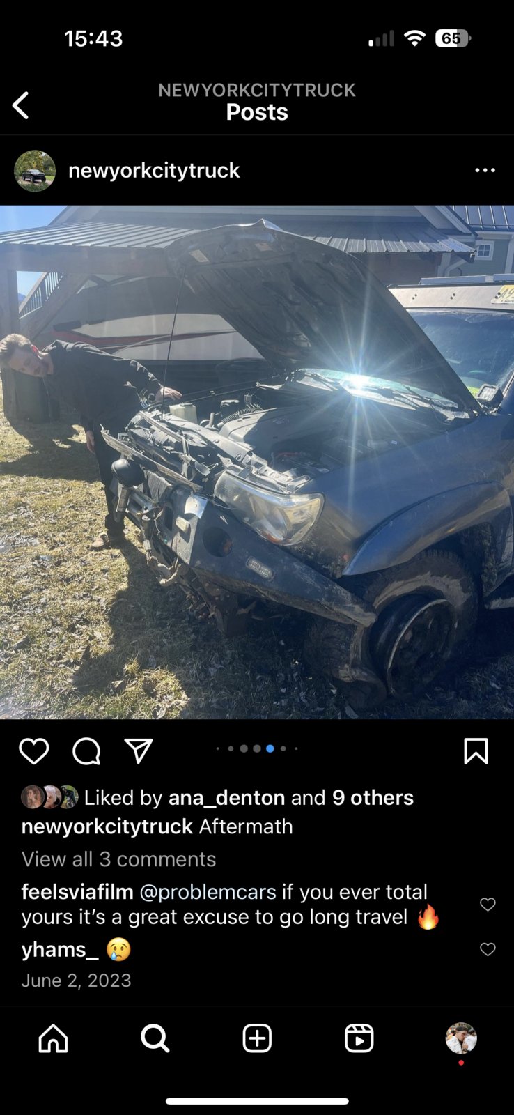

    Pro's and con's....everyone's opinion and desires will be different. I drove my truck off the road and thru a guard rail into the trees in the snow at 30mph and hit a 12" tree dead on. My bumper took it dead on and I was safe (although no airbag deployment which is sus) and the bumper folded back and wrecked the fenders and core support but the frame was safe. Might have been different if it wasn't a dead on hit front and center.IMG_9938.png IMG_9939.png IMG_9940.png
