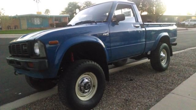

    You would probably have to get wheels from a 1st gen Hilux/Truck (79-83) if you're after stock wheels with hubcap clips. Realize that these have a lot less backspacing than Tacoma wheels and are 15" diameter. If memory serves they are 5.5" wide with 3.25" of backspace, so not sure if they would work on a 4wd Tacoma, IOW whether they would clear the brake calipers or not.
    You might have to look for GM wheels with a 6 lug steel wheel that's 16" diameter and can accept hub cap clips.

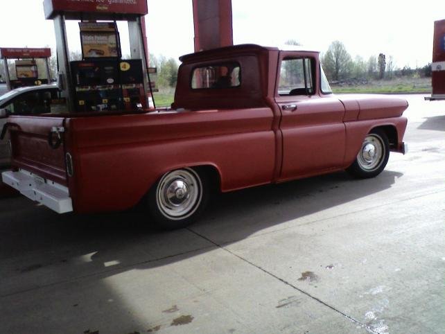

    I assume he's going for this look.
