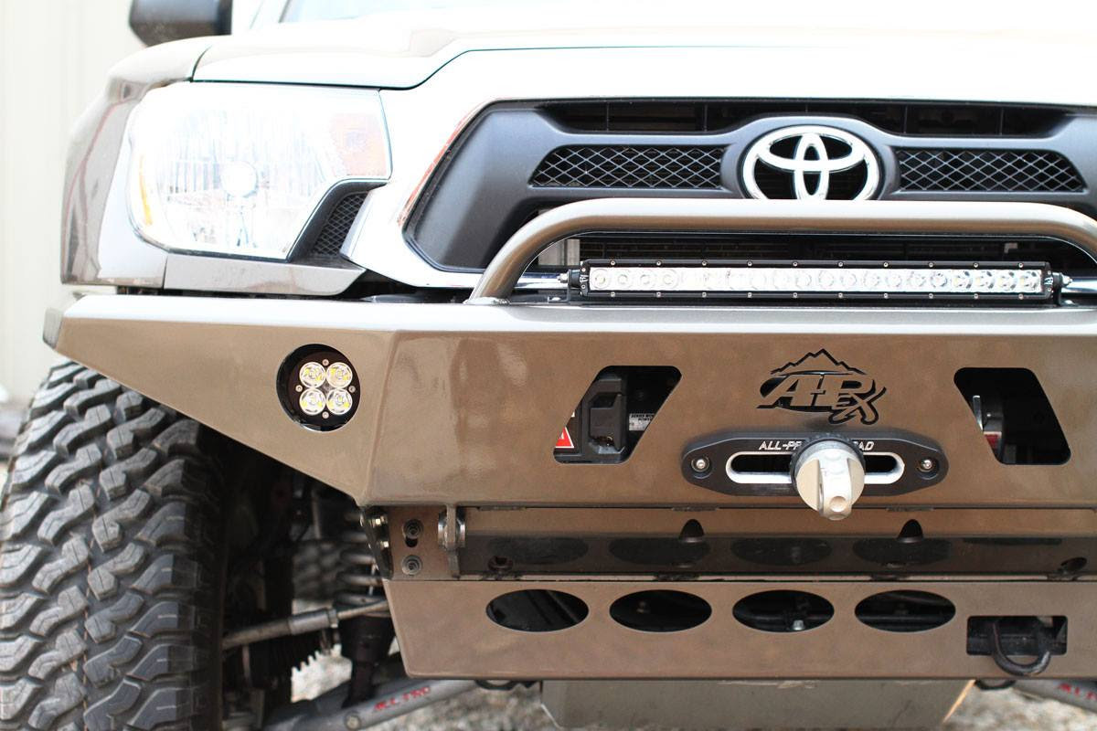

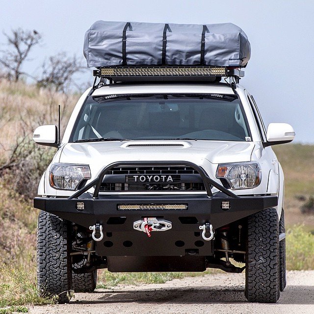

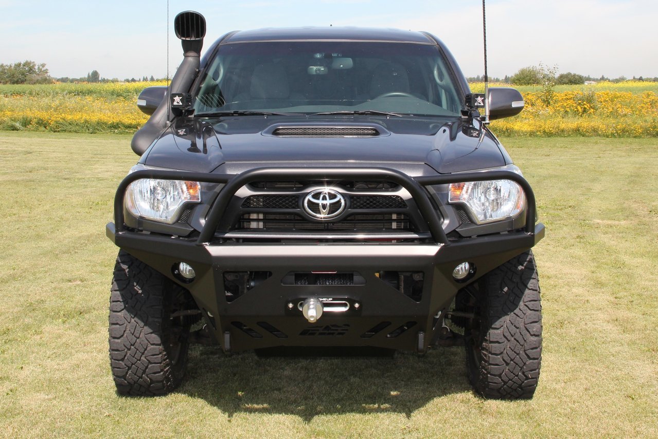

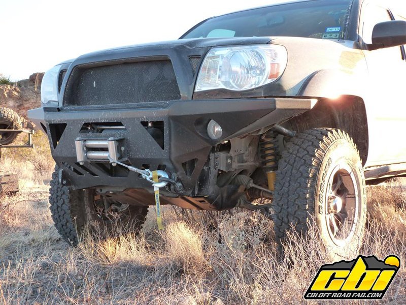

    After just getting nudged by another car it's obvious the plastics gotta go! So need some opinions.
    There are obvious pros and cons with each and im sure everyone has their own reasoning why they went with their particular setup. Whether it be strength, weight savings over cost savings, corrosion resistance whatever. Just wondering what you're running and why you chose your bumper. And if you're happy or wish you'd gone the other route. Was thinking aluminum but now im not so sure. Thanks!
