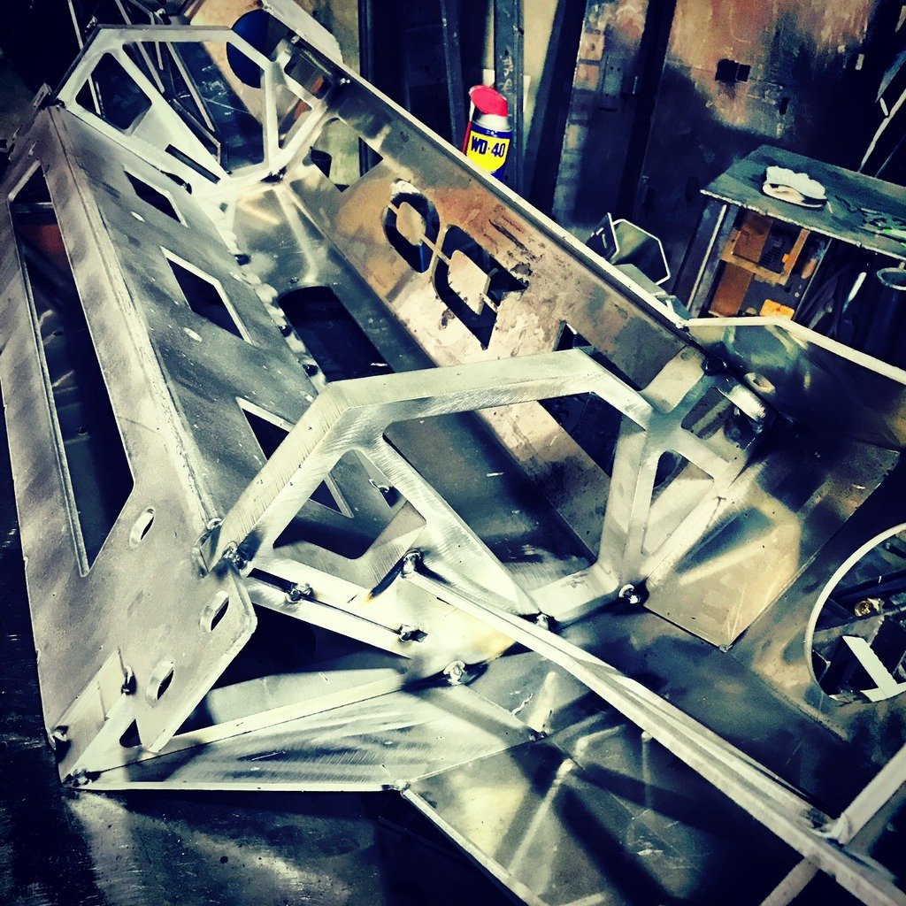

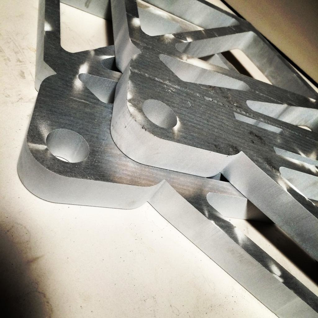

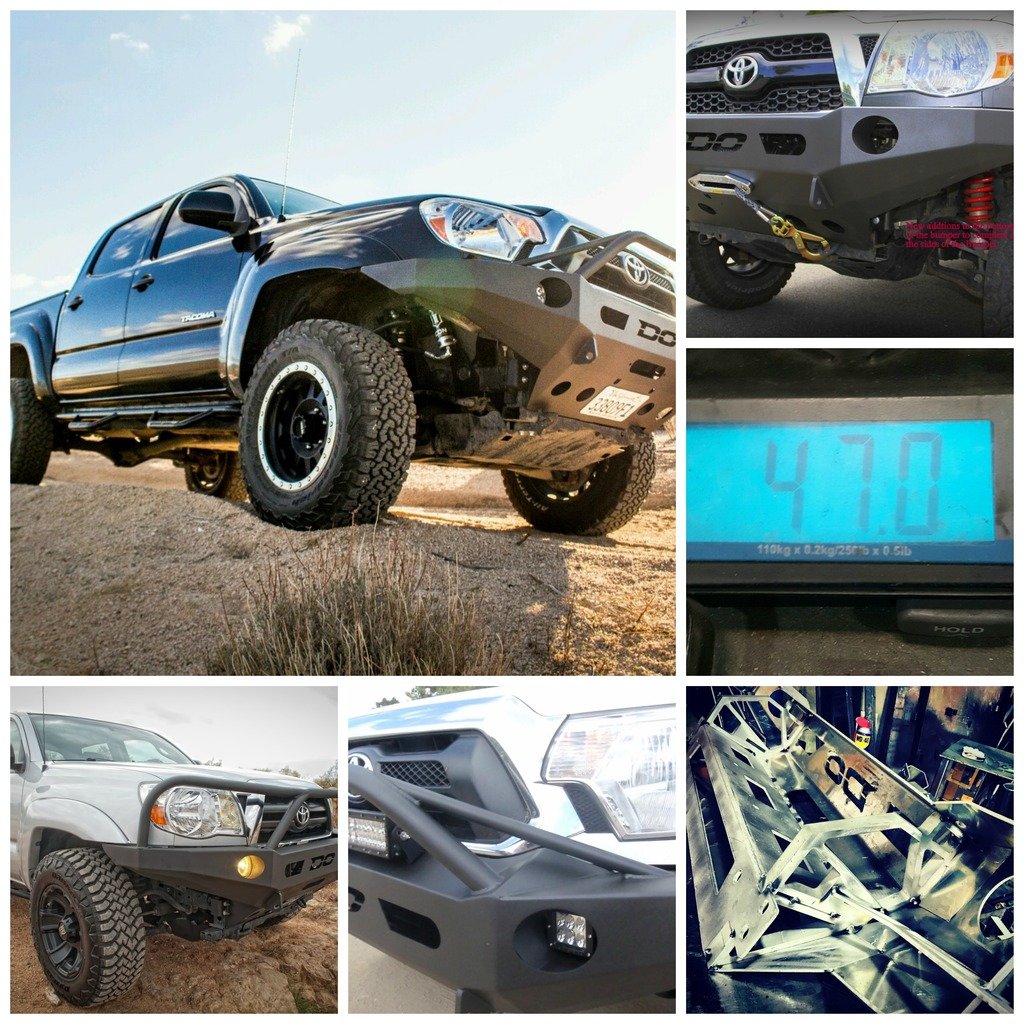

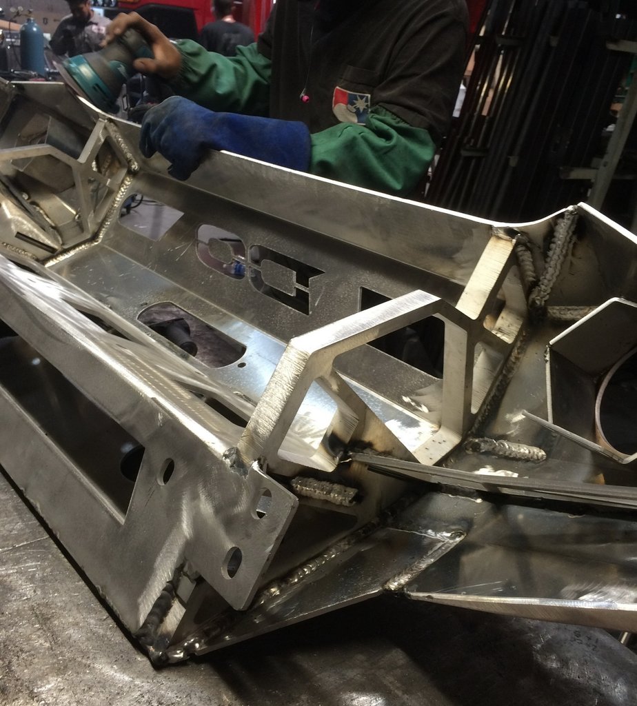

    Throwing our hat into the ring. There are a lot of good choices for from bumper.
    We feel aluminum is best used for a more overlanding type of wheelin. Rock crawlers and heavy trail use should consider steel bumpers. That said we build both the same, just with thicker metal but being that we know aluminum is the future we started redesigning our bumpers from the inside out. We wanted to make sure when you pull on the bumper it pulls on the whole bumper. You can see here the inside of the bumpers and how the shackle isn't just welded to the front it's welded and key locked into the whole inside structure.
    As far as crash test go, we've been doing this a while and have seen plenty of accidents with our bumpers and other makes of bumpers. They all seem to fair well. I believe ARB bumpers are stout but they get their Air bag compliance from a series of "collapsible" mounting points. We as do other US manufactures sacrifice the air bag compliance in favor of ground clearance and approach angle. In short, there are a lot of good choices, go with which one you like the best:)
    Shackles 1in thick aluminum.
    up the skirt shot.

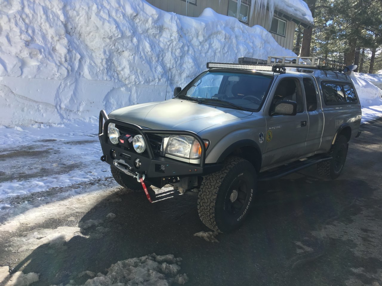

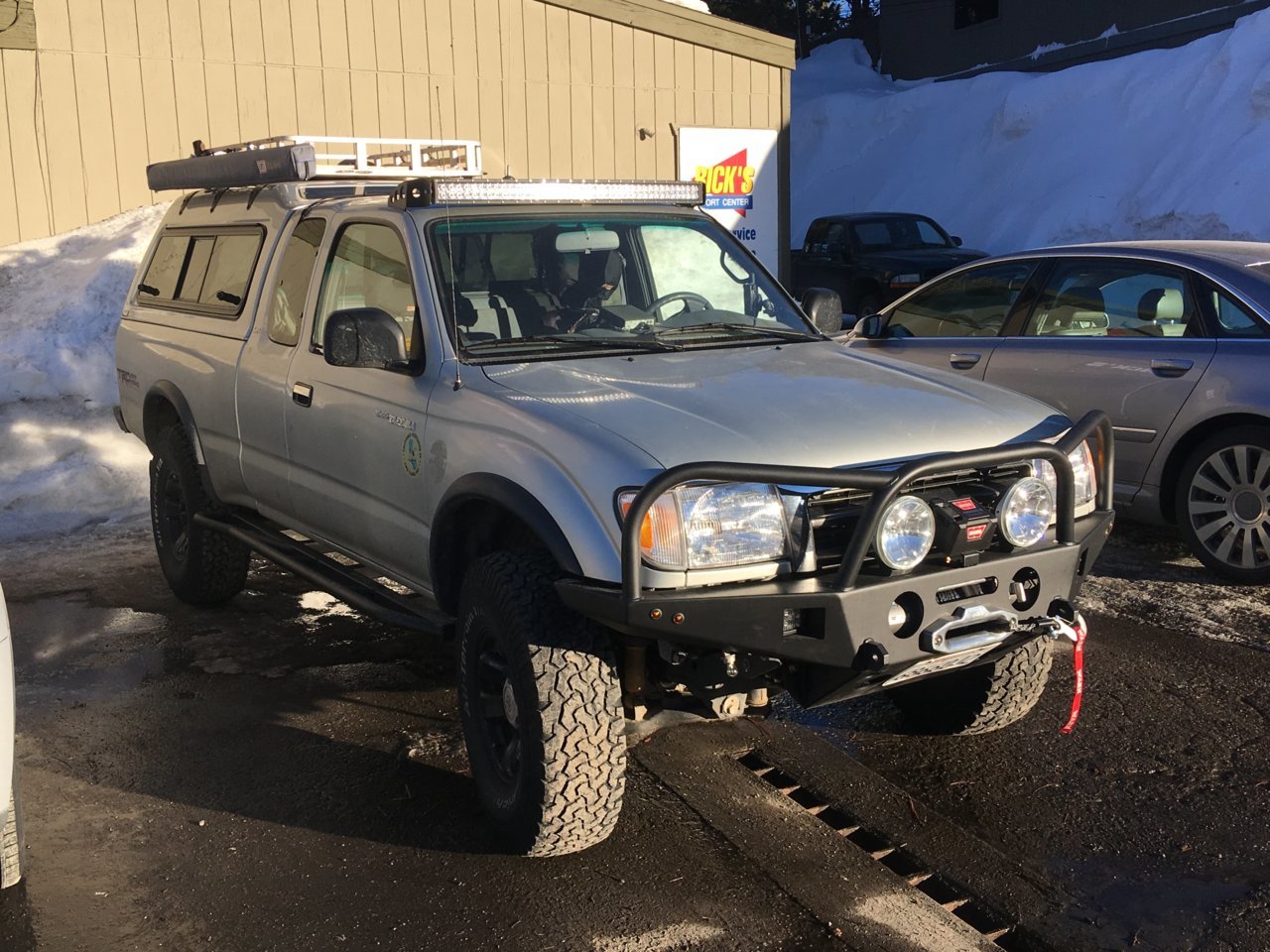

    Yup, aluminum is plenty of strong if built right. He has my old bumper, you can see the passenger side recovery point bent over from an accident I had where I T-boned a guy who ran a stop sign in OR. Bumper saved my ass and besides the one minor issue the aluminum held up just fine. I put that bumper through its paces, Insurance paid for a new one so really thats the only reason I got another one. My wife rear ended someone a couple months ago and only a couple of scratches were had
  11. Feb 23, 2018 at 5:15 AM
    #31
    Toyotico
    Toyotico Well-Known Member
    Nov 9, 2017
    #235532
    563
    Jonny
    Cartersville, Georgia
    2017 Silver Tacoma 4x4 dclb
    @ChandlerDOOM , that’s what I’m talking about. I was thinking “are the hoops gonna bend back if I bump into a tree?” Thanks for the picture.

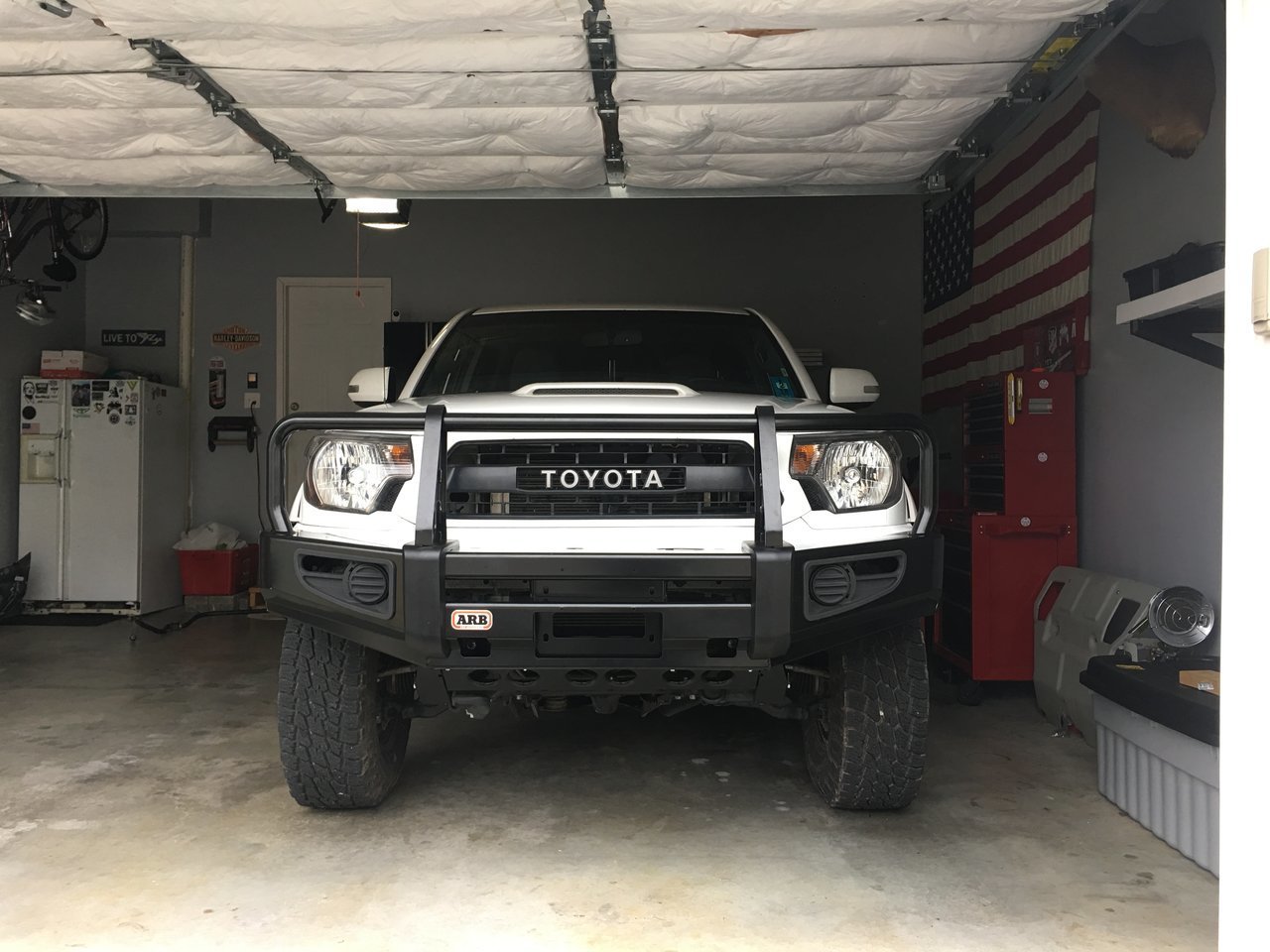

    Anyway, I got ARB and am very happy with it. That being said, pelfrey aluminum was at the top of my list until I got a deal I couldn’t pass up.

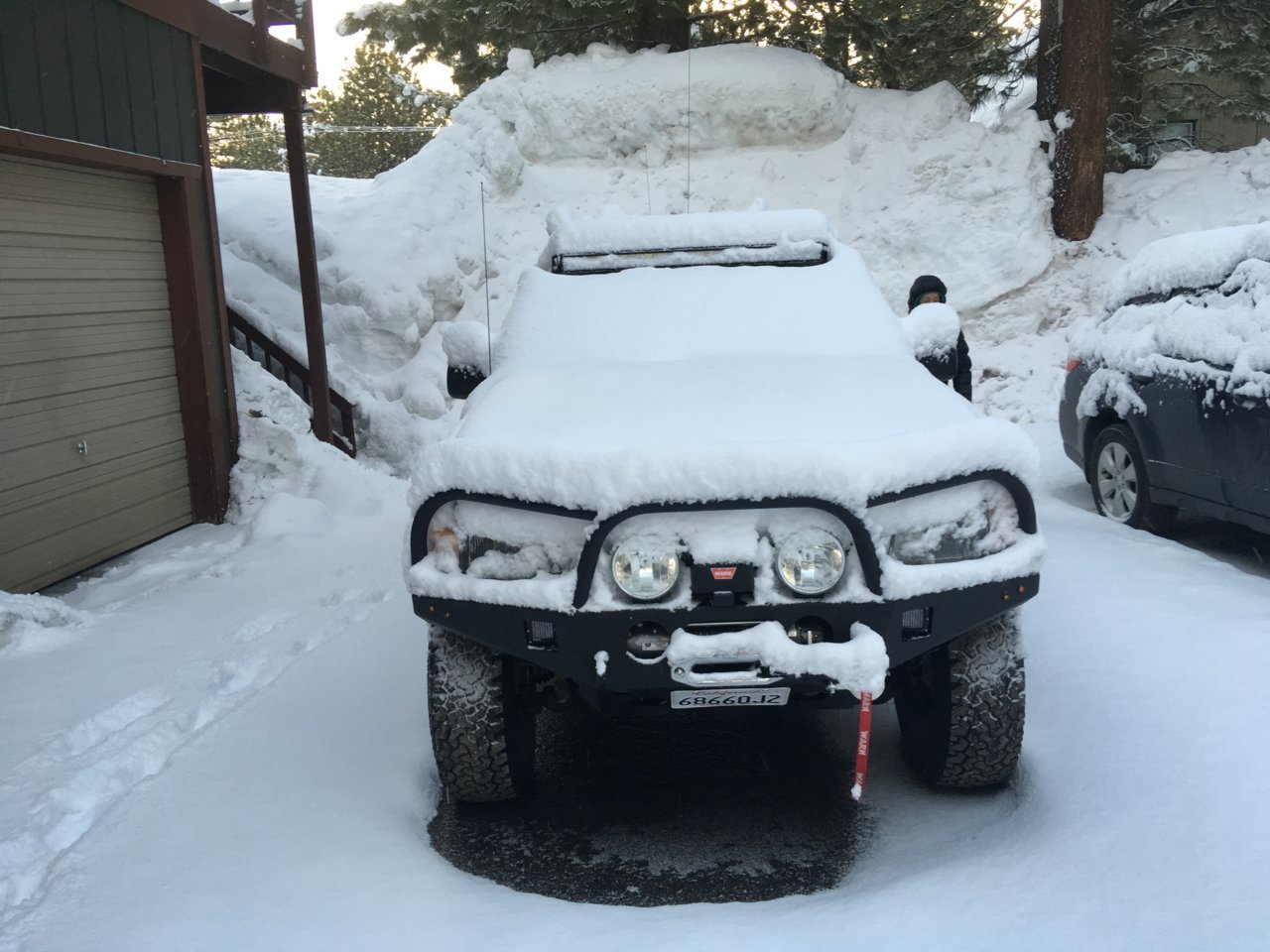

    @RelentlessFabrication ‘s bumpers have such a good look to them and are very well built. IMO way better looking than the ARB and just as burly, hard not to pass up.
