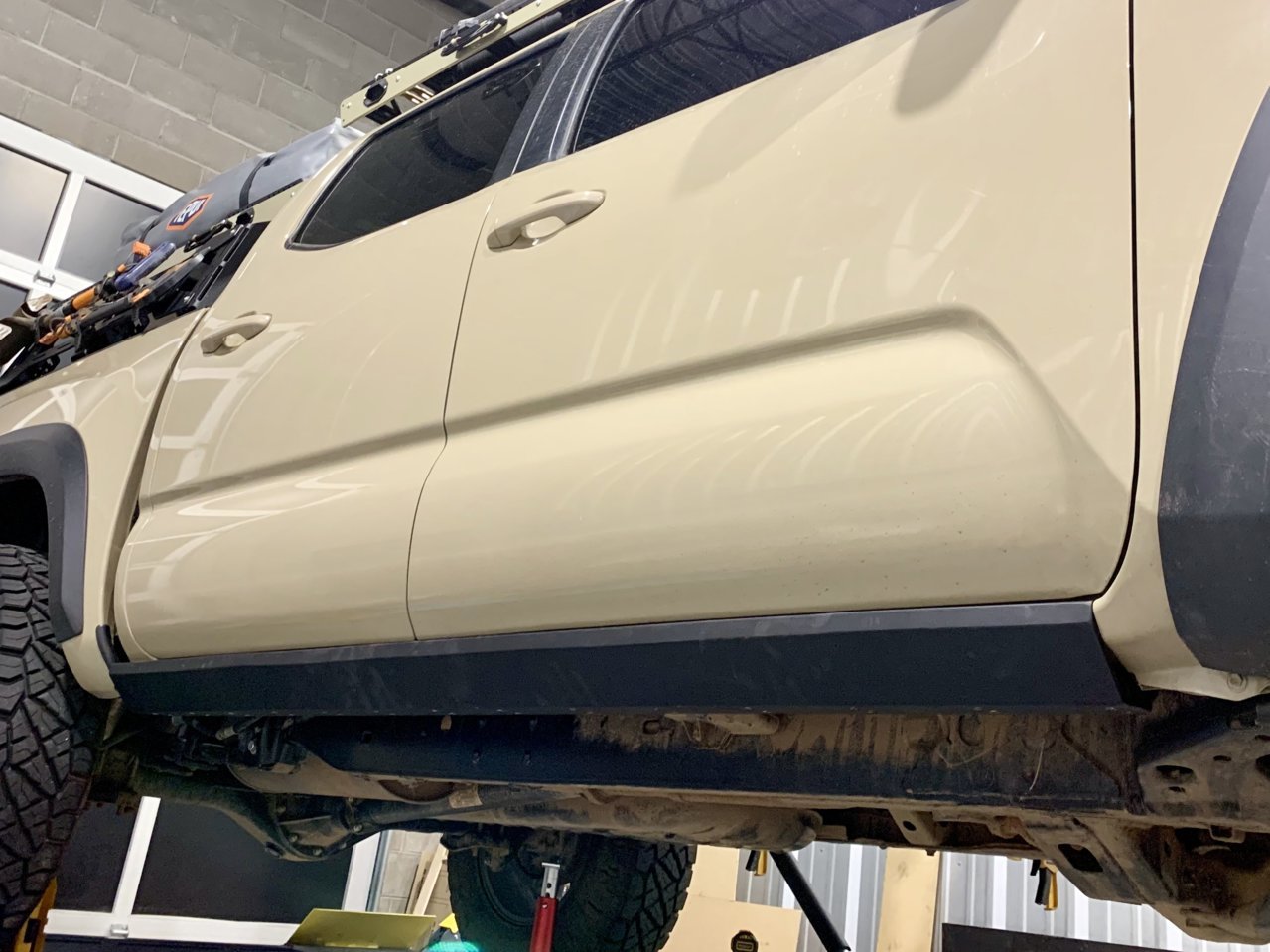

    I think you’re going to see something coming from the guys at @upTOPoverland in regards to this. It won’t be like traditional sliders.. it’s more like body protection.... pretty slick stuff if you ask me... and I’ve seen these guys go wheeling. They go on some pretty rough trails. Currently they’re in MOAB- I’m stoked to see how they hold up

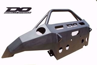

    Just order an Aluminum Tacoma Baja front bumper with Center Hoop from Demello Off Road. Place the order with State 48 Overland, Erik hooked me up. Can’t wait to get the bumper installed.
