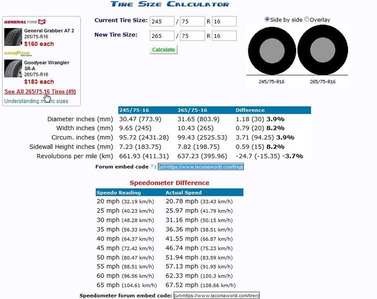

    Really? You see .5%? One half of one percent? My guess is, yer not a math major. The difference in circumference is 3.71" OR 3.9% which IS a significant amount. See the chart below for the geometry challenged.

    You really didn't put a bigger tire on your truck in means of height because you only gained about .05" in height, all you gained was the with from a 245 to a 265.......... This post makes me confused LOL :facepalm:You should have went with a real tire and went with a 265 75 16......

    He was talking about 245/75r16 vs 265/70r16, so yes a .5% difference in diameter. Reading Hard

    Awww....so cute when they think there is a gotcha moment. No reading comprehension isn't hard.... missed the 70 vs the 75. My bad and apologies.
    However I wasn't the one that floated the original conspiracy premise. Nor did I confuse wheel diameter with tire OD and circumference.
