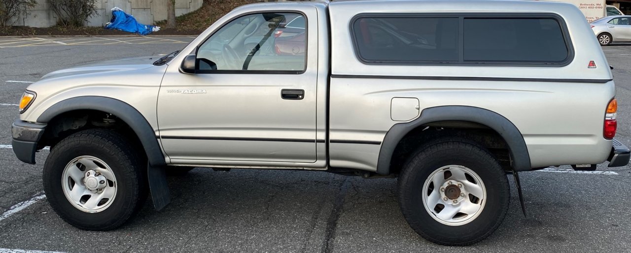

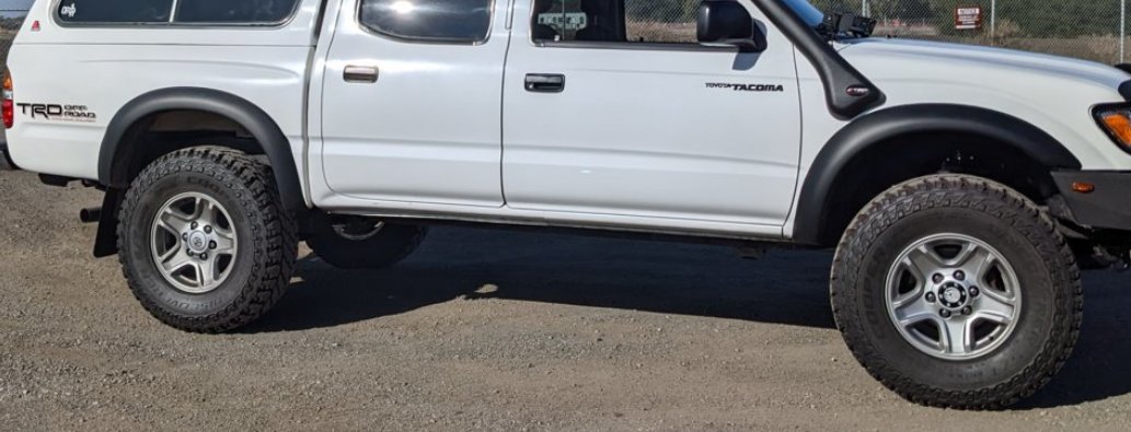

    Hi all, new here. Been on the hunt for replacement steel wheels for my 01 prerunner regular cab, but no luck so far- the two options I've tried (Pro Comp Rock Crawler and Black Rock Series 929) rub against the caliper or are too close for comfort. Pro Comps had -6mm offset and 4.25" backspace, and Black Rocks had +13mm offset and 5" backspace. I've been told aluminum construction wheels would fit but I prefer durability of steel, and would like to avoid spacers. Running dueler A/T tires- P265/70R16.
    Stock steelies I have on now are fine- couple missing hubcaps that I'm tired of replacing and a little surface rust....if I can find new better looking steelies that don't rub against caliper and drive the same, great.
    Anyone else with a similar search? Better off going OEM instead of aftermarket? Suggestions welcome. Thanks in advance. IMG_1214.jpg

    7
    I have a set of those wheels collecting dust in my shop..
    I also wouldnt be scared of an alumimum rims
