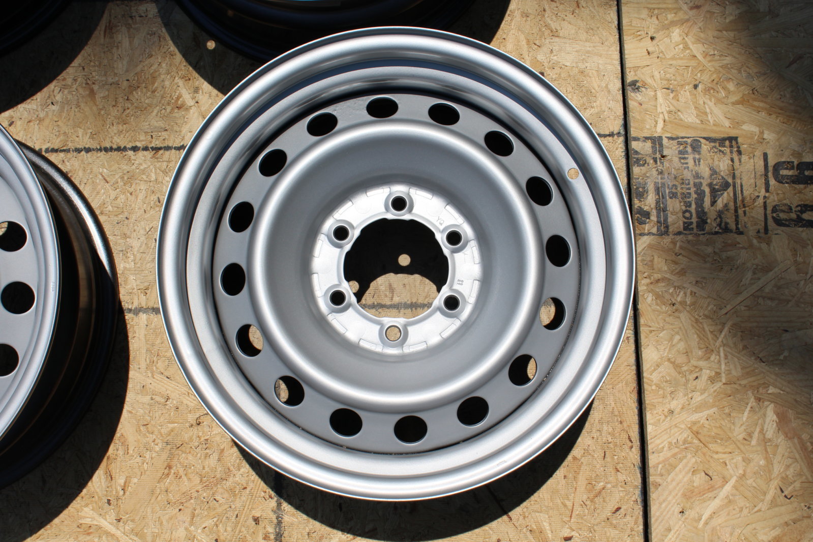

    All of the Toyota center caps for steel wheels sit in notches in the center hub area of the wheel. When you put the wheel on the cap pinches between the wheel and the center of the hub. The 16" spare wheels do not have these notches. Any "styled" steel wheel from Toyota has those notches. The OEM 17" FJ Cruiser steel wheel also has those notches. The aftermarket equivalents do not.
    If you see in this photo the center bore is not rounded, there's notches which is what the center caps sit in.
    Be aware that when you fit the center caps with these wheels the space between the center cap and the lug nut is VERY tight if you use the standard steel wheel nuts, at least in my experience. I needed a standard thin-wall socket to get them on and off, a regular lug wrench surely would not fit down there.
    I suppose if you got creative you might be able to notch a stock 16" spare wheel to fit the center caps, but I wouldn't be so certain.
