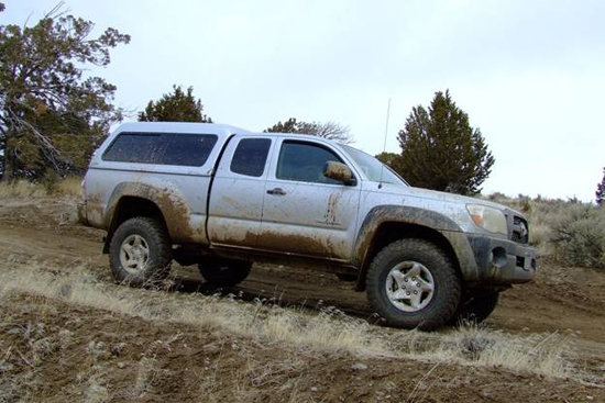

    What size/offset wheels would I need to replace the stock TRDOR wheels? Not looking to upsize...
    Also, are there any basic steel wheel options for TRDOR? Just the base utilitarian style steelies. Where to buy?

    Your pic is of a 2nd Gen but this is in the 3rd gen, which do you have???

    Currently have 2nd Gen base regular cab 2wd. In the market for a 16+ TRD OR (and keeping the 2nd Gen). Exploring upgrade options for the future TRD OR.

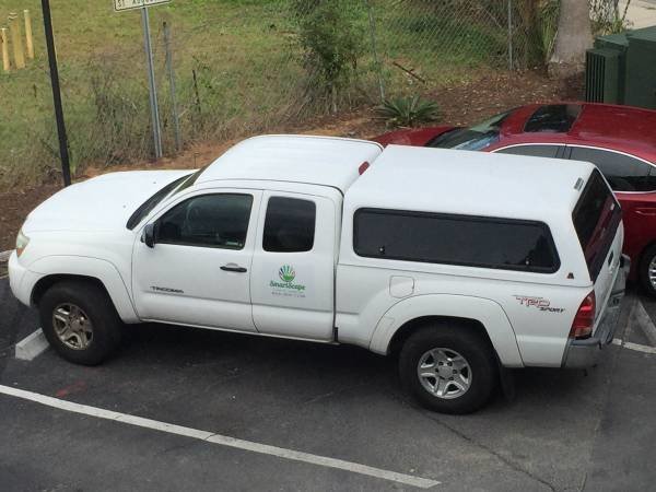

  7. Sep 26, 2017 at 1:22 PM

    What you linked to are the 16"x7" spare steel wheels. Couldn't say on the 16+ but they work fine for every day use on the 05-15. You can identify them as 16" Tacoma spares because they have an oval hole by the valve stem. FWIW, they are about $100 from the dealer brand new, painted black. So make sure you price used and aftermarket ones appropriately.
    I've personally collected about half a dozen of them to use eventually, after I get around to powdercoating them. I actually wish I'd collected the 16" steel spares from the 1st gen Tacoma instead, since they have a little less backspacing and would push my tires out a bit. I run 235/85R16 and will put 255/85R16 on the steels. Since they are tall and skinny pushing them out a 1/2" would look better I think.

    Yes, the ones I saw did have the oval hole by the valve stem. All other holes were circles.
