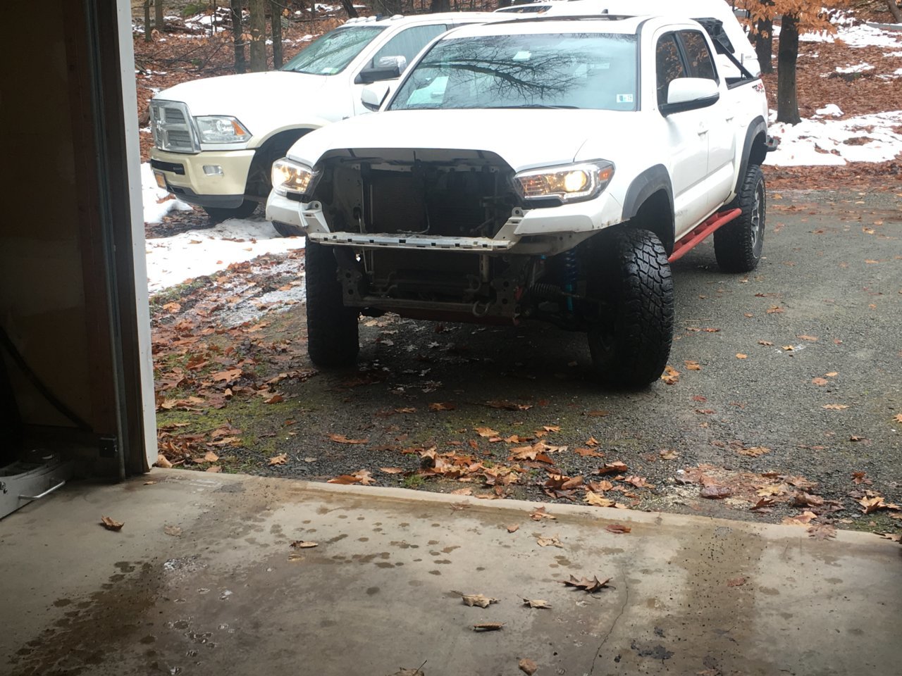

    Ten minute bumper removal.

    Yep and a little paint touch up since it's off.
    I think I'll notch and drill a hole in my king resi mounts to install those side braces.

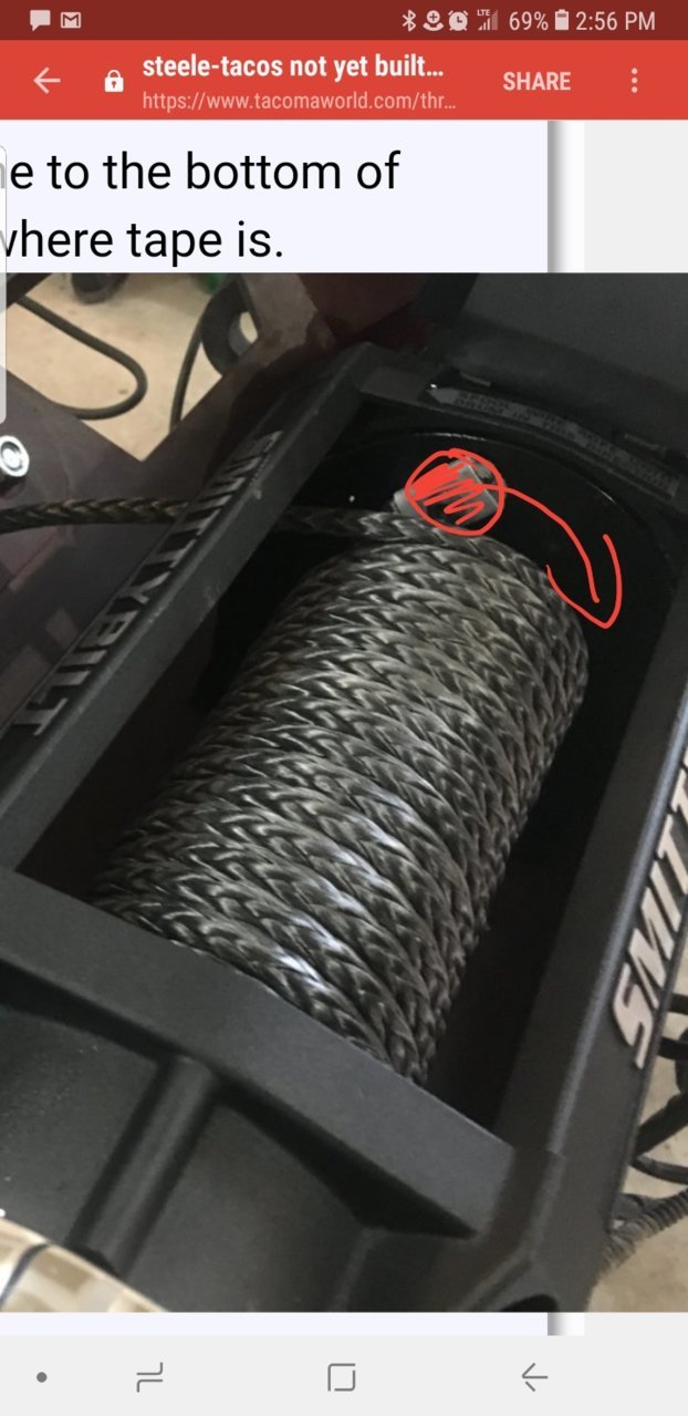

    So when I hit IN winch spools line to the bottom of drum, and line rubs on bumper where tape is. image.jpg
    Not sure what to do?
    A. Leave it as is and just know my controls are reversed, IF the gears are equally strong in both directions ???
    B. Flip winch around. I think that would work. And would put my control box closer to the battery.
    C. Call tech support.
    @stairgod @HolyHandGrenade @Subway4X4
    @Redmann didn't you have this same problem?

    You spooled the line wrong. Take it off and redo it the other way. After you attach the nub on the end of the rope, it needs to go over the top and towards the back, with the length of the rope coming from under the drum.
  18. Nov 27, 2018 at 11:54 AM
    #278

    Ah... that will do it. I didn’t even notice.
