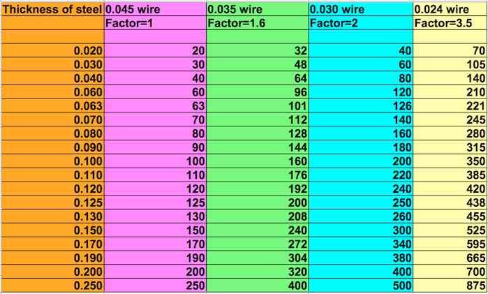

    I'm new to welding so I needed something to help me understand picking settings better lol. Found this chart on weldingtipsandtricks on YouTube that helps you pick settings based on wire feed speed. So I measured out all the settings on my machine.

    I go by weld profile and how it sounds. But been welding for a bit so I kinda have a feel for it, as will you given time.

    Yeah I hear that a lot. Just needed something in data form to help me understand it a bit better now. I'm only 2 months in haha.

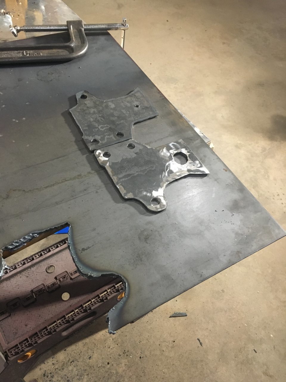

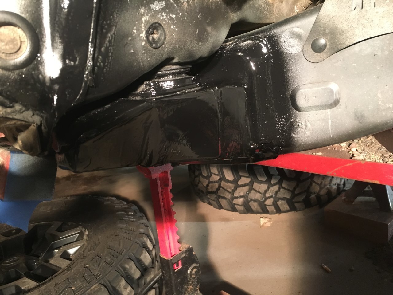

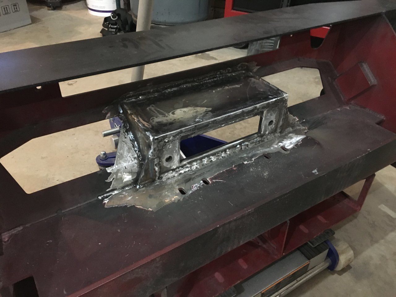

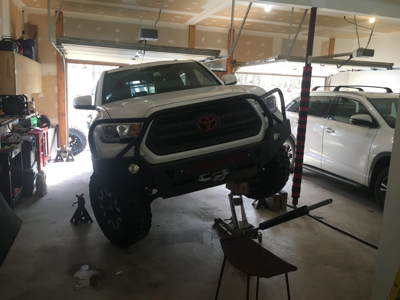

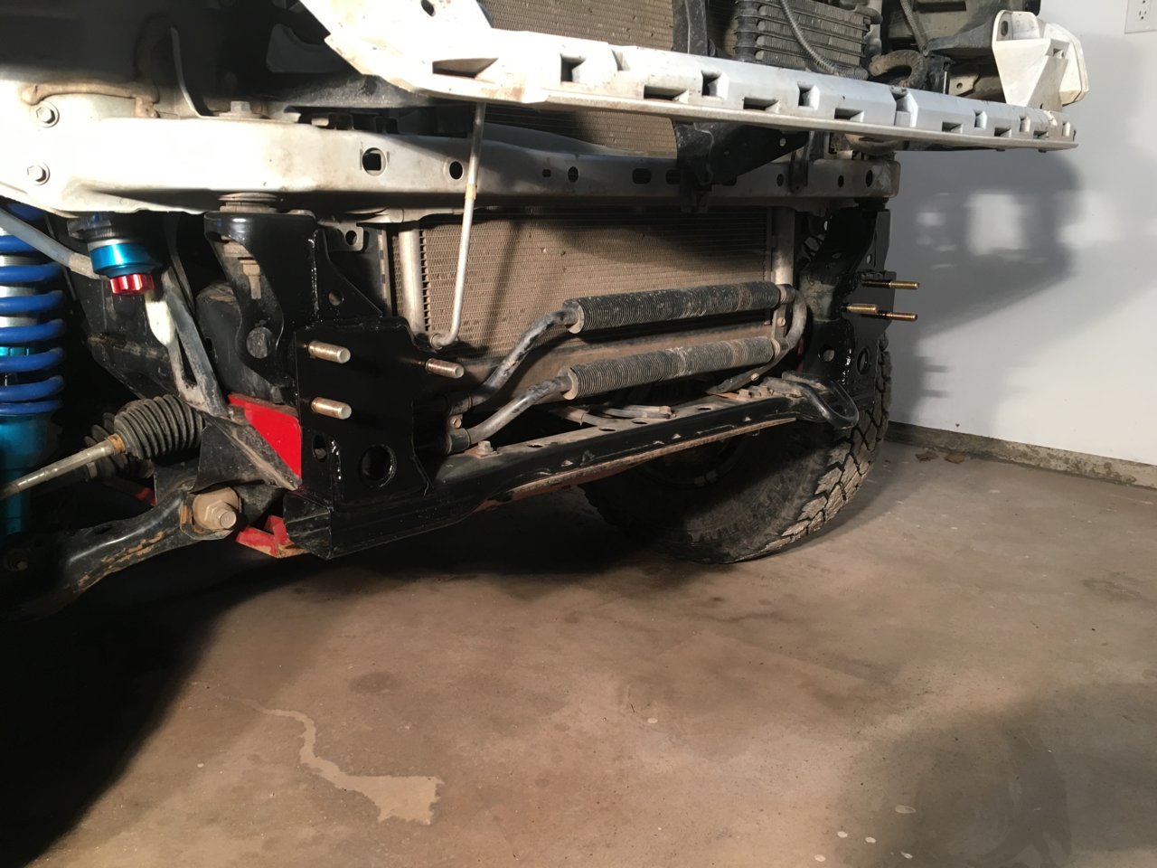

    Thanks just got the cutter today. Played with it for 5 minutes, ate some dinner and cut those out.
    I probably don’t need them with the extra braces, but had to cut something.
    Redmann, WBF610, Grand dude and 2 others like this.

    Did that too.

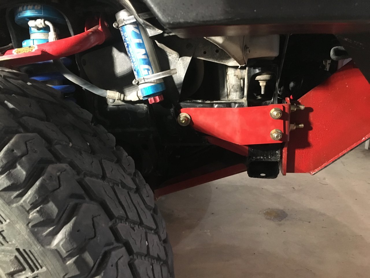

    A saliution to your bumper eating your winch line ?

    Nice!! This is definitely thinking out of a box solution, and definitely not putting a bandaid on it :thumbsup:

    Looks good James. :thumbsup:

    Cuts look good for a guy with shaky hands

    Nice job James! Looks killer. Your a quick study with fab work.

    Looks good. Before all of that fab work did you try the fairlead sandwich solution? Seems to be working pretty well for me.

    I didn’t. It probably could have been left as it was, but I wanted it a little more protected, and needed something to weld.
