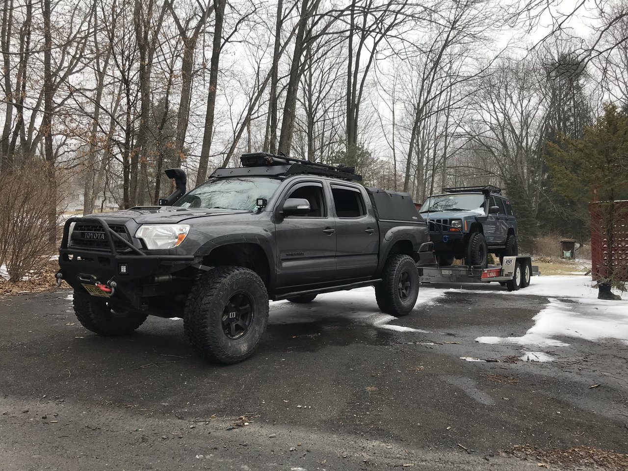

    I agree with the 6112s and 700# coils if you don’t want to go with a fully adjustable CO. You’re not SUPPOSED to run 5100s with 886s (I’ll defer to Jon’s crayon deal here). Also, the 886s are 660-680? # springs. You start hanging that kind of weight off the front, more is better.
    Good call on the LR UCAs too. Mine worked flawlessly, and the top BJ is now greasable. I wish I’d just kept mine sometimes.
    Also, do the shackle flip man! My Archive flip with B110s has a lot of travel. I doubt I’ll ever bother to do a relocate at this point. (Unless I just want a project to do)
    Dakars with the extra leaf, Archive flip, B110s. Towed this stupid Jeep Home from PA at 75 MPH. If anyone tells you that you can’t tow with a shackle flip, tell them to STFU...
    Oh, I’ve ordered from Wheelers & Headstrong. Both are good, but I like Headstrong more.
