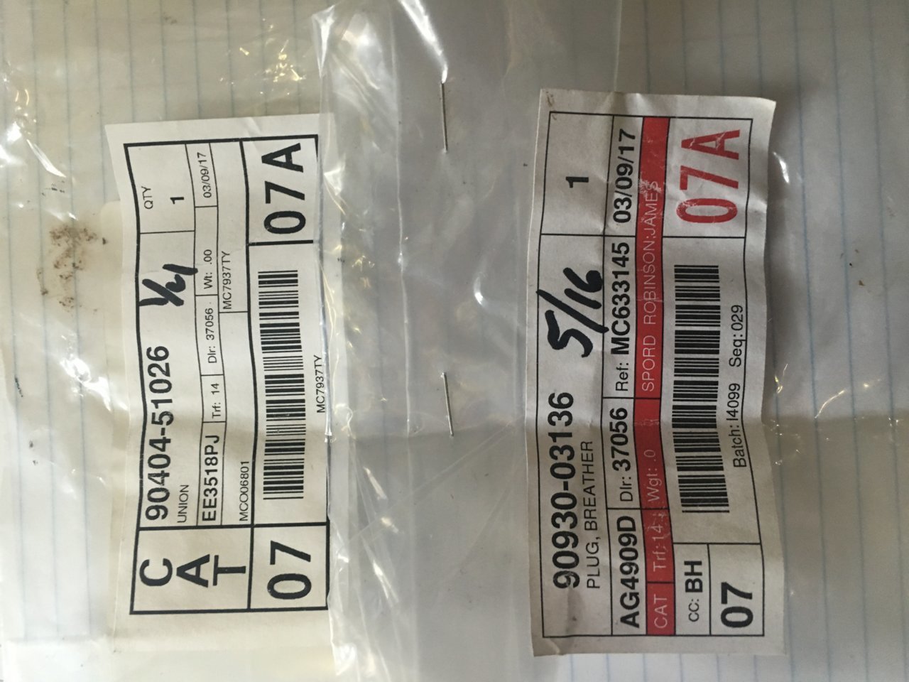

    If you have or have not done the breather diff mod leave some slack in that line also
  16. May 3, 2018 at 4:09 AM
    #156

    17 TRD OR DCSB white
    Left a bunch of slack when I did it. Thanks.

    T- man what size id. for breather line

    5/16 fuel line. I think that's ID.
    These are the parts I ended up with, because there were so many different threads that didn't spec barb size.
    I used 1/4 hose and put it behind the taillight. It was tight on the 5/16, but fit fine.
