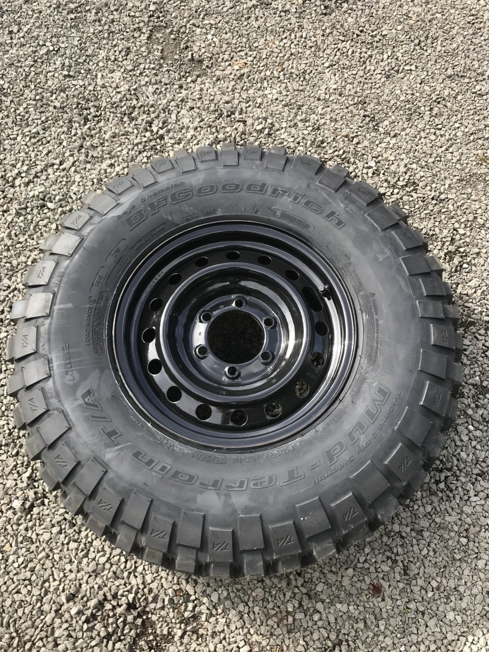

    Here you go - I did the same thing for a while. Steelie detail at the bottom of the post. What you want are first gen 16" steelies (from 01-04), not second gen steelies (which have more / too much backspacing).
    New-to-me tires and Tundra Brake Upgrade
    https://www.tacomaworld.com/threads...d-and-adventures.484602/page-10#post-16331518

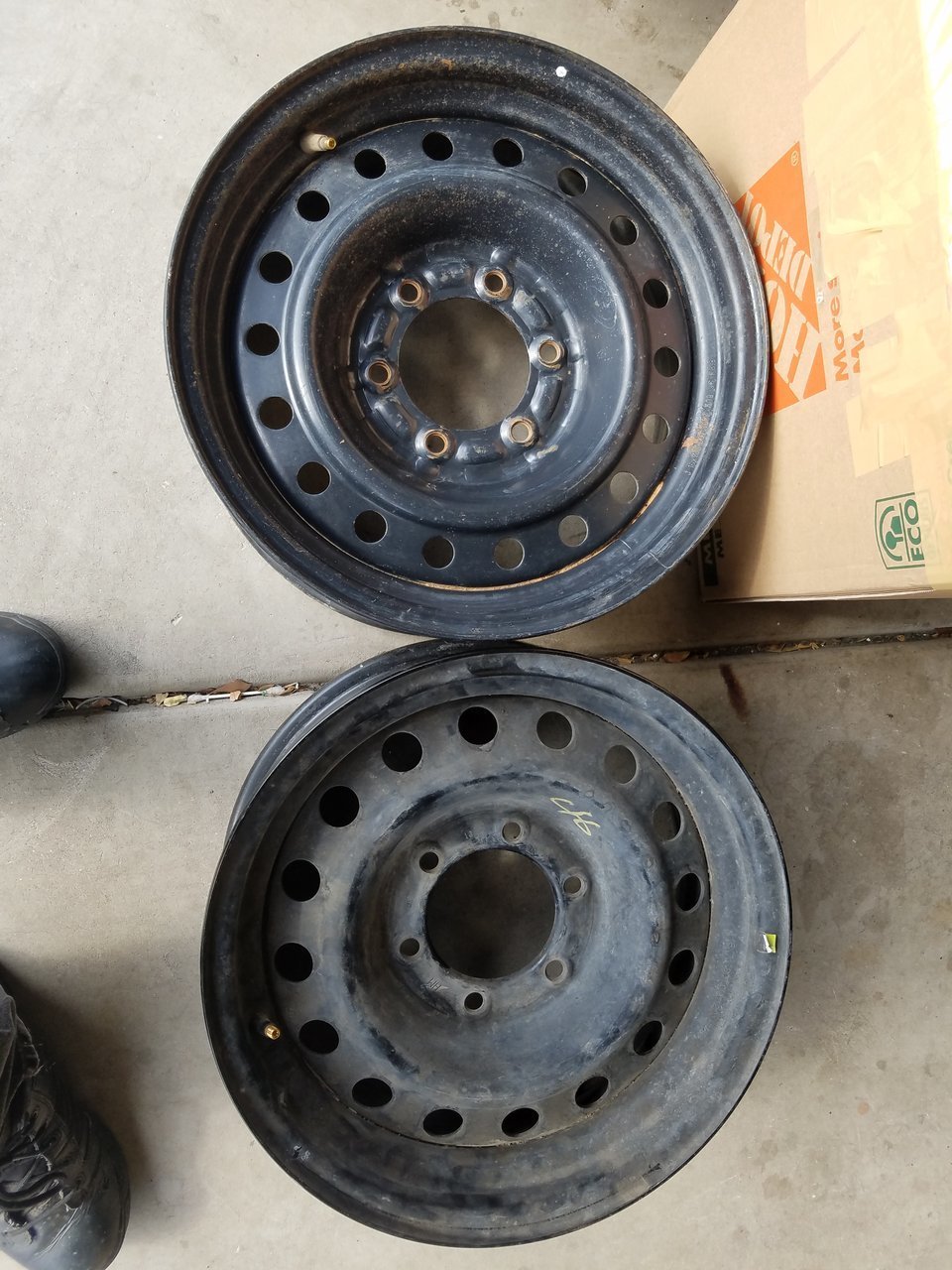

    Some also have an oval by the tire stem, like mine do. These are 16x7. Tire is BFG KM2 in 255/85/16.

    Yep, noted that in my linked post above. The ones with an oval are 2nd gen spares, and won't fit a first gen with Tundra brakes (to my knowledge) due to backspacing, which was OP's question.

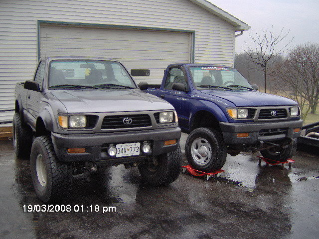

    I have a set of 01 tundra styled steel wheels (twisted star 5 spoke style) and they have a metric ton of caliper clearance with the way the spokes curve out. Here is a old pic I have of them in my gallery, I use them as rollers all the time since they clear so many different brakes. (I have them on a 99 parts truck sierra right now)

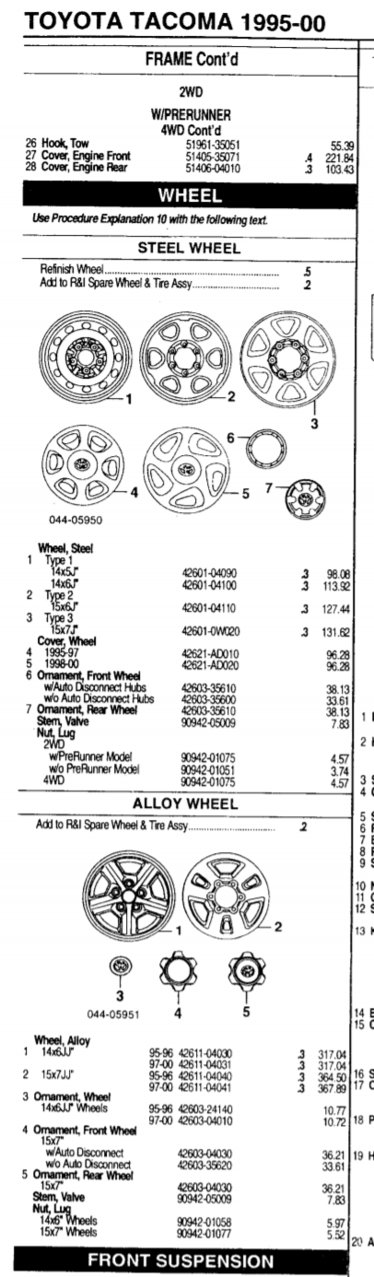

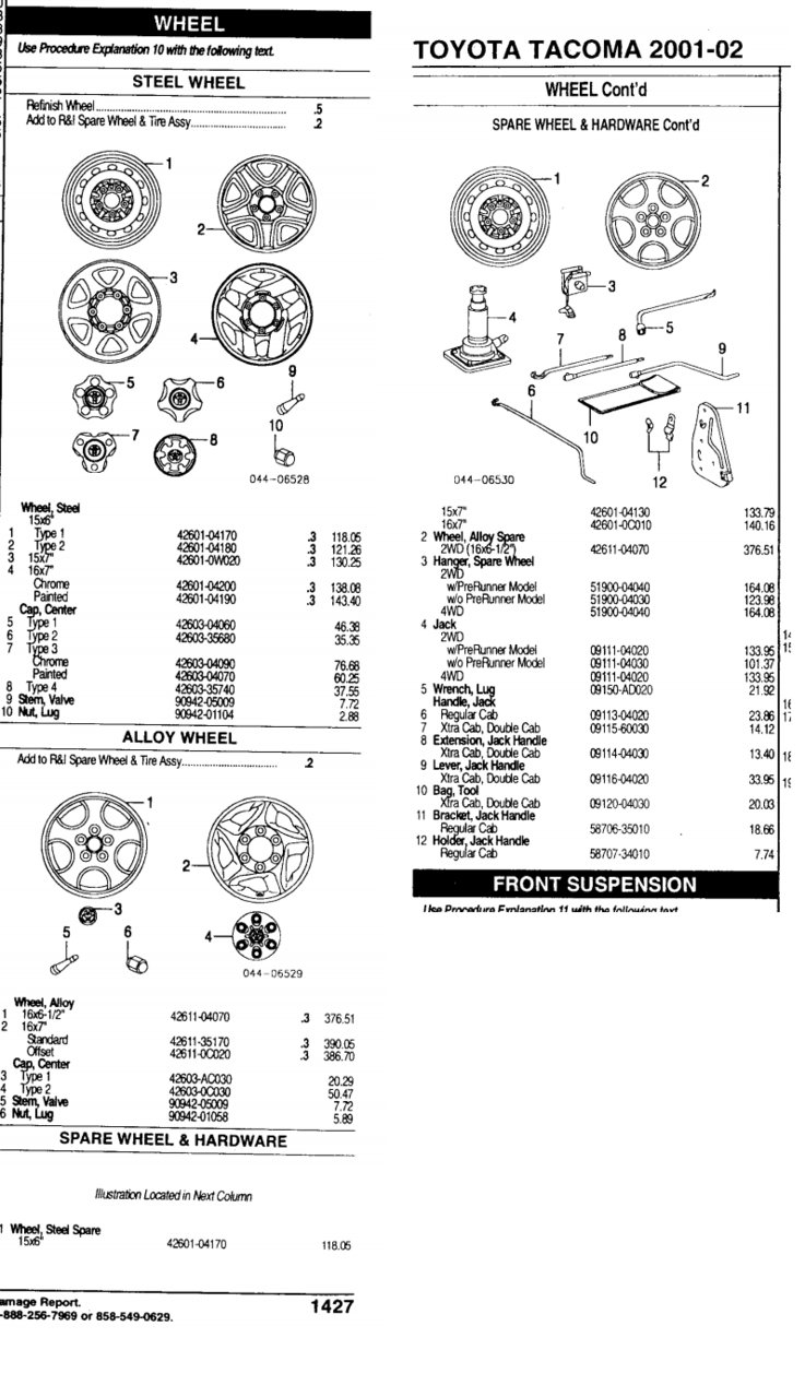

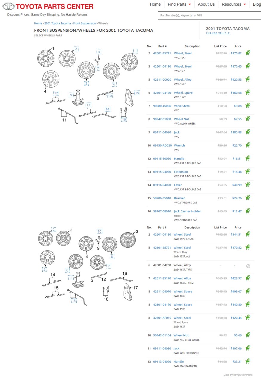

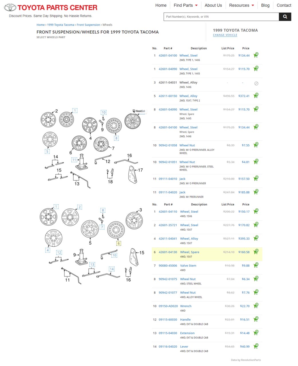

    Here's the parts list for 95-00, and here's the parts listed for wheels here (toyota parts center):
    ...still seem to me like 16" came along with the 01-04's (parts list), (toyota parts center)
