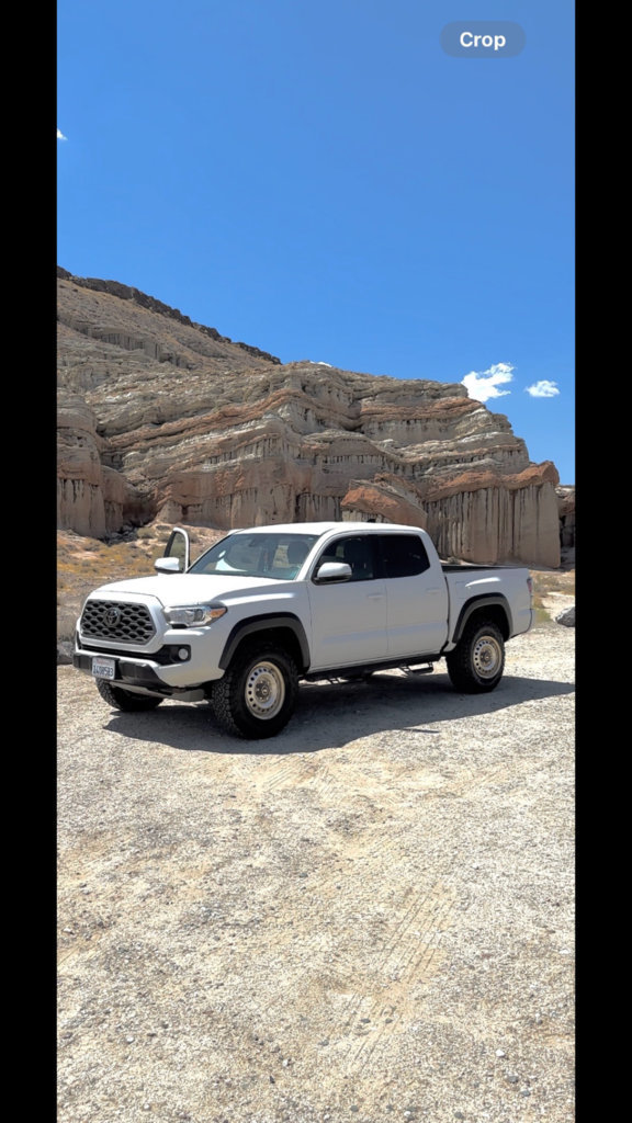

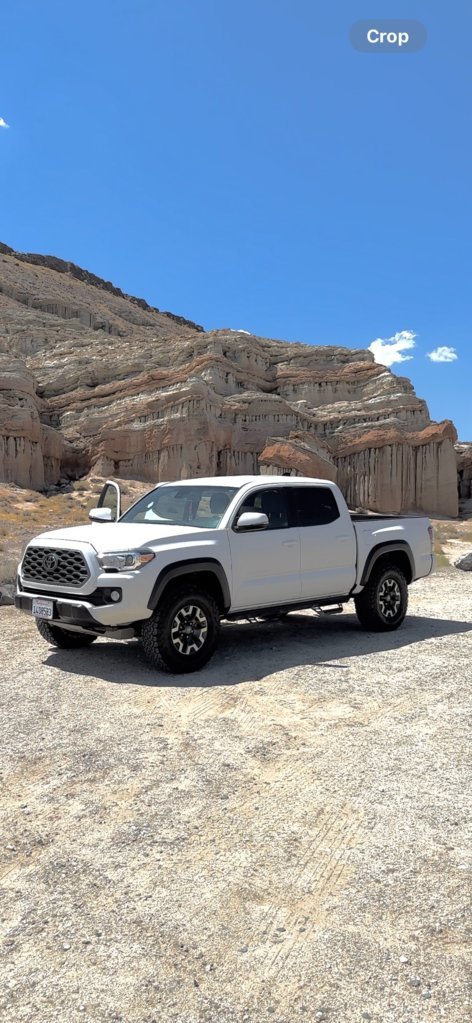

    Thinking about buying some Ford Ranger/Bronco steel wheel takeoffs. Yay or nay?

    The Ford steelies are +55mm offset so I was planning on purchasing some 1.25in spacers to bring the offset the back to around the same offset as the factory TRD off road wheels (+25mm).
    I ideally wouldn’t want to run spacers, but I also would prefer to stay at a 16” wheel. I believe the FJ steelies are 17”, but they are very appealing nonetheless
