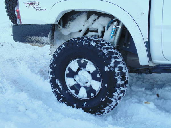

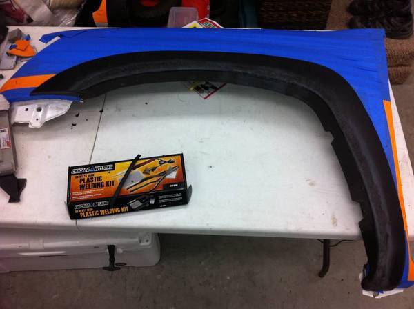

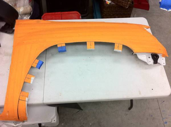

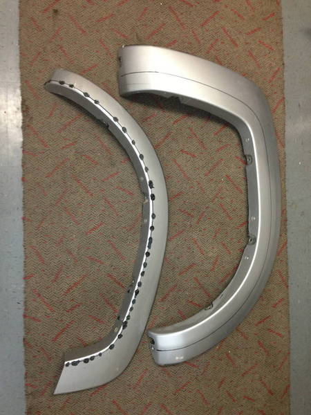

    That's crazy, especially with your 35's. Got any pictures of what you did with the fenders? Yours look factory good.

    Heres a couple of random ones.

    Whoa that looks pretty professional. How much did you take off, 1.5"?

    I took off 2.5''.

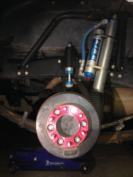

    Haha yeah i am going to run the SOA again. I never cut any of the spring mounts off so everything still bolted in. I ran the Defined kit about a year but going through the rocks it was way to low with all the camping gear and also hung up on the springs. After seeing my friends truck and a lot of others on TW with the expo leafs i felt like it was a better way to go. Looking forward to testing them out.
    The things i will have to adjust with the SOA is extend brake lines, longer limit straps, and take the 12'' 2.5s down to king to make them 14'' shocks.
    This is half Defined and half all pro expo leafs

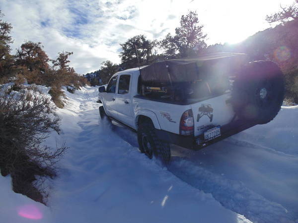

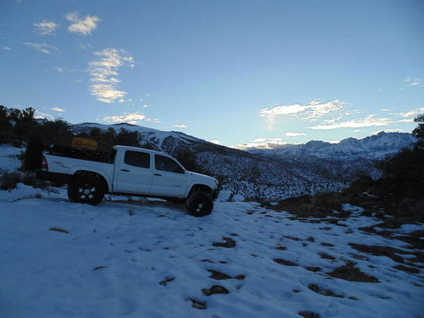

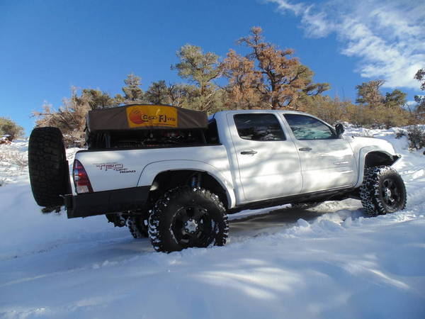

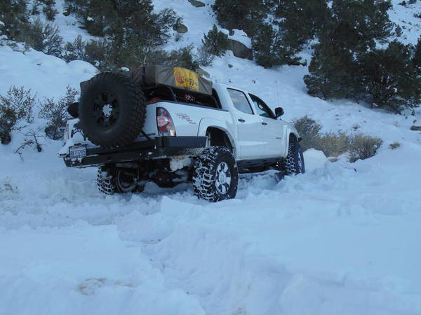

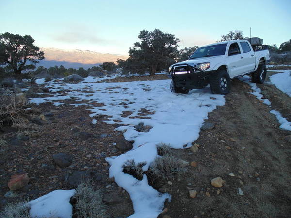

    Well finally found some time to get out. Made it up to Bishop and Mammoth. Tested out the dual battery set up and inverter with a heating blanket. Worked really good which kept the girlfriend happy.

    Niceee, looks like a good time Cody. You liking your expos? about how much weight you have in the back in those pics?

    yeah the heating blanket worked great. We were the only ones in the camp ground sleeping in a tent. We went to sleep around 8pm and it was 25 degrees. I really dont know how low it got but it was pretty cold. Saturday we went to Lake Isabella and right before sun set we ran into a couple stuck in a 2wd tacoma so i had to help. I will say it was pretty fun pulling them out and i know they had a good ride because a couple of times both of our trucks were sideway. But over all a really good time.
    So i think i am going back to spring under with a shackle flip kit. I really dont know exactly how much weight i had in the back but my guess would be around 500-700 hundred pounds. With the wrap around bumper, spare tire off the back,5 gallons of gas,Ice Chest, tent, rack, shovel,axe,tools,spare axle, spare hub,oil,radiator fluid,wood,chains,water,and whatever else i forgot. It was just my girlfriend me and the dog so i try to carry everything. Also have are front runner roof rack coming in tomorrow to get some more stuff out of the cab.
