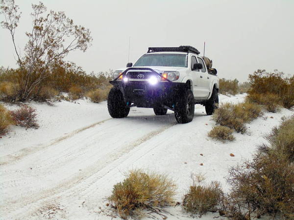

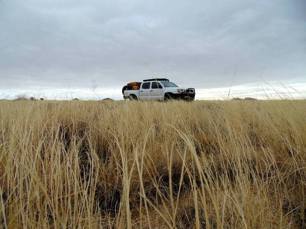

  9. Dec 8, 2013 at 10:35 PM
    #49
    STEELTACO
    STEELTACO [OP] Well-Known Member
    Nov 29, 2011
    #67912
    220
    CODY
    WHITTIER, CA
    07 4X4 TACOMA
    Total Chaos 2'' Long travel, King shocks, ATO Rear Bumper, Custom Sliders, K&N Air Intake, URD Y Pipe, etc.
    Mojave Trail
  10. Dec 8, 2013 at 11:00 PM
    #50
    VanCity4x
    VanCity4x Well-Known Member
    Aug 1, 2011
    #60970
    1,411
    AB
    05 Tacoma
    3link on tons
    Sick truck :drool:
  11. Dec 9, 2013 at 7:22 AM
    #51
    NYCO
    NYCO go explore...
    Jul 27, 2010
    #40842
    19,121
    bOb
    Colorado
    Blue Betty - '06 TRD OR
    dents & scratches
    bet you had fun on that run :burnrubber:
