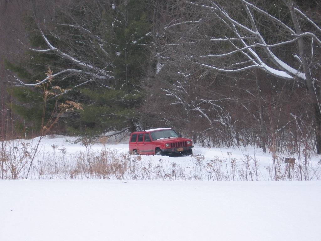

    *** Adding a note here - Sometimes engine compression braking (low range, 1st gear) isn't enough. I had a gear reduction t-case in one of the rigs I did a 180° and then a backwards slide. I literally could walk twice as fast or better as it idled along. Still no joy and no control on steep hill with ice. I used to call my driveway "the luge run". I had to be very careful in picking a line. Definitely no brakes (nothing more than a light drag)......

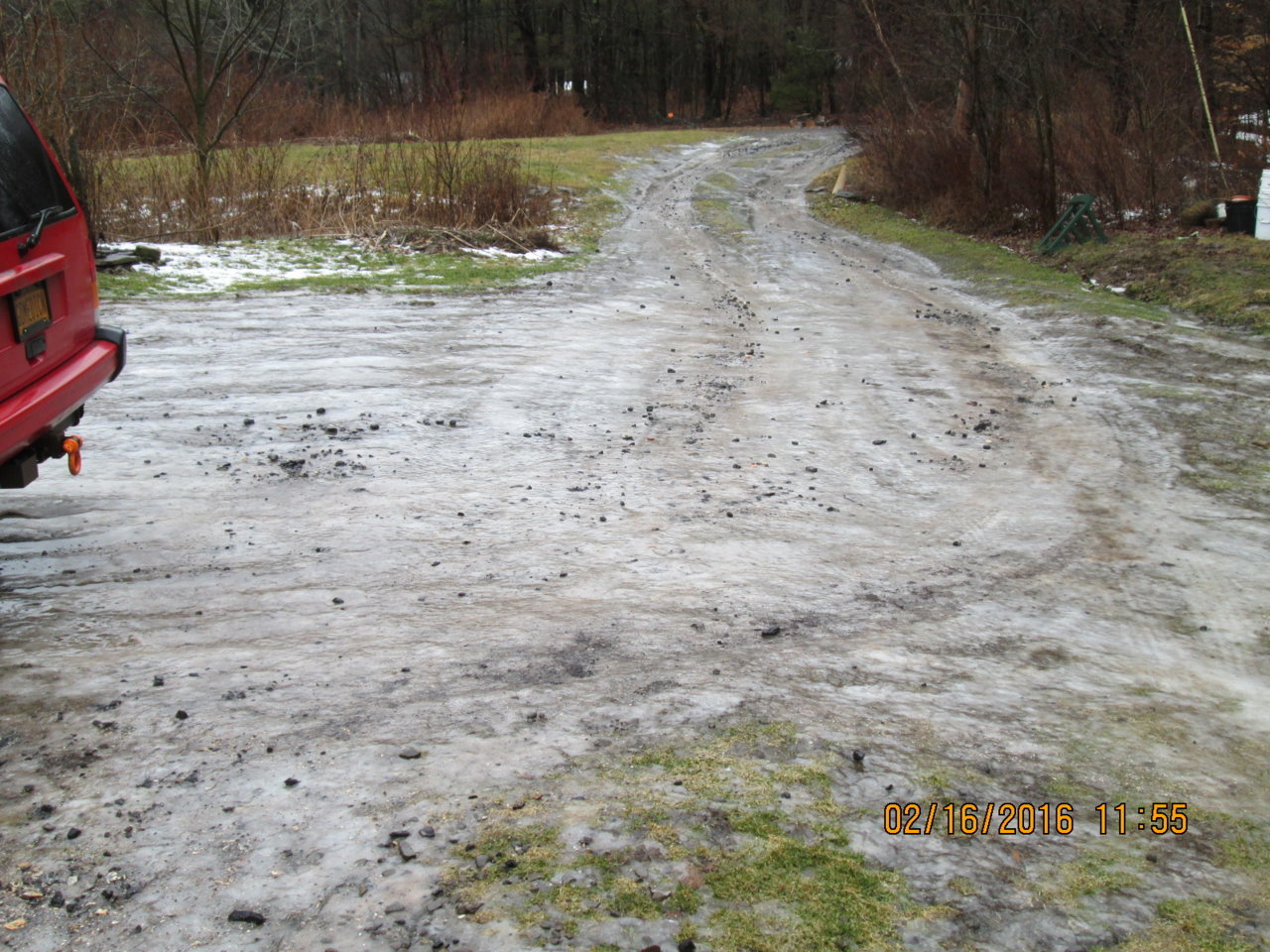

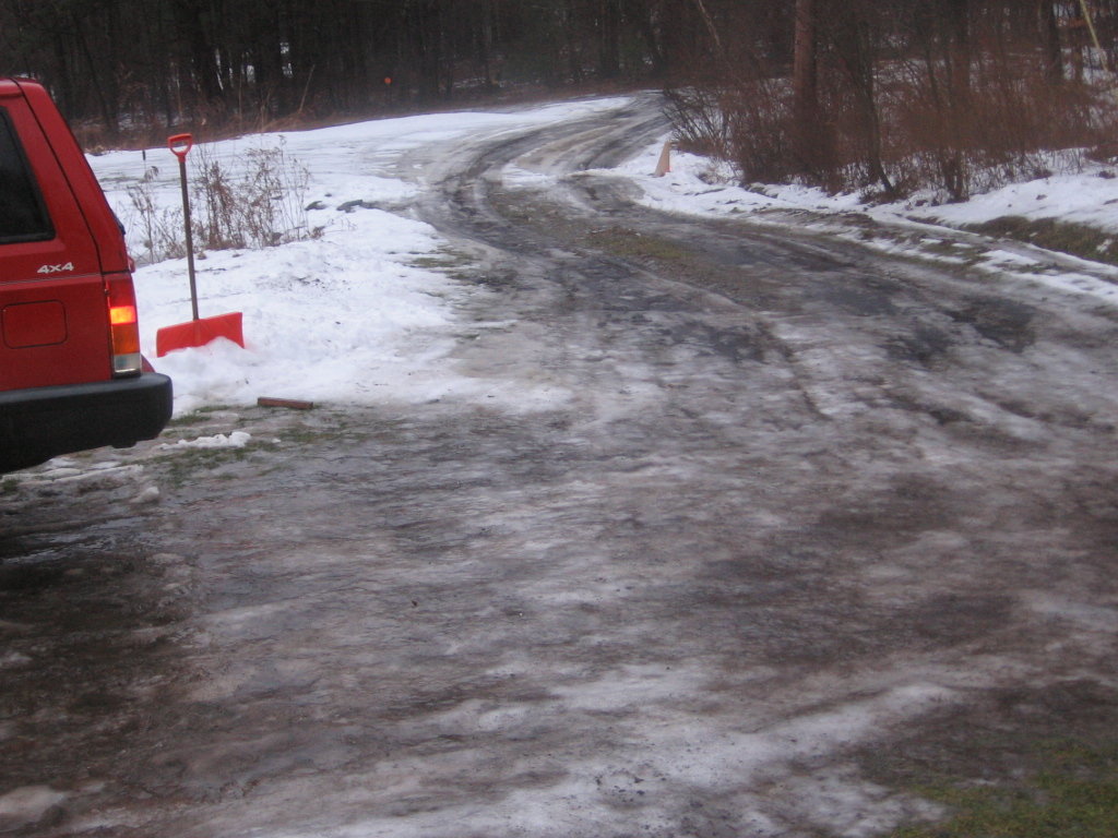

    It's still a dicey situation. Often times when there's a significant snow or has been, keeping tires on the "unmolested" ditch side can be treacherous where the ditch isn't clearly defined and you can dump into the ditch.
    Regarding icy driveways, going up is usually easier to negotiate if you pick a good line and have the correct speed. Going down, when you get a serious case of gravity and have zero traction is where it can be uncontrolled.....
