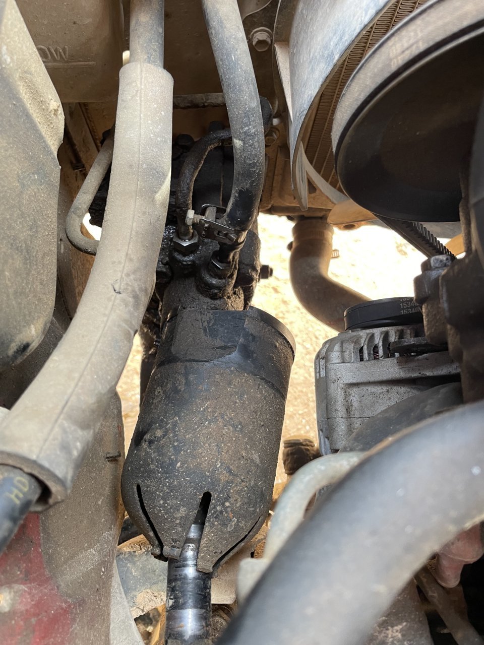

    IMG_3462.jpg The left line is leaking and the nut is tight. What will i habe to do to stop the leak? Can i apply something to the threads? Im assuming the cover in photo fits over the knuckle

    Whats happened is you've damaged your double flare crimp on the end of the line..
    usually that happens because the tube end wasn't absolutely square when that nut/bushing was cinched down...
    and thats the high side to boot...

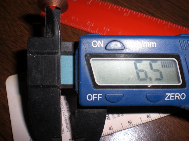

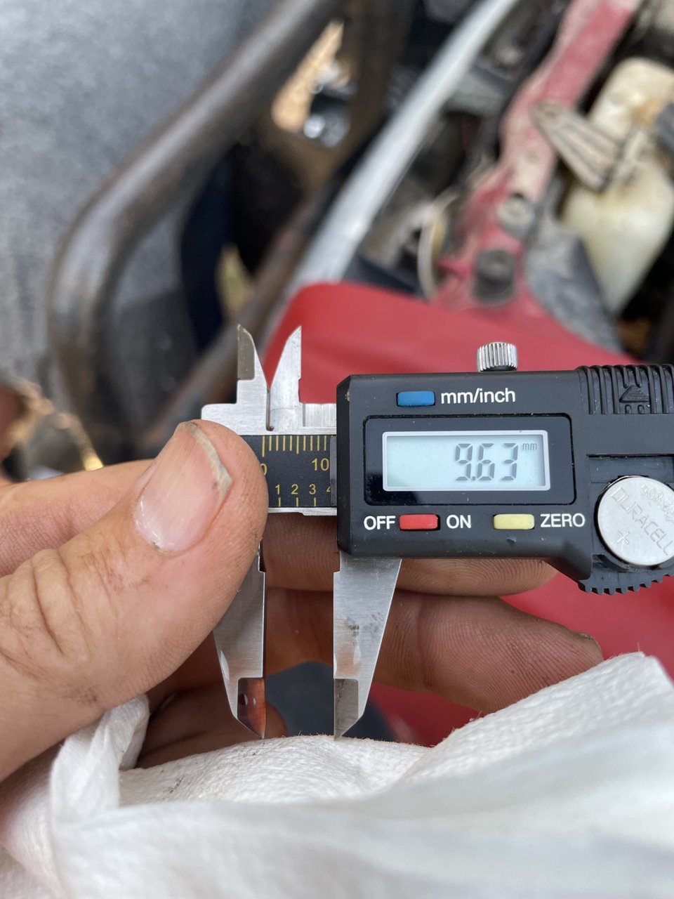

    you think the #10 copper seal will work? Thats the measurement of the line before the nut.

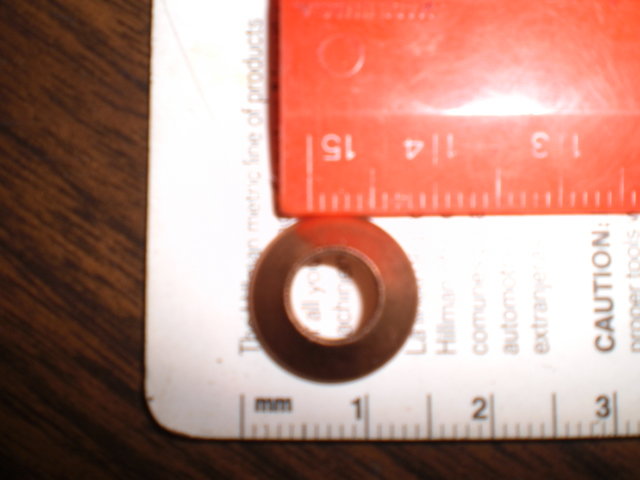

    Your washer opening has to be slightly smaller than the orifice size??
    Here's the the #8's that work for the fuel lines....

    Thanks for your input. Now the plastic shroud. Does anyone know what holds that in place. I see a bracket but have no idea how the shroud connects to the bracket. Thanks in advance.

    That plastic guard is there.....I imagine is because there's a rooster tail of water coming off each side of your front tires when you drive thru deep water.....
    If that was mine I'd be tempted to get a zippered cv replacement boot/double clamps.....and get rid of that...

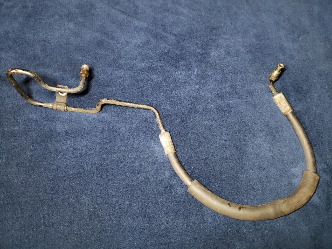

    From the looks of that line I would just make a new one.

    I took the air cleaner box and radiator overflow jug out and put a new high pressure hose in from Napa. It was a 50 dollar hose but still leakkng a little around the threads of nut. Is there something i can use on nut threads to help seal them?
