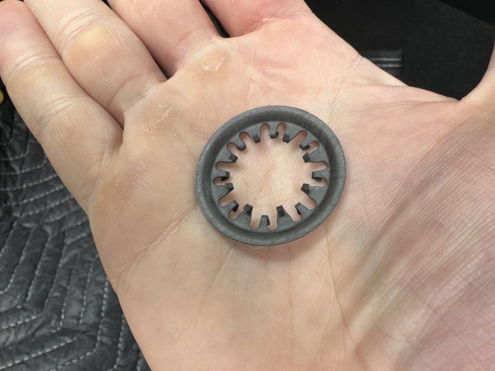

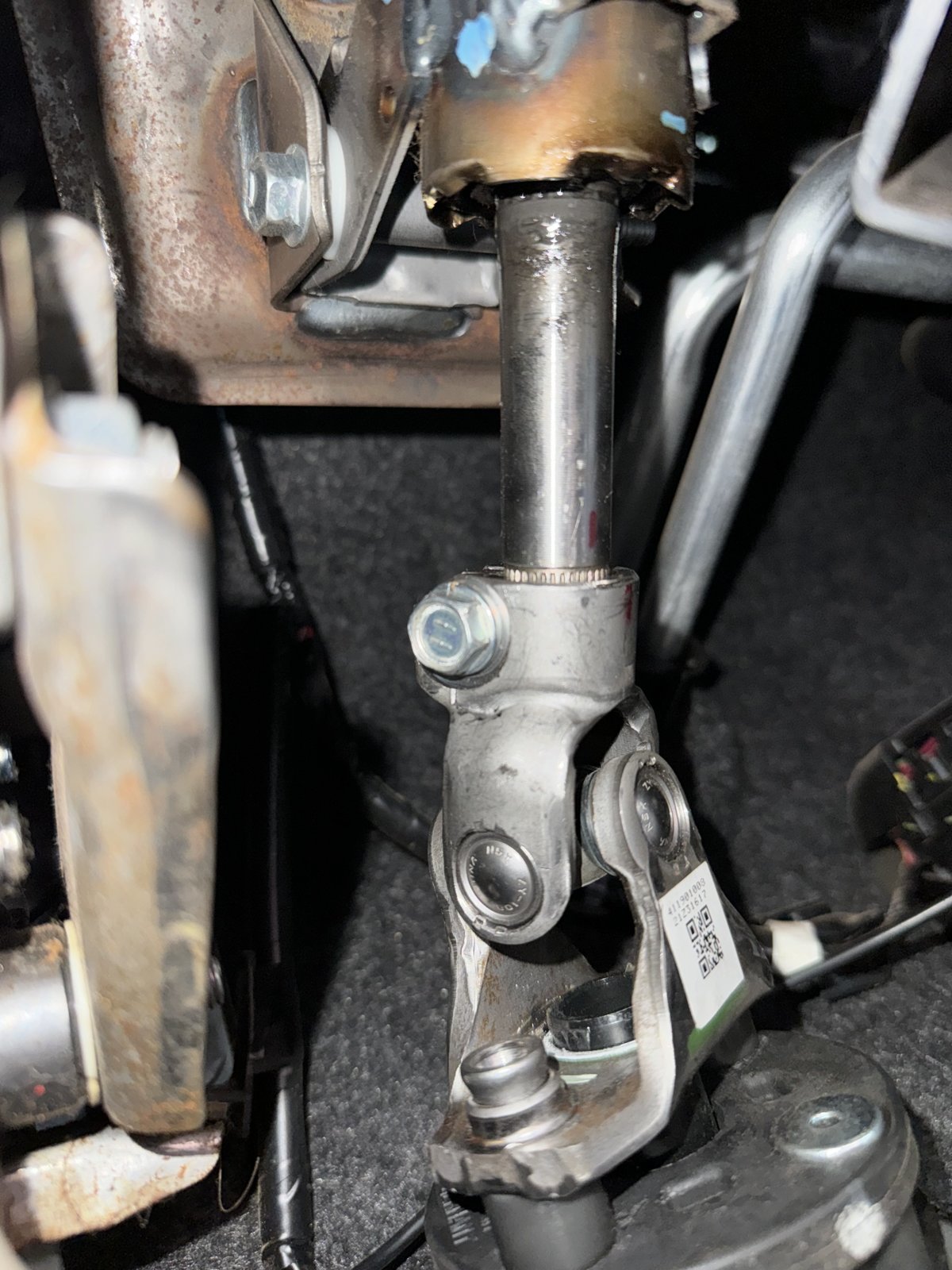

    Parts arrived today! Unfortunately it’s pretty difficult to get decent photos under the column, but the fix wasn’t bad to do.
    14mm wrench
    Sharpie
    Bungie cord to tie the steering wheel.
    Mark where the steering shaft in the photo above stabs into the intermediate steering shaft so you can keep the wheel straight when you reassemble everything.
    Tie off the steering wheel so it won’t free rotate when disconnected.
    Remove the clamping bolt and slide the shaft up into the column, out of the intermediate shaft connector, but be sure you don’t shove it up all the way to where it’s difficult to grab.
    Find your ring. See the radius leading to the outer flange and how it’s sitting in my hand? The side that is currently “up” will be facing out from the sliding shaft and pointing toward the intermediate shaft. The photo I quoted above also shows the correct orientation.
    It’ll be loose on the shaft and that’s okay for now.
    Extend the sliding shaft and reconnect it to the intermediate shaft. Be sure your witness marks line up and the steering wheel is straight or however it was pointed when disconnected.
    With the shaft reconnected, start trying to slide the ring up and on to the slightly larger shaft OD. I was able to use my 14mm wrench on the bolt to help the shaft slide out just enough to get the ring seated.
    Took it for a test drive and it seemed better… we’ll see!
    winkel, 4WDTrout and illjimae like this.

    My silly plastic shim wore out after about a year and my rattle came back so I wanted to come back to this thread and give a shoutout to OP for his pictures and instructions on the proper fix for this issue.
    Once I got it apart it all made sense, the shaft coming down from the steering wheel/column is tapered and can slide up and down, held in place (extension wise) with the serrated ring thing-so mine was pushed so far up that it had enough room to wiggle inside the bearing/housing?, and the indent for the retaining ring was nowhere to be seen.
    When extended to the proper length and the clip on there was no more wiggle and rattle in the column, but I discovered it was a good 1/2-3/4" too long to connect to the joint to the upper intermediate shaft... leading me to look at the other end where it connects to the lower intermediate shaft before the rack, which I found was barely engaged more than 1/4" into the clamp.... Apparently the shop that replaced this shaft before I bought the truck (PO told me it had been replaced but it was rattling when I bought it) couldn't get the shaft to slide into the clamp enough so they just slid the shaft up into the steering column instead to make the lengths match up.
    Pretty sketchy to find considering it holds the steering splines together, so I unbolted and opened up the clamp and slid the upper intermediate shaft down more to get the proper engagement, and then was able to connect the upper end to the steering column without it being too long. Of course the lower clamp bolt snapped when torqueing it, so I had to extract that and find a new one, but hey after its all said and done the rattle is gone! My match marks look to line up but my wheel is a bit crooked now and the VSC/TC/ABS stuff was freaking out and threw errors so I assume I must have rotated the wheels and ended up 360 degrees off maybe? I didn't think being off by one spline would be enough to upset the steering angle sensor but I'll try and realign and then if needed recalibrate it tonight after work.
    Hopefully my unique situation might help someone down the road lol
