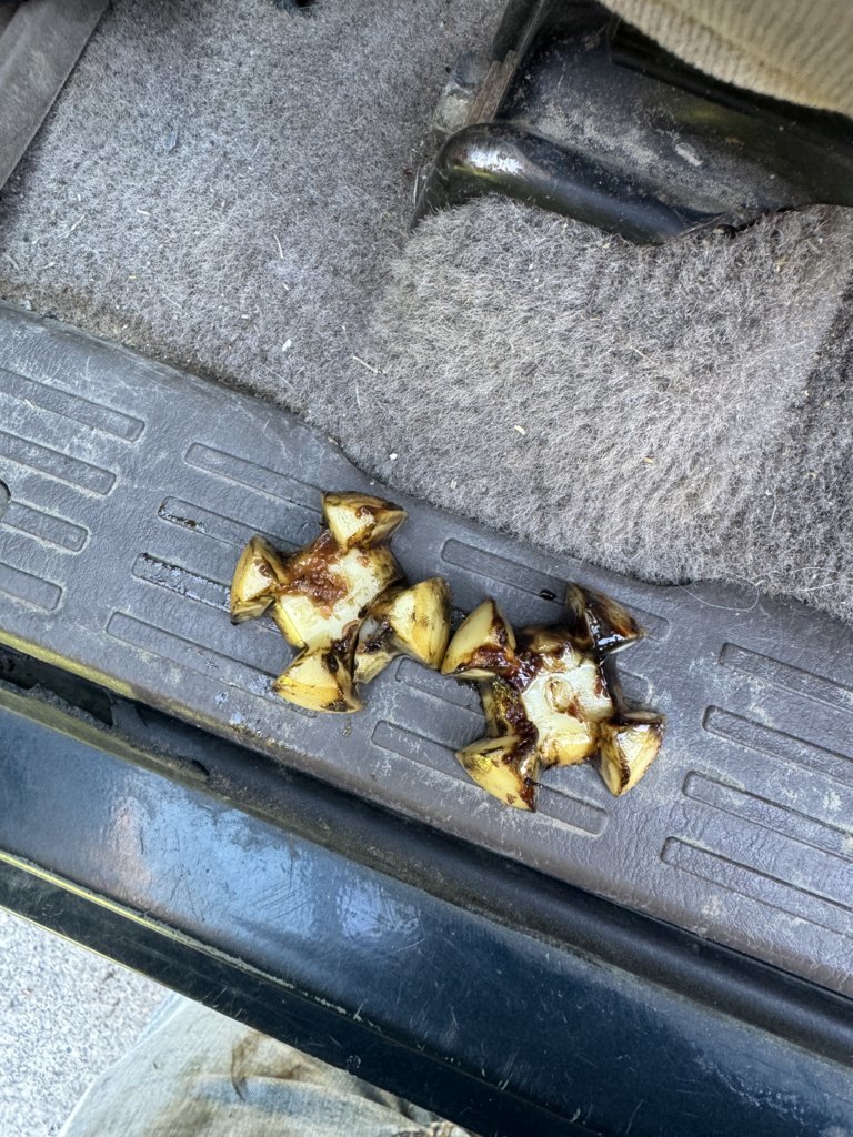

    Trying to figure out what the heck these bushings are called. One of them broke. Came out of the main steering shaft just after the tilt mechanism. Can try to find more pictures online if it helps. I would like to try to find new bushings rather than buy a whole new main steering shaft if at all possible.IMG_6888.jpg

    Take a look here:

    Thank you @Parkvisitor. That led me in the right direction. I found what I need

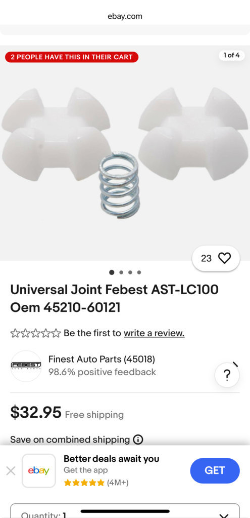

    Posting in case people in the future need this. From what I found this part will work. I will update once I get it and install it.
    Universal Joint Febest AST-LC100 Oem 45210-60121
