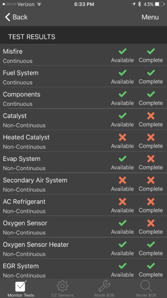

    Indeed. Simplest solution first. And no, using the same station Citgo Top Tier midgrade. No changes in fuel type. When I had these issue some before I did the last reset I had experimented with 87, 89, 93, and 87E0 and somewhat felt like perhaps I confused the ECU (unlikely but...). I committed to put nothing but mid grade in it bc that seemed to be the best balance of cost and (at the time) I hadn't no slight miss feelings nor cricket chirps. All of which have returned using the same fuel...

    Potentially... I've seen this test result before but it goes away and only shows up with a fail intermittently and no codes have ever been thrown so I'm pretty sure I take it to a dealer and they say "normal"

    Constant with the same Citgo gas station? If so, go somewhere else, try Costco, Sam's, Kroger. Run to pretty much empty then fill up. Drive a few days and see how it goes.
    If you keep getting the misfires on 1&2 with rotten egg smell. Take those logs to dealer. Consistent misfires are either bad plugs or coil packs, presumably.

    Octane should have no bearing on the issues you are describing. No reason to go mid tier or premium on these trucks unless you have changed the ignition timing by chipping or remapping the ECU.
    How many total miles does this truck have? As stated above, coil packs and different fuel are an obvious and relatively inexpensive item to rule out straightaway.
    If that doesn't fix the problem, I am inclined to think based on what you have said above, that you are on the right track with a sensor failure. I have seen faulty MAFs cause this problem in other cars. The sensor sends intake air density readings to the ECU which then calculates how much fuel to provide as well as adjust timing based on other parameters. Excess fuel can foul plugs, leading to misfires and also ruin your catalytic converter.

    Swap the coils to see if your misfire moves to the new cylinders. Id pull your plugs as well to see if you are rich.

    No CEL doesn't mean no codes. It means no major codes. I bet you can get some info if you pull your codes.
