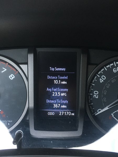

    So I went ahead and replaced my oiled trd filter with oem paper, cleaned MAF, and reset short term learning yesterday. The engine air intake box was a little dirtier than I expected. I cleaned everything really well, let it sit for about 45 minutes and then reinstalled.
    First impressions yesterday were not as great as I had hoped for. Subjectively the truck started way smoother, but then immediately felt the buzzing during idle. Anyway despite an improved throttle response around town, I was getting like 13-14 mpg yesterday for about 15 miles of driving.
    Drove about another 25 miles today only to have things improve. Vibes have gotten much much less noticeable. Was getting pretty poor gas mileage again this morning, like 17 highway, but felt the truck adapting and smoothing out.
    And then the last leg of my trip was 10 miles back to the house, almost got my PB fuel economy. Ill give it a week to settle in and report back.
