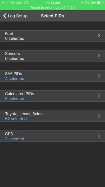

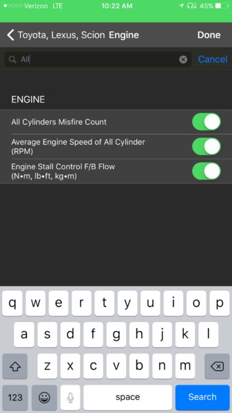

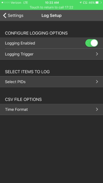

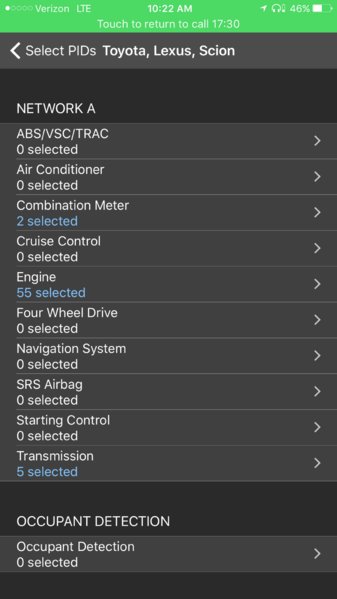

    1. Under Settings, hit Log Setup to access this screen
    2. Select Toyota,Lexus,Scion
    3. Select Engine
    4. Use search to see All Cylinder misfire (or search misfire and add each cylinder individually in addition to the All Cylinder). Sometimes I see an all cylinder misfire recorded but with no 1's next to any cylinders. other times it does capture them.
    Interested to see the results, but I'm honestly beginning to think this may have been designed to operate guard-rail to guard-rail a bit. Run it lean / rich until it misfires then recorrect? Ha! But the fact that he FSM says up to 35 misfires on a single cylinder in a 200 revolution range is NORMAL perplexes me..... I'm no engineer, but aren't misfires a bad thing? :)

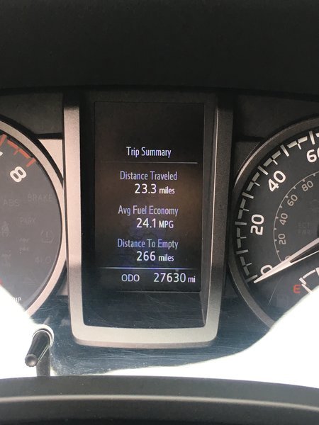

    Here's my latest from today.... Truck is continuing to drive pretty well overall with solid acceleration, no bogging at all really (I'm driving primarily in S5+ECT) and steering continues to feel "easy" - not clear of annoying vibes by any means, but it's still holding steady. What's still odd to me are the misfires and I do indeed feel something with the high pressure fuel pump which I know they refuse to replace any longer could 'potentially' cause this? I graphed by misfires from today's commute home - there were several as you can see in the data. I did feel the "slight miss" feeling once, but otherwise didn't "feel" them but the sensors clearly picked it up and even had a misfire (at least one) recorded across 5 of 6 cylinders.
    When I graphed it against a few different data points, the only somewhat clear correlation I could definitely see was regarding the fuel pressure. Rather than feeling a misfire on acceleration, what this data indicates to me is that the misfire occurs just AFTER I've accelerated and just after the high pressure fuel pump goes from a high condition to a lower pressure - and in traffic, often quickly decelerated to a near stop.
    Perplexing but I am inclined to see if I can get my historically "zero help" dealer to look at the fuel pump. Any tips on that would be welcome... specific language to use to actually get them to test it? Sounds like they are just dismissing any fuel pump issues these days after replacing several for the cricket chirping in the good ole' days....
