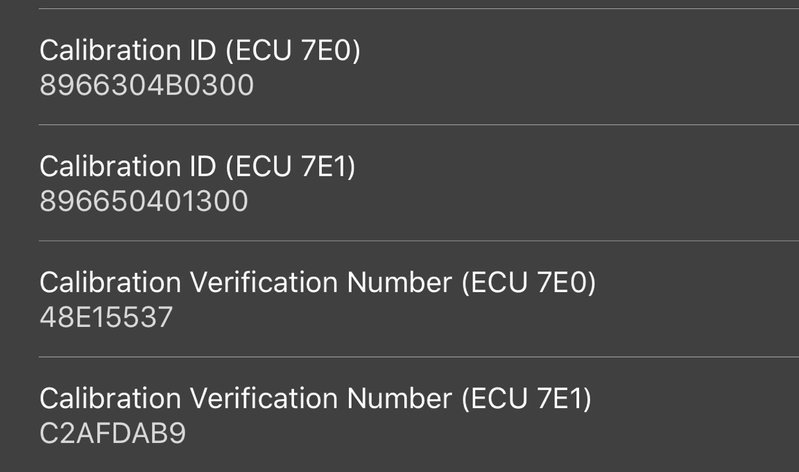

    I am glad that worked! I just caught up on this thread tonight. I haven't been on here for several weeks.
    I feel very fortunate to have a well running truck. I got 24 mpg on my way to work tonight. 14,000 miles.
    What is the calibration ID on your ECU? I think your Carista will show it to you. The newest one ends in 300.
    The misfires on decel are very interesting. The ECU should be turning off the injectors so there shouldn't be any fuel in the cylinder at all.

    Yes it shows it in Fusion or Carista, will take a look tomorrow. Assume you do have the vibes as well even with your well running truck?

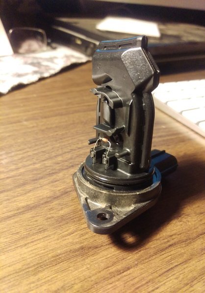

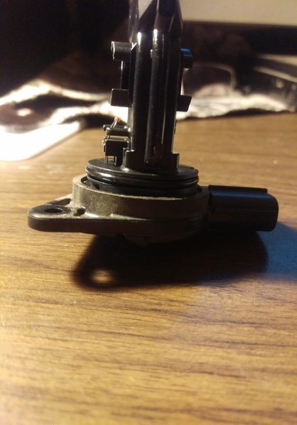

    Im guessing that this diode/thermistor was bent back since the beginning....
    One thing that I do notice is that this thing looks really greasy. Maybe cleaning the grease/oil film is cleaning the sensor all together and getting a true reading.

    yes, mine was bent back like that as well so I can only assume it's intentional in the design. but yes, some muck on there for sure - perhaps assembly oil but who knows.
    When I was sitting in traffic at idle a few weeks ago and saw my MAF showing an air flow on par with what you'd see at WOT acceleration I knew I had to do something - and this was the easy fix for THAT problem. :)

    Yes. Mine is angled like that too, no need to frig with it lol.
    Did you spray the cleaner inside this badboy too?
    Ref your first (left hand) pic, I put the straw in the narrow end of the sensor tube and angled it about 45 deg downward. Sprayed until cleaner ran out the narrow slits located about halfway down the sensor.

    YES. I sprayed the hell out of every crevice and tube on this thing multiple times just to be sure!

    Thanks @MOC221_ and @bshammer0.
    I thought for a second that I have possibly bent it while I was taking it out.
    I gave it a good get with CRC Mass Air Flow Cleaner.
    This isn't the first MAF sensor that I clean. This however,
    is the first time I clean it on this truck.

    Checked this today, and based on what you indicated it would appear I have the latest calibration ID. Can anyone confirm?FullSizeRender.jpg-2.jpg

    That is what I got with the last flash. I don't have any vibrations or differential howl. I don't even have squeaky leaf springs but I do keep them lubricated with fluid film and I retorqued the entire driveline myself.
