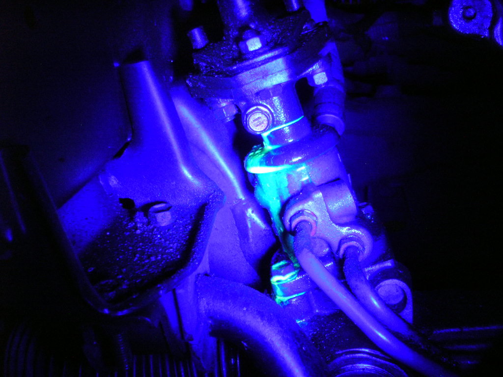

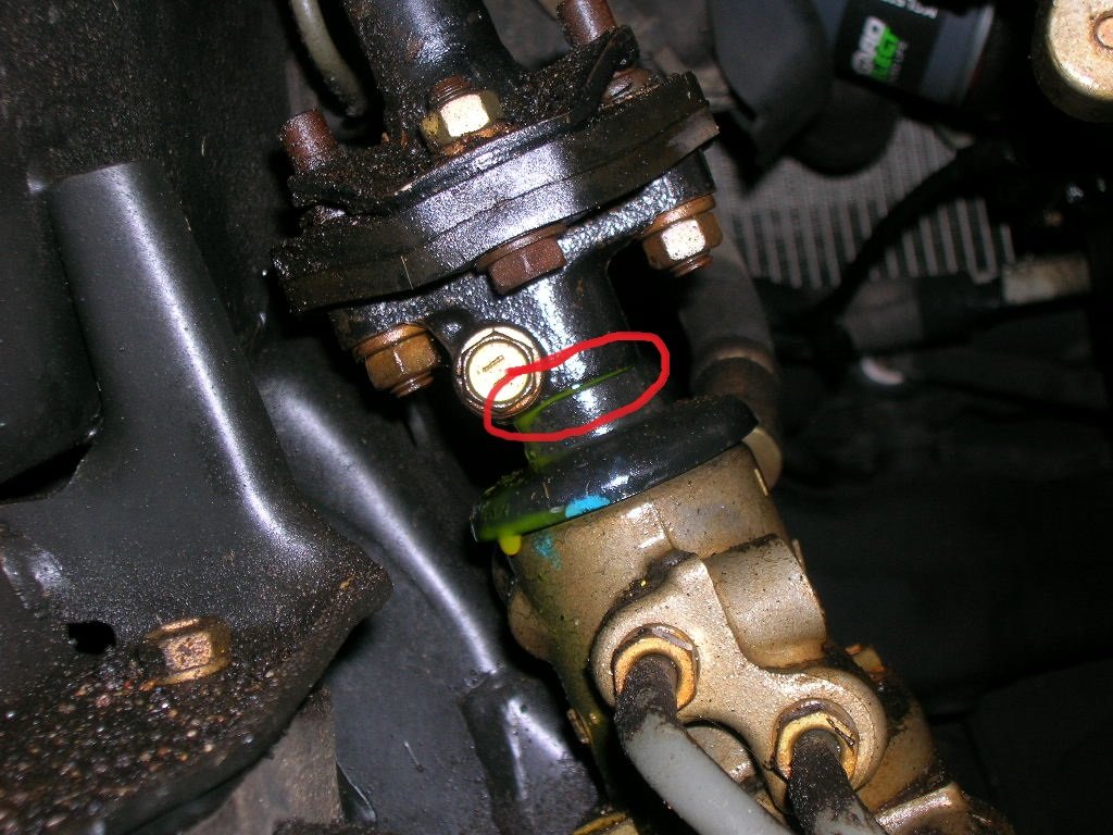

    I used a dye, it worked great. I already had a UV flashlight, I used to look for scorpions with it. I bought my 1999 Prerunner brand new, still runs great but as expected, it's starting to get leaks here and there now. I just had the valve cover gaskets replaced for the first time, not bad at 250K. I'm not sure "exactly" what I need to fix here though. I assume it's a gasket, but where exactly is it and is it hard to replace? I looked around on Ytube but not sure what to type in exactly.
    doodoo, I finally found the answer in another thread. https://www.tacomaworld.com/threads/help-power-steering-fluid-leak-from-rack.512790/
